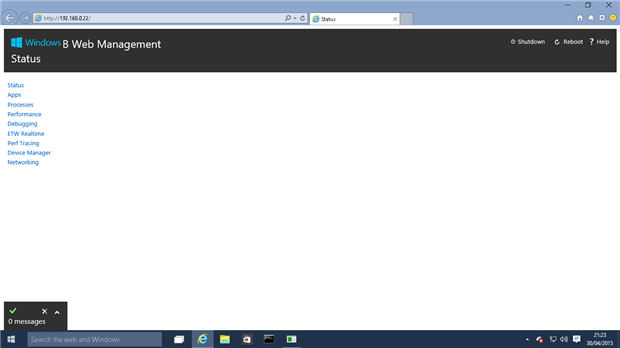

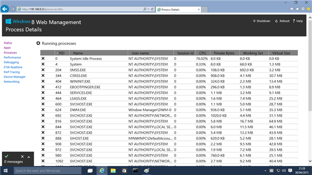

The Pi 2 hosts a web server where you can see the processes and other details as in the screenshots below:
{gallery} Windows 10 IoT Core on the Raspberry Pi 2
Default page: Shows when you open the IP address

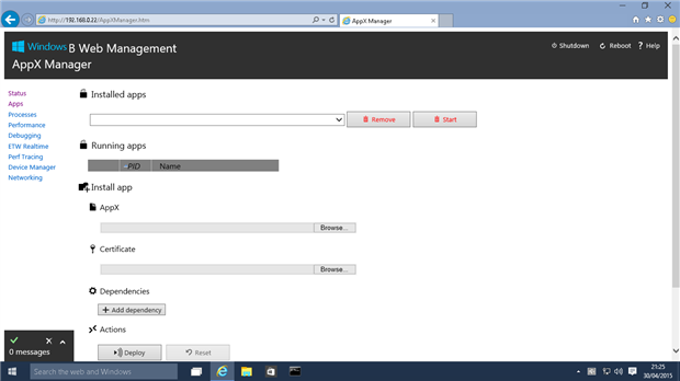

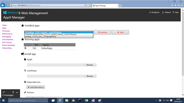

Apps: Shows the IoT / Universal Apps you've installed on the Pi 2

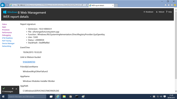

Crash: The debugger reported that TIWorker.exe had crashed. Stay classy Dev' Edition.

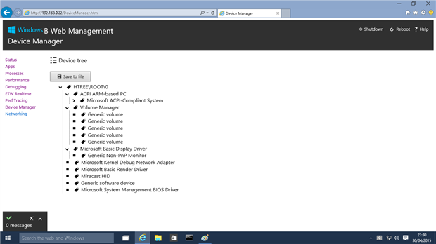

Device Manager: This mainly shows that a lot of drivers are just default at the moment, note no VideoCore driver

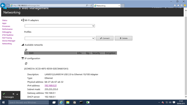

Networking: Yep, you need a wired connection before you can setup WiFi
Processes: This is effectively the 'Task Manager' of the Pi 2

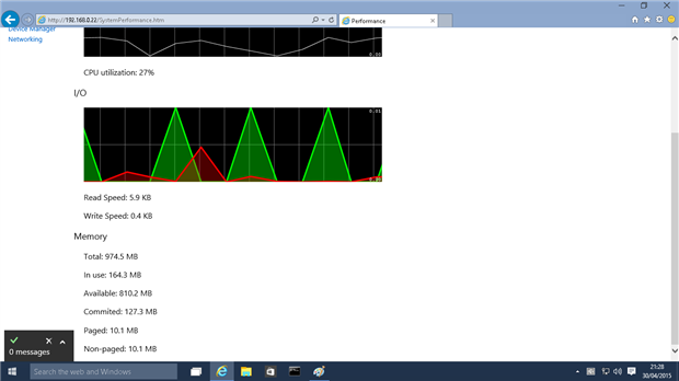

System Performance: The Pi 2 allocates a low amount of RAM to the GPU 164.3mb is all Windows

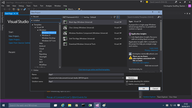

Now that I was able to connect and see it on the network, I then made sure I had Visual Studio 2015 Professional Edition RC installed (you may also need the development tools). If you go to download Visual Studio 2015 it'll try to push you towards the Community or Enterprise editions. It's probably the Professional one you want, if you scroll down the page , click 'Visual Studio 2015' on the left and you can find the Professional Edition. Apparently you can use the Community Edition, but the 'IoT watcher' which broadcasts on the network to see what devices you have, may not install.
Visual Studio 2015 is ridiculously easy to just test to upload an application to the Pi 2, and with Visual Studio you get the support and guidance of the programming language, the IDE (integrated development environment) that helps you with the code and the debugging functionality. Debugging, I've found, is something that is tedious and awkward in most programming languages and something that usually isn't covered on guides when learning to program.

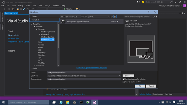

The screenshots below show the steps I took when putting code onto the Pi 2 (mouse over the gallery for captions):

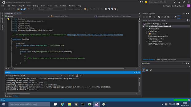

{gallery} Test IoT App Pi 2
New Project: Decided to create a 'Windows IoT Core' background app
Choices, Choises: I think you can also deploy a 'Windows Universal' app, but I didn't choose it

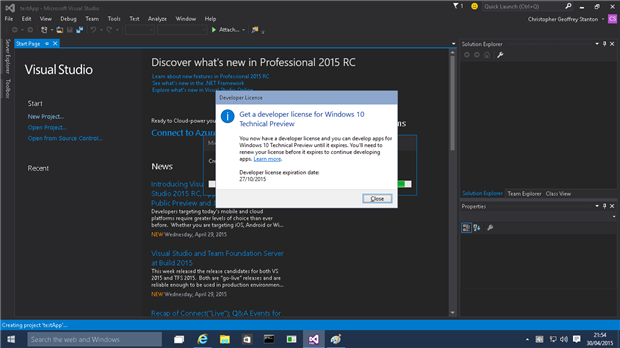

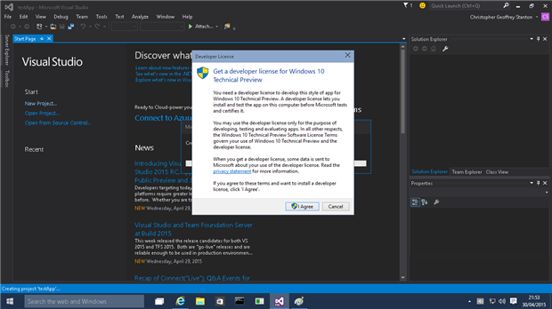

Developer License: For Windows IoT Core apps you need a dev' license for the tech' preview
Dev License: It's fine, it's free, but it has to be renewed every 30 days (90 for AppStore development)

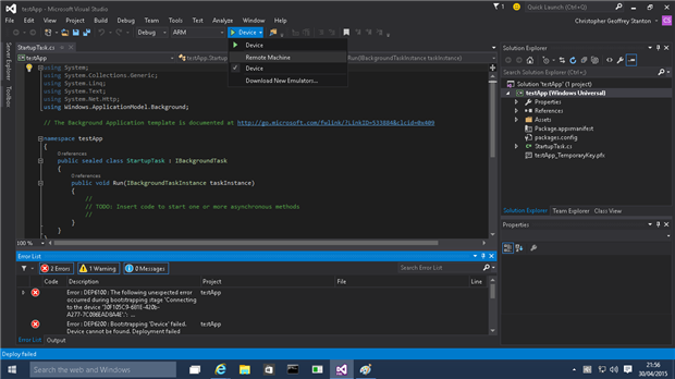

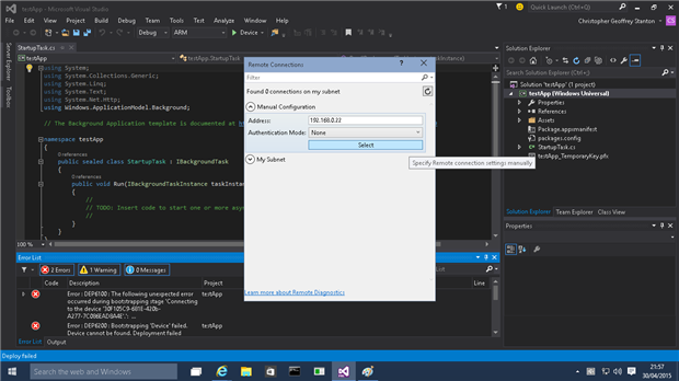

Deployment: To compile it we want to deploy to a 'remote machine', not a 'device'
Setup Remote Machine: Enter the details for the Pi 2 - no authentication has been setup

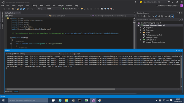

Compiling!: Turns out some framework's missing, it downloaded them, it's fine.
Is it done?: Believe it or not, this is the success dialogue!
Woohoo: Check to see if it's listed in Apps! Yes it is! (Along with suddenly two others, maybe framework related?)
