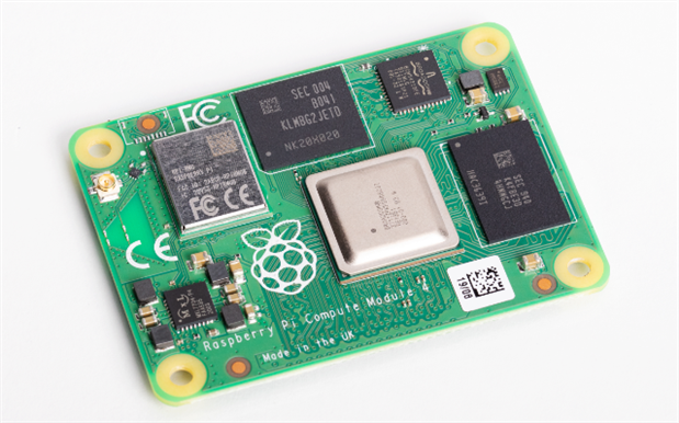

The CM4 is Smaller, Faster, Cooler and adds access to a host of other requested features, including, Dual HDMI, Dual Camera and PCIe! We will be breaking it down for you all today!
The Compute Module is a Raspberry Pi 4 boiled down to key components and set up to be integrated in your product design, including modular Radio certification.

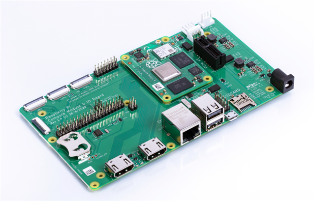

All of these features can be broken out on the Raspberry Pi Compute Module 4 IO board.
Find out more about the IO board here Raspberry Pi Compute Module 4 IO Board

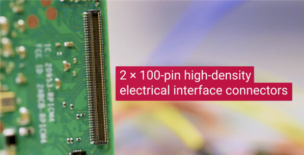

New connectors
The new connectors on the underside of the Raspberry Pi CM4 are designed to help you make the Raspberry Pi the heart of your embedded project.

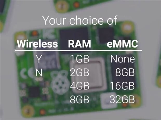

32 variants - A Choice of Ram and eMMC Flash Memory
With four RAM options, four Flash options, and optional wireless connectivity, There are a total of 32 variants, with prices ranging from $25 (for the 1GB RAM, Lite, no wireless variant) to $90 (for the 8GB RAM, 32GB Flash, wireless variant). The 1GB RAM and no wireless variants keep the same price points ($25, $30, $35, and $40) as their Compute Module 3+ equivalents: once again, they have managed to pack a lot more performance into the platform without increasing the price.

    EDIT: just noticed they're using 0.4mm pitch connectors..  not insurmountable, but they had the space for larger connectors on the underside perhaps. They are using near-similar connectors that Intel Edison used.. so a bit of a pain, some accuracy is needed.
