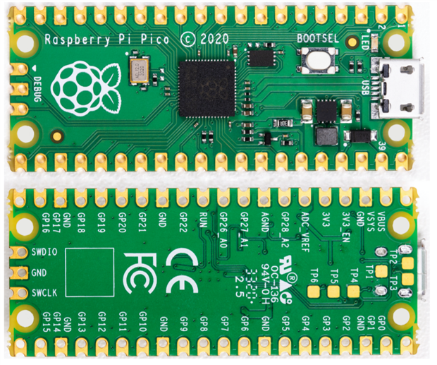

We are very excited to introduce the all new Raspberry Pi Pico, a tiny, $4, MicroPython and C/C++ board with custom RP2040 silicon.
This is the first product from the Raspberry Pi Foundation built with their in house designed RP2040.
At $4 and available individually or even available on reels, this Raspberry Pi is the next step in home and industrial products.
Looking at the edge of the PCB you can see the Raspberry Pi Pico has been designed to be used with header pins or soldered directly onto your products PCB.

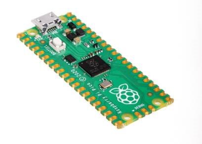

Raspberry Pi Pico Specifications:
  • GPIO and Debug Pins
  • RP2040 Microcontroller
  • Two cores clocked at 133MHz
  • 256KB RAM
  • 2MB of On-board Flash Memory
  • Micro-USB B Port for Power, Data and Reprogramming of the Flash memory.

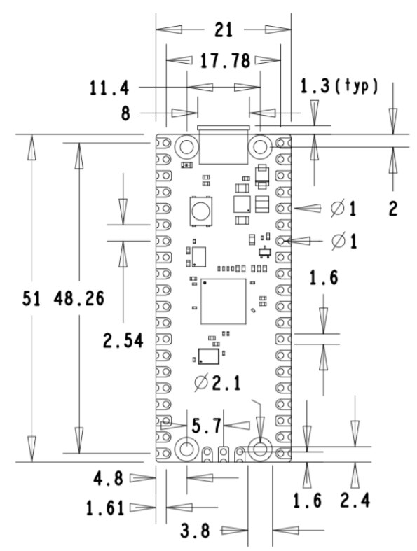

Raspberry Pi Pico Dimensions:
21mm (W) x 51.3mm (L) x 3.9mm (H)

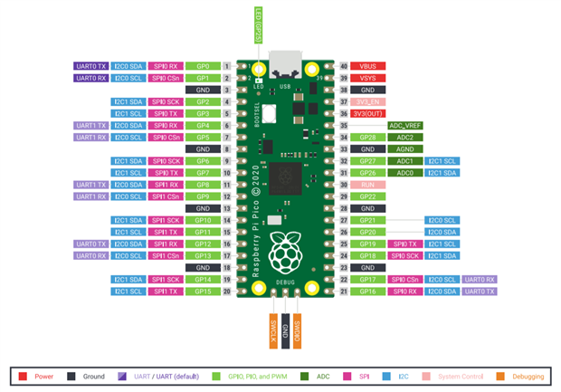

Raspberry Pi Pico GPIO Pinout
The 40 pin 21x51 'DIP' style 1mm thick PCB with 0.1" through-hole pins also with edge castellations
  • Exposes 26 multi-function 3.3V General Purpose I/O (GPIO)
  • 23 GPIO are digital-only and 3 are ADC capable
  • Can be surface mounted as a module
  • 3-pin ARM Serial Wire Debug (SWD) port

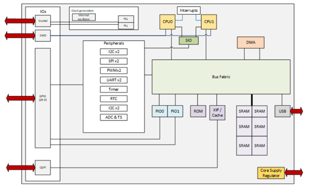

RP2040 Microcontroller.
RP2040 is a low-cost, high-performance microcontroller device with flexible digital interfaces. Key features:
• Dual Cortex M0+ processors, up to 133 MHz
• 264 kB of embedded SRAM in 6 banks
• 30 multifunction GPIO
• 6 dedicated IO for SPI Flash (supporting XIP)
• Dedicated hardware for commonly used peripherals
• Programmable IO for extended peripheral support
• 4 channel ADC with internal temperature sensor, 0.5 MSa/s, 12 bit conversion
• USB 1.1 Host/Device

Raspberry Pi Pico Size and Layout:
