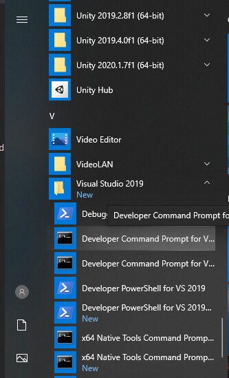

    jomoenginer over 5 years ago in reply to 14rhb
    Did  you follow the Windows instructions (Section 8) from the Getting Started Guide?
    https://datasheets.raspberrypi.org/pico/getting_started_with_pico.pdf
    You need to install the CMake extension from within VS Code.
    Also, you launch VS Code from the 'Developer Command Prompt for VS 2019' and not from a standard Windows command prompt.
    This is noted in the Warning. Otherwise you will have extra config stuff to do.This is the same place as where the build from command line is performed:

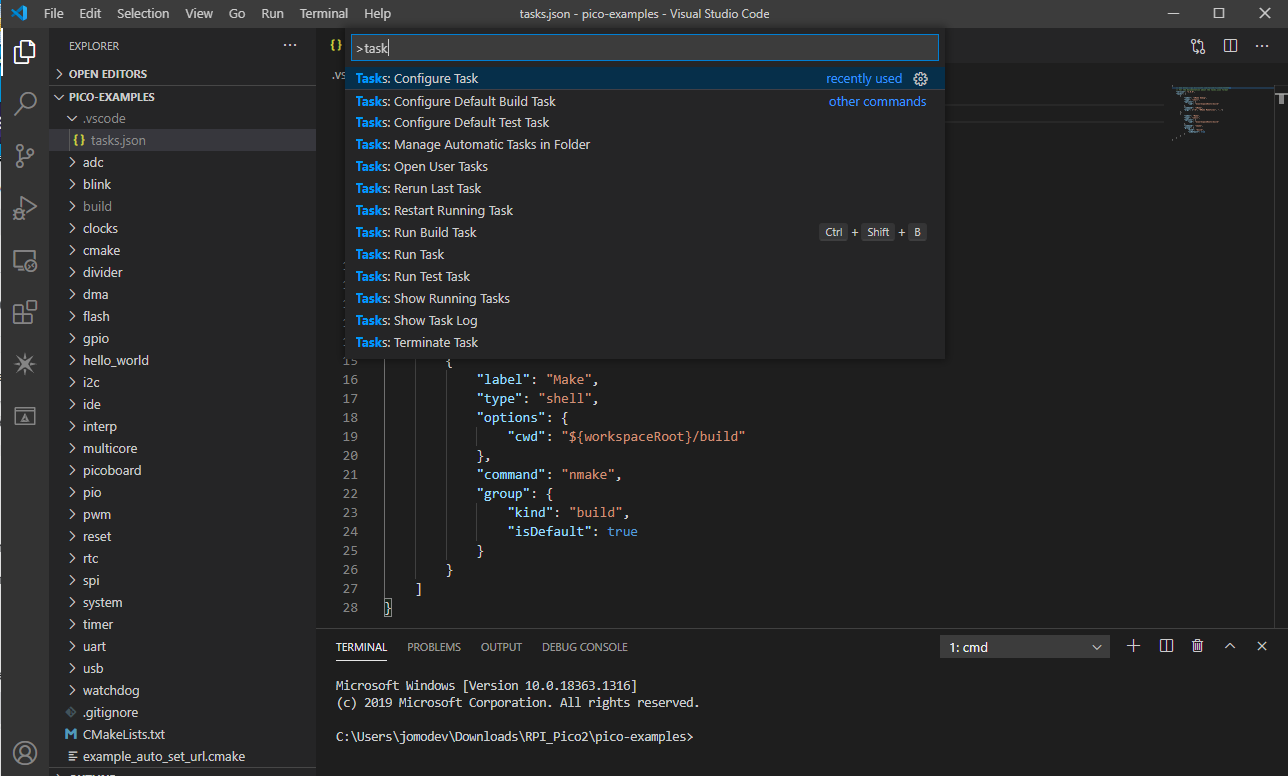

    jomoenginer over 5 years ago in reply to michaelkellett
    There are instructions in the following link that show this:
    https://www.40tude.fr/compile-cpp-code-with-vscode-cmake-nmake/
    Ex:
    Now we need to be able to call CMake from VS Code in order to generate a Makefile corresponding to the
    Debug version of our application. From inside VS Code let’s press F1 or CTRL + SHIFT + P.
    On the prompt (see the ‘>’ in the bar) type « task » then use the down arrow key to select « Configure task »
    and hit ENTER.
    After pressing F1 or CTRL + SHIFT +P, you type in task and select Configure task:

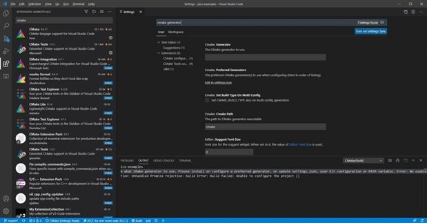

    After launching Visual Studio Code from a commandline with C:/code, importing the pico-example folder and then building, I get the following error:
    Unable to determine what CMake generator to use. Please install or configure a preferred generator, or update settings.json, your Kit configuration or PATH variable. Error: No usable generator found.
    I tried uninstalling VS Code and re-installing it. The field for CMake Generator is blank. Anyone have any suggestions for what to do here ?

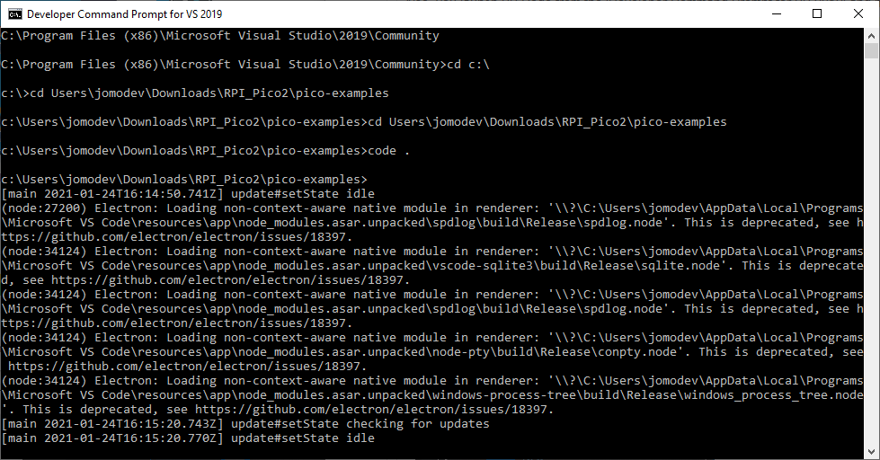

    When you create the tasks, just take the default which should be under .vscode in the project folder.
    Another thing, in the Developer Command Prompt for VS 2019 window, I change directories into the pico-examples folder and create the build folder and then start VS Code in the pico-examples folder by running 'code .'.
    This will start VS Code with the pico-examples folder already active.
    You may need to add the path to VS Code in your PATH if it does not find code in the Dev window.

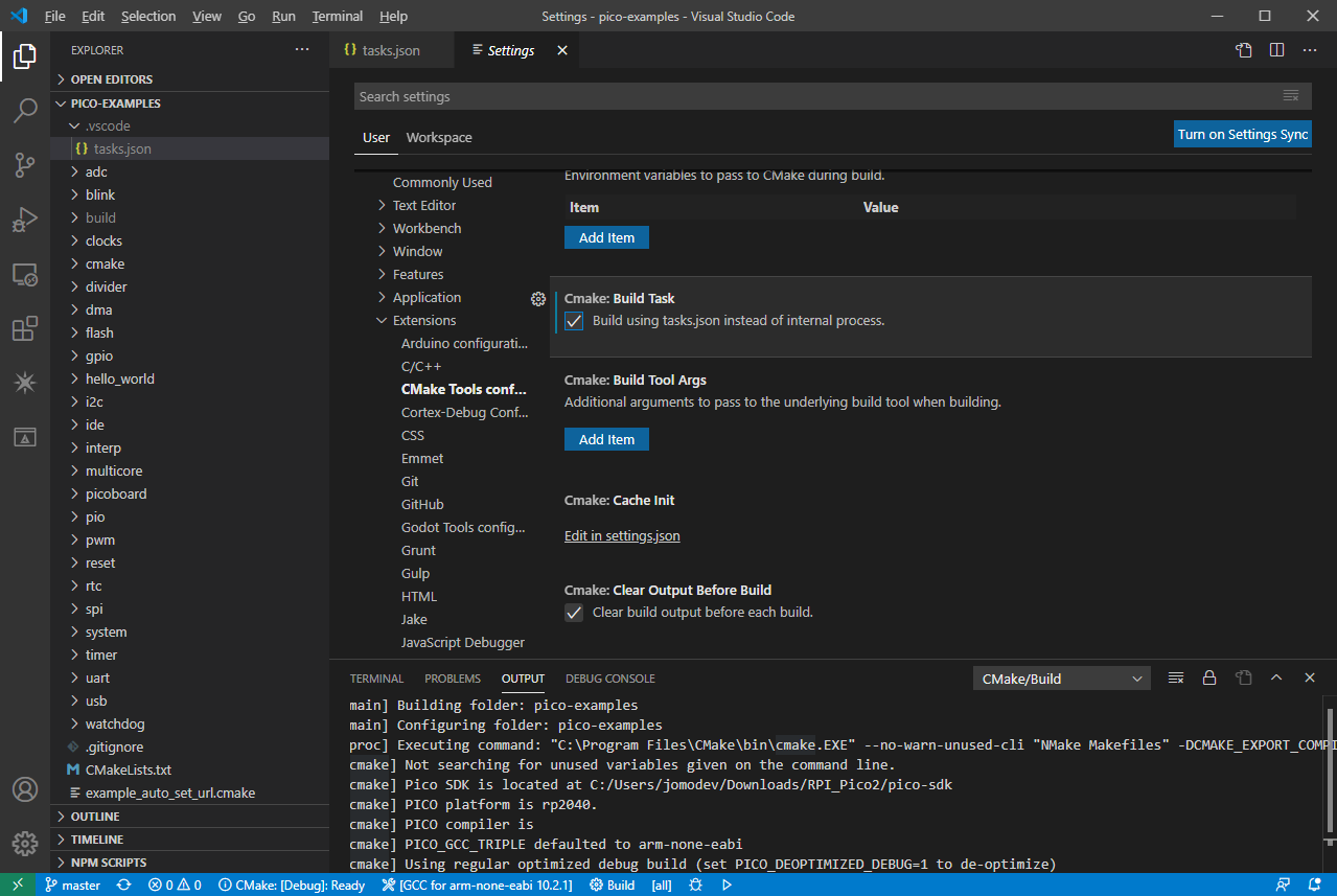

  • jomoenginer
    I found a link that shown how to create a build task where you can specify the parameters to build the code rather than having to wade through all the options in VS Code.  I was not able to get a clean build using the VS Code config, so this was a good option.  Still, have no board to run this on as of yet, but it does seem to be build.
    The example did not work as shown, so the args for CMake has to be separated but a ','.
    I'm not 100% sure if this correct, but it seems to work.

    I did set the Build Tasks Settings in VS Code to build from tasks.json though:
    Ex:
