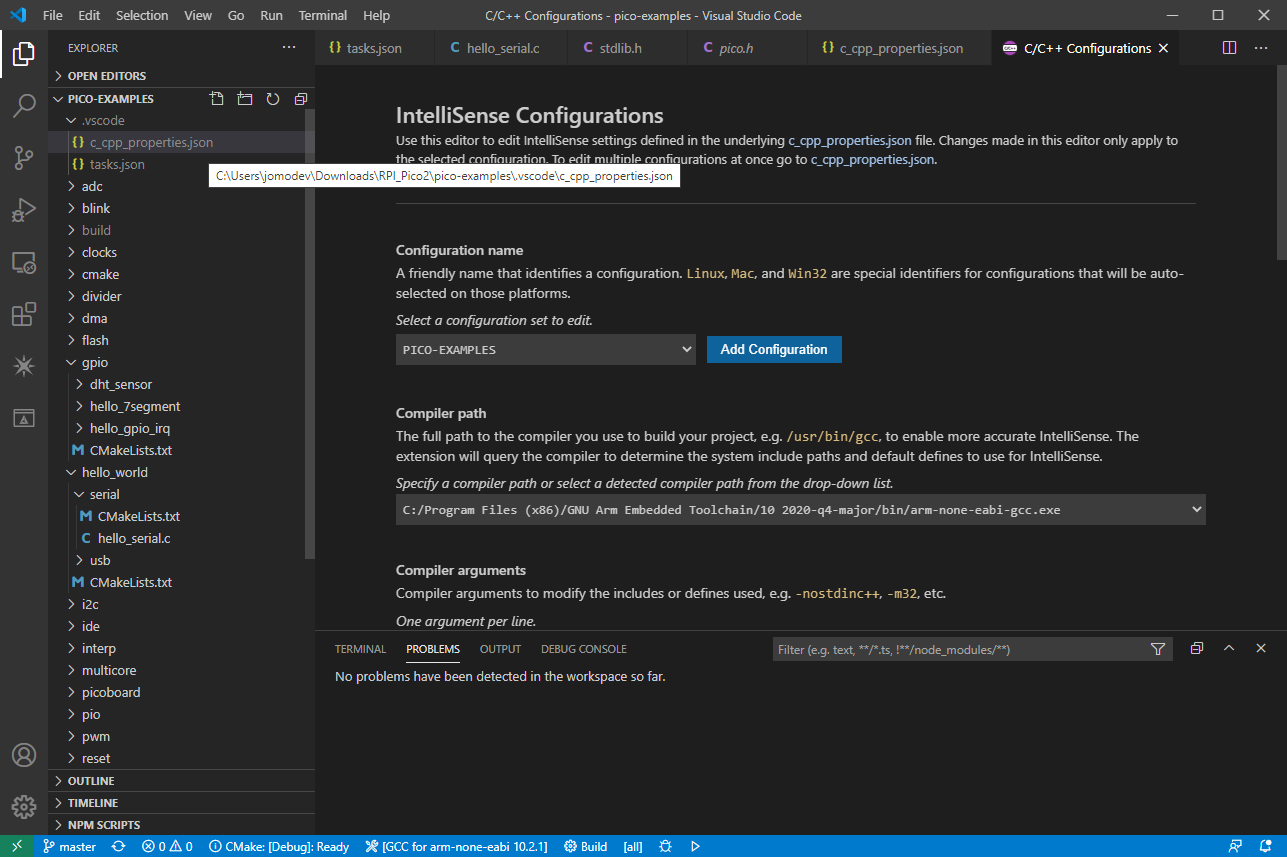

  • jomoenginer
    jomoenginer over 5 years ago in reply to 14rhb
    14rhb  wrote:
    Your JSON script did however now give me the option to build with arm-gcc, which was missing previously.
    It should have been building with the ARM GCC compiler already either command line or in VS Code. In VS Code there is a step to select the Active Kit from the bottom of the screen. Otherwise I suspsect the code will not run on the Pico. The c_cpp_properties.json is for the IntelliSense config which seems to help resolve locations of files.
    There are a couple of things to note with the IntelliSense config and the Pico code.  In the IntelliSense config for the 'includePath', from what I gather it will not do a recursive search, so I was not able to do something like "C:/Users/jomodev/Downloads/RPI_Pico2/pico-sdk/**".  Also, the way they laid out the pico-sdk and pico-examples code, the libraries are separated into their own folders so if VS Code can not find it, you need to search in either pico-sdk or pico-examples to see where it is located and add that particular path into the 'includePath'. This is why there are so many listed in the c_cpp_properties.json file example I posted.
      Also, IntelliSense seems to be using Linux based separators so with a Windows path such as:
    C:\Users\jomodev\Downloads\RPI_Pico2\pico-sdk\src\rp2_common\pico_printf\include
    You need to either add an escape character in front of the "\" or change this to a forward slash "/" as i did in the c_cpp_properties.json file:
    Ex:
    C:\\Users\\jomodev\\Downloads\\RPI_Pico2\\pico-sdk\\src\\rp2_common\\pico_printf\\include
    Or:
    C:/Users/jomodev/Downloads/RPI_Pico2/pico-sdk/src/rp2_common/pico_printf/include
    This is a pain when doing a copy and paste of paths from a Windows folder.
  • 14rhb
    14rhb over 5 years ago in reply to jomoenginer
    Thank you for all the points, I'll check the PATHS and maybe start the VSCode setup from scratch again, maybe I missed a small detail.
  • 14rhb
    Thank you for finding this jomoenginer - you are a genius. Most of the squiggle is now sorted, just a little piece at the start image. I need to spend a while better understanding the setup in VSCode as I think that would be useful anyway.

  • jomoenginer
    I have seemed to resolved the issue where the Pico libs were not found (Red Squiggles) in the VS Code IDE.
    In the VS Code , type "Ctrl-Shift-P" which will open the IntelliSense Configurations section as well as create a c_cpp_properties.json file under .vscode.
    This will create some Windows definitions in the c_cpp_properties.json file so I replaced them with the following:
        "configurations": [
                "name": "PICO-EXAMPLES",
                "includePath": [
                    "${workspaceFolder}/**",
                    "C:/Users/jomodev/Downloads/RPI_Pico2/pico-sdk/src/common/pico_base/include",
                    "C:/Users/jomodev/Downloads/RPI_Pico2/pico-sdk/src/common/pico_stdlib/include",
                    "C:/Users/jomodev/Downloads/RPI_Pico2/pico-sdk/src/rp2_common/pico_platform/include",
                    "C:/Users/jomodev/Downloads/RPI_Pico2/pico-sdk/src/rp2_common/pico_stdio/include",
                    "C:/Users/jomodev/Downloads/RPI_Pico2/pico-sdk/src/rp2040/hardware_regs/include",
                    "C:/Users/jomodev/Downloads/RPI_Pico2/pico-sdk/src/host/hardware_timer/include",
                    "C:/Users/jomodev/Downloads/RPI_Pico2/pico-sdk/src/host/hardware_gpio/include",
                    "C:/Users/jomodev/Downloads/RPI_Pico2/pico-sdk/src/host/hardware_uart/include",
                    "C:/Users/jomodev/Downloads/RPI_Pico2/pico-sdk/src/common/pico_time/include",
                    "C:/Users/jomodev/Downloads/RPI_Pico2/pico-sdk/src/boards/include/boards",
                    "C:/Users/jomodev/Downloads/RPI_Pico2/pico-examples/build/generated/pico_base"
                "defines": [],
                "compilerPath": "C:/Program Files (x86)/GNU Arm Embedded Toolchain/10 2020-q4-major/bin/arm-none-eabi-gcc.exe",
                "cStandard": "gnu17",
                "cppStandard": "gnu++17",
                "intelliSenseMode": "gcc-arm"
        "version": 4
    I'm not 100% if all it is right, but the errors locating the things like "pico/stdlib.h" have been resolved.
    The one odd thing is the reference to "pico-examples/build/generated/pico_base" which does not get created until you build the project, so there will be errors until a build is performed.
    So far it seems to work.
