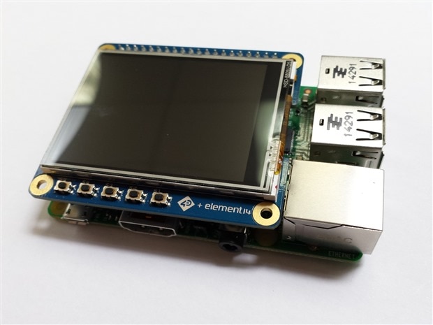

Finally, 4D Systems have brought out an affordable 2.4" TouchScreen2.4" TouchScreen compatible with the Raspberry Pi A+, B+ and 2 Model B! It's very, very nice.

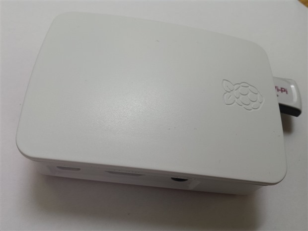

Pi Foundation Case: Well protected and contained, what's inside?

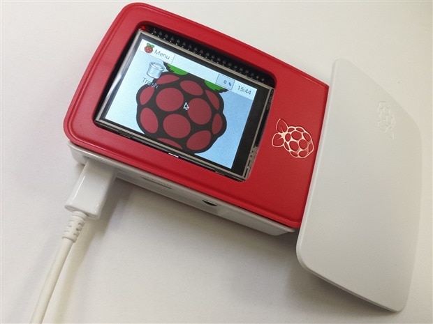

Bright and Cheerful: The 2.4" screen mounted on the Pi fits neatly and viewable through the top of the case

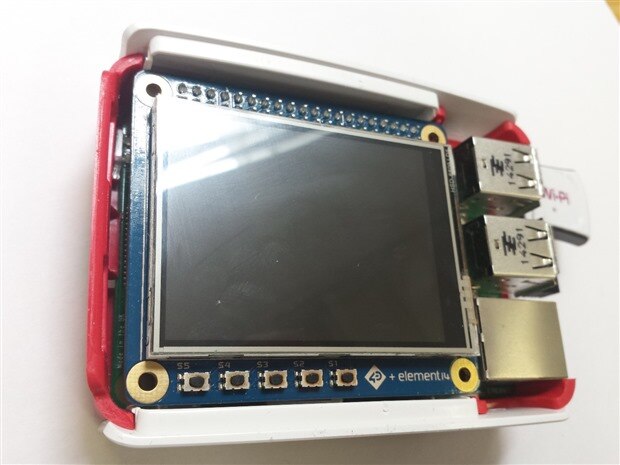

Gutted: With the entire top off, so we can see the five buttons.

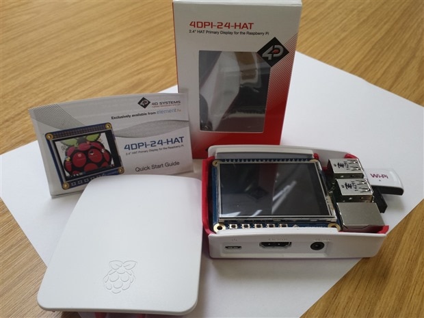

Packaged Up: You receive a small quick start guide inside the box, along with the screen. Nothing else is included.

The TouchScreen sits on the bank of GPIO pins (all of them) and almost fully covers the exposed Raspberry Pi (not counting the USB / Ethernet ports) and it hovers and I am re-assured that there will be a set of "stand-offs" soon to be purchasable  to secure the screen above the pins and connectors of the Pi.
What you may immediately notice from the photographs is how nicely the screen fits inside the Official Raspberry Pi CaseOfficial Raspberry Pi Case, this was an intentional design decision between element14 and 4D Systems. Perhaps one day the official case will be designed with portable power in mind, too? We can only hope.
