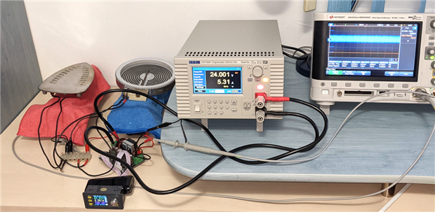

2. Resistive Loads
I stared the experiments with resistive loads, mostly heating elements salvaged from broken equipment:

I tried came up with a series of voltages that mostly cover the output voltages / voltage ranges of the tested power supplies. Than, I selected suitable resistive loads for each voltage. The power supplies were then tested with these combinations of voltage an load.
For each combination of the following was measured:
  • Ripple and Noise - RMS and peak-to-peak values, measured using the Power Application of the MSOX3034TMSOX3034T
       (for the Ripple measurements I used the RMS value; the peak-to-peak value is a good indication of the noise present on the output signal)
  • Power On and Power Off behaviour - Turn On and Turn Off time
A screenshot of the waveform displayed on the oscilloscope was saved for each test.
Aim-TTS QPX750SP
I started the testing with the subject of this road test, the Aim-TTS QPX750SP. These are the values I got:
Aim-TTI
QPX750SP

The output ripple is pretty low, around 1.5 - 2.3 mV for all voltages / loads. The average peak-to-peak noise is 18 - 23 mV.

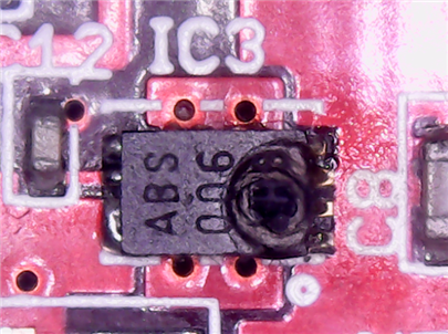

ChipKit UNO 32
The next victim (literally, this time) was a ChipKIT Uno32.  The plan was o power it from a 12V jack style supply.
Oppsie! image
Looks like the 3.3V regulator released the magic smoke.
After some investigation, I found that a jumper was set to bypass the 5V regulator, so the 3.3V regulator ended up being powered with 12 V. It supports a maximum of 6 V. Yeah, user error! image
