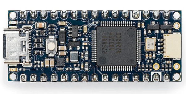

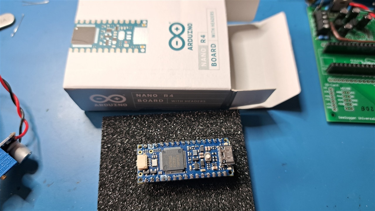

1. Unboxing & First Impressions
The Arduino Nano R4 was received in standard Arduino packaging with the board securely enclosed in an anti-static cover.
Package Contents:
  • Arduino Nano R4 board
  • Berg strip headers (unsoldered)
Initial Observations:
  • Compact Nano form factor retained
  • High-quality PCB finish
  • Clearly labeled pinout
  • USB Type-C interface for modern connectivity
The inclusion of unsoldered headers allows flexibility depending on application (breadboard vs embedded use).

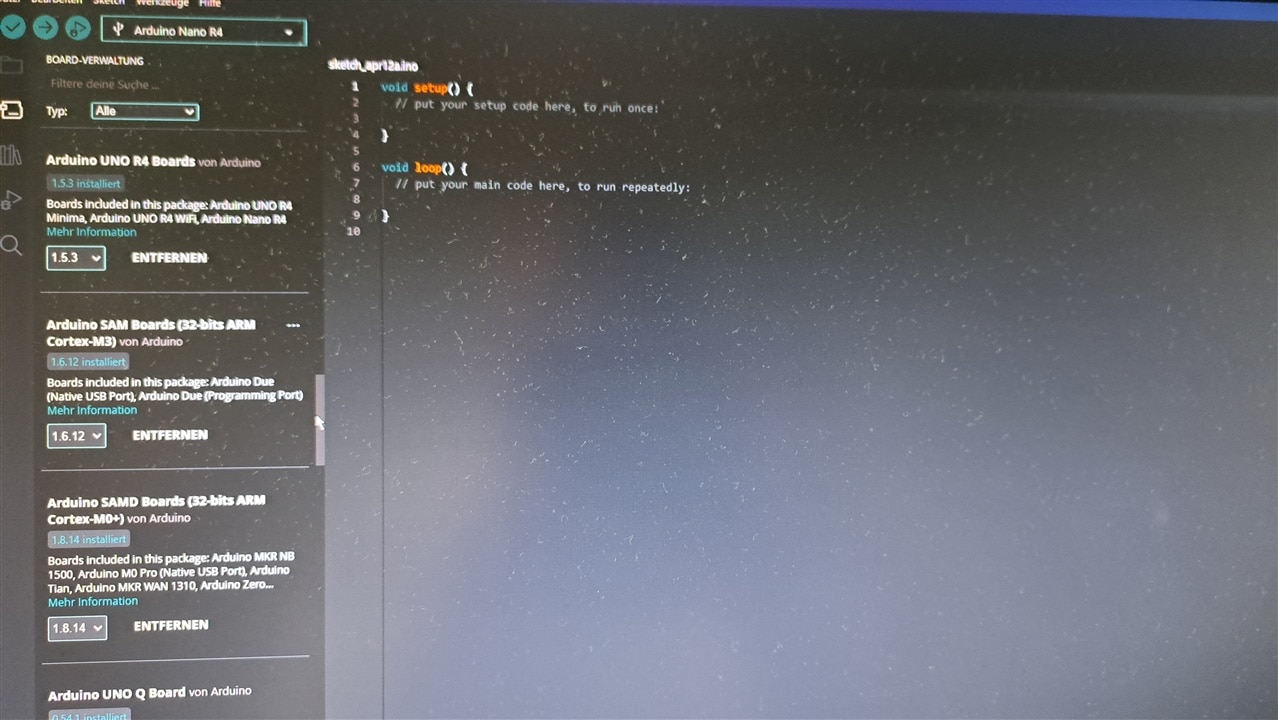

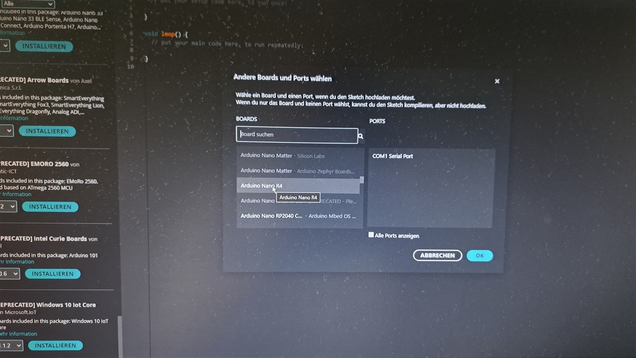

3. Initial Power-Up & Arduino IDE Detection
After soldering, the board was connected to the system using a USB Type-C cable.
Expected Behavior:
  • Automatic USB detection
  • COM port visibility in Arduino IDE
  • Board ready for programming
Observed Symptoms:
  •  No COM port visible in Arduino IDE
  •  Device shown as “Unknown USB Device” in Windows Device Manager
  •  Upload attempts failed completely
  •  No LED indication of bootloader activity
 At this stage, the board appeared non-functional and inaccessible

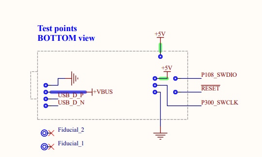

11. Switching over to SWD debug access to recover the target chip R7FA4M1AB3CFM mounted on Arduino Nano R4 board:

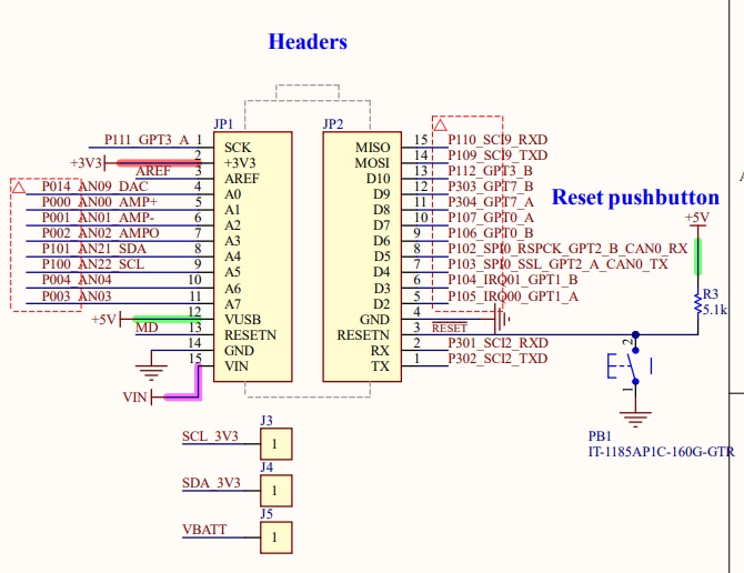

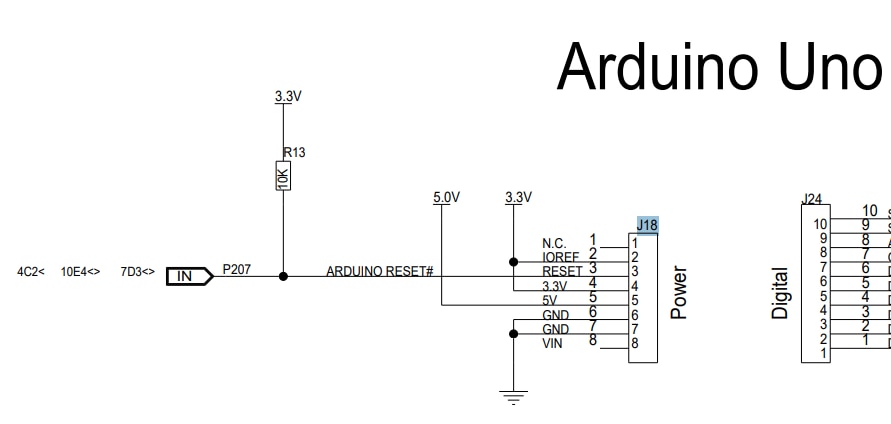

Now, i would like to refer to official schematics of Arduino Nano R4 given on this link:
https://docs.arduino.cc/resources/schematics/ABX00142-schematics.pdf
Here are 3 important observations about above picture are given below required for SWD bebug access:
1. MD pin of MCU given on JP1 connector pin no 13. -> This pin should be connected with SWCLK pin of debugger.
2. RESET pin of MCU given on JP2 connector pin no 3. -> This pin should be connected with RESET pin of debugger.
3. VUSB pin of MCU given on JP1 connector pin no 12 -> This pin should be given +5VDC from debugger USB power supply.
Here are some important observations about above picture are given below required for SWD bebug access:
1. P108_SWDIO & P300_SWCLK are required to connected with any compatible debugger -> Jlink / CMSIS-DAP / Renesas made Emulator
2. Very-very important point :  P300_SWCLK & MD pin of MCU given on JP1 connector pin no 13 should be shorted with each other & connected to SWCLK line from debugger side.

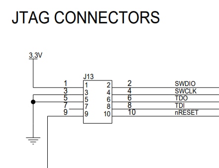

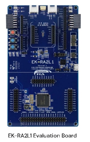

Again by chance, i already possess this evaluation kit made by renesas:
This board already have onboard Jlink OB lite debugger mounted on this kit. So, i decided to connect this debugger to Arduino Nano r4 while totally disconnecting on board target chip.
Now, referring to schematics of this kit which are found in ek-ra2l1-v1-designpackage.zip , these are important points everybody needs to consider for connections given below:
Please! download ek-ra2l1-v1-designpackage.zip from Renesas website.
Now, given below is important section of debugger to get connected with external target chip
Important Note: all jumpers shown in this diagram needs to taken out totally, to cut off the onboard target chip for debugger connections.
J13 connector shown above is not populated in actual kit, so all the connector pads are exposed which were directly soldered for debugger connection with Arduino Nano r4 board.

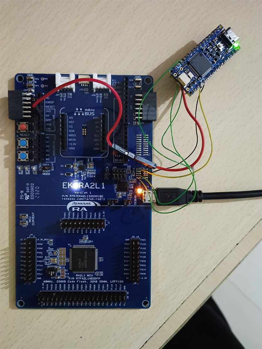

In above picture, 5V power supply can be easily seen which was connected with Arduino Nano R4 board to get power up using debugger USB power supply.
J-link Commander after getting correct connection from debugger will give below message corresponding to Arduino Nano R4 board:

I m showing the picture of actual physical connections with debugger & Arduino Nano R4 board given below:
Important observation noted: I was able to recover original preloaded program which was actually loaded in Arduino Nano R4 at time of arrival using jlink debugger.

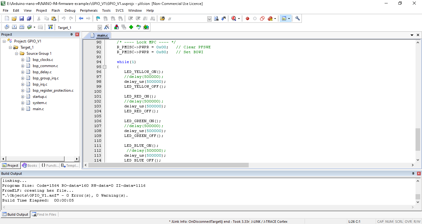

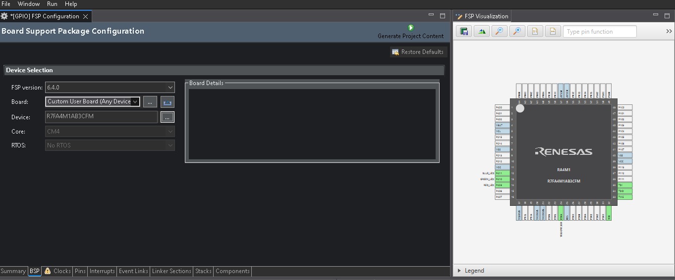

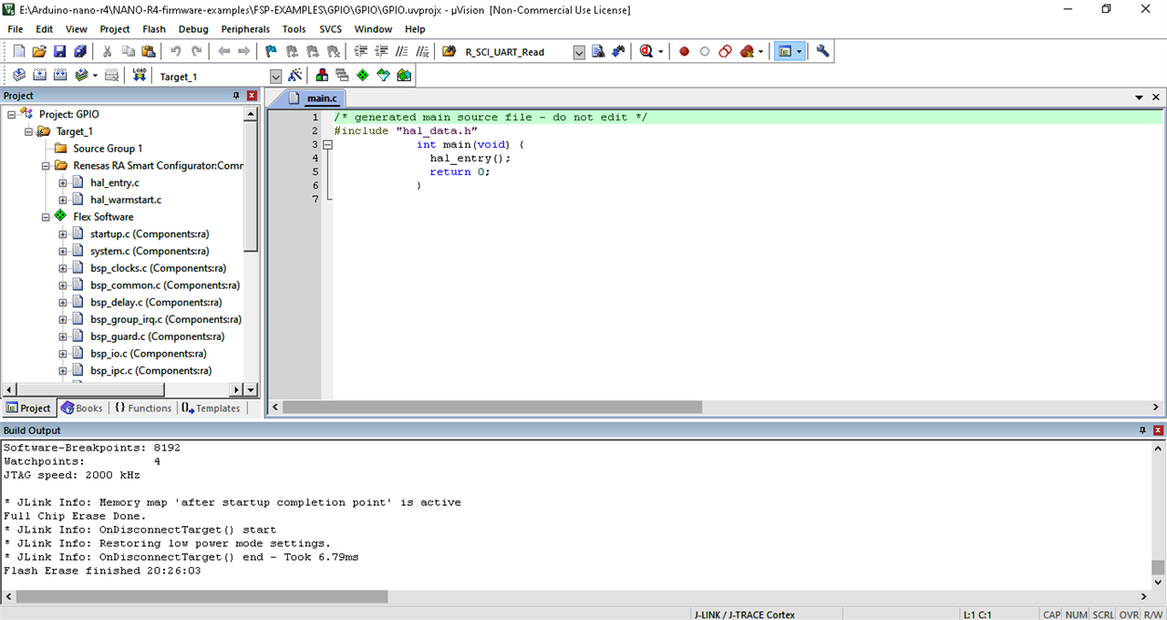

12. Switching over the development of  target chip R7FA4M1AB3CFM mounted on Arduino Nano R4 board from Arduino IDE into Keil MDK ARM :

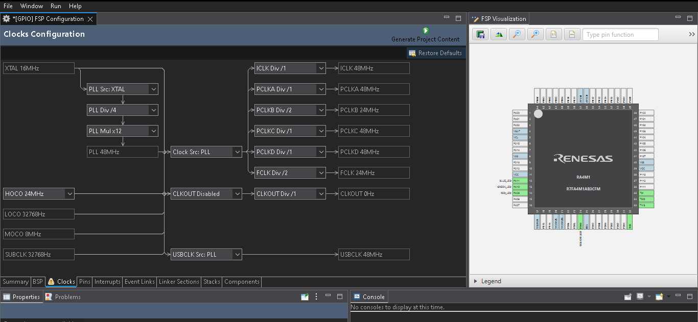

Here you have to use Renesas smart configurator with Output configured for Keil MDK ARM.
Select the clock settings given below in Renesas smart configurator in given screenshot:
Select Board : Custom User board (Any Device) as shown in screenshot given below:

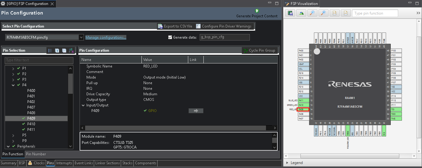

Pin function select is shown in given screenshot :
BSP options are shown in  below screenshot:

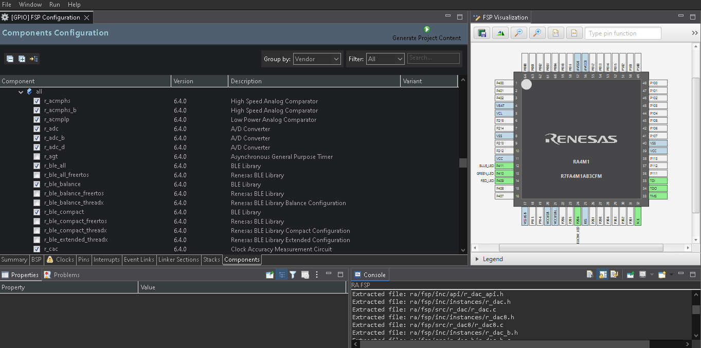

In bsp options, just select bare metal & No RTOS to include. Also select "Generate Project option" option to generate Blinky program in this configurator as shown below:
Below given picture demonstrates the output given by Renesas smart configurator for Keil MDK ARM:
To run this program correctly, Please! do the following steps:
Search & comment  this line given below:
FSP_HARDWARE_REGISTER_WAIT(R_RTC->RCR2_b.RESET, 0);   -> This line is found in bsp_clocks.c
Important observation: Debugger gets stuck on above line.
Update on 31/03/2026:
Keil screenshot on C/C++ tab:
Keil screenshot on Asm tab:
Keil screenshot on Linker tab:
Configure the below settings in Flash download of keil as shown screenshot given below:
Apply the above settings, then follow the below given steps:
Generate the hex file.
Completely erase the chip.
Then program the chip using download button in keil.
Expected result: You should be able to RGB LED as single white LED glowing brightly but without blinking.

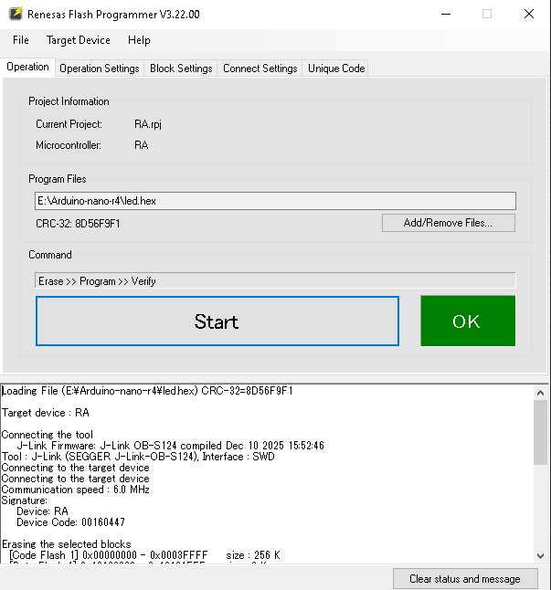

Now, after resolving settings issues, renesas flash programmer is also working, screenshots are given below:
Programming messages by Renesas Flash Programmer are given below:
Loading File (E:\Arduino-nano-r4\led.hex) CRC-32=8D56F9F1
Target device : RA
Connecting the tool
J-Link Firmware: J-Link OB-S124 compiled Dec 10 2025 15:52:46
Tool : J-Link (SEGGER J-Link-OB-S124), Interface : SWD
Connecting to the target device
Communication speed : 6.0 MHz
Signature:
Device: RA
Device Code: 00160447
Erasing the selected blocks
[Code Flash 1] 0x00000000 - 0x0003FFFF size : 256 K
[Data Flash 1] 0x40100000 - 0x40101FFF size : 8 K
Writing data to the target device
[Config Area 1] 0x01010008 - 0x01010033 size : 44
Verifying data
Setting the target device
Disconnecting the tool
Operation completed.
Important observation: This tool should be used to production programming rather than for development.
13. Build the whole project in keil bypassing Renesas smart configurator
 If you do not want to use code generated by Renesas smart configurator -> then it is still long learning curve, but some how i managed to reduce the number of files to taken from smart configurator & managed to write in register direct format. Also i have followed the steps given just above this section.
End result of above exercise is shown below screenshot:
Of course, result was fabulous: I was able to blink RGB LED & AMBER LED independently bypassing the HAL library as mandated by Renesas.

Complex root cause – Clock misconfiguration impacting USB initialization required deep MCU-level analysis

Shift to hardware-level debugging – Required use of SWD + J-Link, full chip erase, and reflash to recover the system

It requires the assistance of JLINK/ CMSIS DAP / Renesas EMULATOR to recover from all types of firmware issues.
Also this board requires the erase of whole chip to prevent the hang-up.
The Arduino Nano R4 delivers powerful Renesas-based performance, but its recovery mechanisms need significant improvement to support advanced embedded development workflows.
Renesas flash programmer is not reliable at all, it does not connect with Jlink reliably to sense the chip.

    Hi, Just to be clear: The section 8 "Root cause analysis" refers to: Clock Misconfiguration / Bootloader Interference / USB Stack Failure but how could it have been any of those, unless Arduino shipped…

    Dear misaz, you can refer the schematics of ek-ra2l1 using ek-ra2l1-v1-designpackage.zip. I have already shown that renesas designed debug section where by default MD pin was shorted with SWDCLK using…

  • geralds
    geralds 7 months ago
    Hi,
    you said: "USB problem"...
    Last week I purchased a Nano R4 at Farnell.
    For the first check: I just unboxed my new Nano R4, connected on the USB, started the Arduino IDE, checked the right board, selected the connected USB-Port, then I read the board information.
    NanoR4 unboxed
    check right board
    check right USB-Port
    Hi,
    you mentioned: "...USB problem"...
    My first impression.
    Last week I bought a Nano R4 from Farnell.
    For my initial check: I unpacked my new Nano R4, connected it via USB, started the Arduino IDE, selected the correct board, chose the connected USB port, and then read the board information.
    The board works perfectly, and I was able to get it up and running in just a few minutes.
    Of course, I made sure to install the latest drivers in the Arduino IDE.
    This applies particularly to the CMSIS and JLink drivers; I installed the original drivers for each.
    Yes, and Microsoft forced us to buy a new PC last October because of Windows 11. Anyway, I'm using Win11 Pro and connecting the board to the PC's USB 3.0 port.
    The board already has an RTOS installed, so it's essentially plug-and-play, making it easy to get the board up and running. -> Arduino IDE, last Version.
    I'm not a fan of unnecessary experimentation when it comes to setting something up for the first time.
    Only after that can I experiment, including with software drivers on the board.
    That way, if something is configured incorrectly, you can revert to a working setup. That also means backups, backups...
    The Nano R4 is new to me, so I'm really looking forward to learning a lot.
    I'm very curious to hear about your great experiences with the Nano R4!
    Best Regard
    Gerald

    Dear misaz, you can refer the schematics of ek-ra2l1 using ek-ra2l1-v1-designpackage.zip. I have already shown that renesas designed debug section where by default MD pin was shorted with SWDCLK using jumper.  I have removed those jumpers to connect Arduino nano R4 with debugger.
