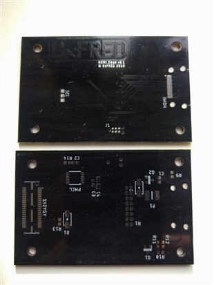

The PCBs are back!image
I must admit I did the design in a bit of a hurry as I didn't want to wait ages for the boards and for this "part 2" of my road test to be too far removed from the first part. I needn't have worried. The boards were at my door with 10 days of ordering. Considering they only cost $11.58 and I received 10 boards rather than the 5 I ordered, I'm once again amazed at how good, cheap and quick it is to get your own board spun up.

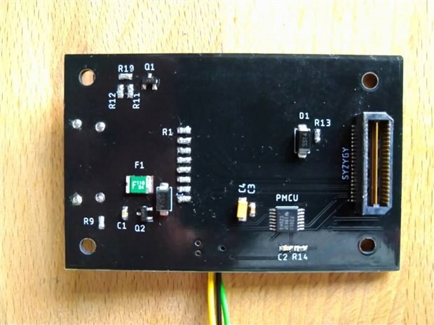

I decided to put most of the components on the bottom of the board. The reason for this was that I intended to reflow the board in my toaster oven and thought it better to have all the surface mount components on the same side. The surface mount Samtec QTE connector has to go on the bottom, so I decided everything else would go with it and the top would be saved for the HDMI connector. This is of source also surface mount, but has some through hole lugs too.

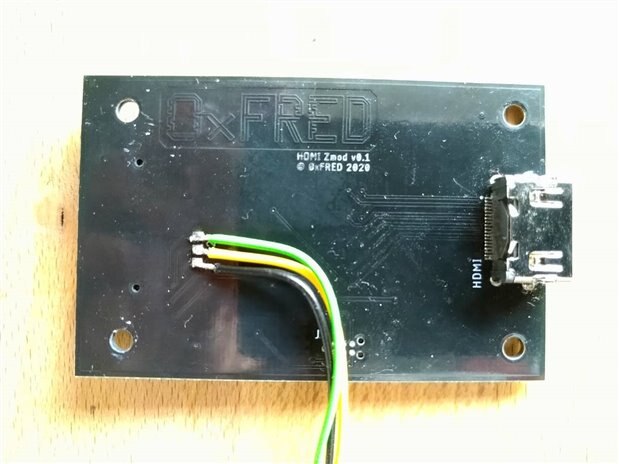

This left a fair bit of empty space which I filled with a 0xFRED logo. It was fairly large as the letters are drawn with three PCB traces. I worried a little that it might be too overstated, but as they're traces under solder mask it was reasonably subtle. I think it came out fairly well. One thing I did notice is that I put "HDMI Zmod v0.1" on there and as I discussed in my previous post, this is not strictly a Zmod board as that would require some of Digilent's Zmod code. Oops. I'm hoping they don't sue me! image

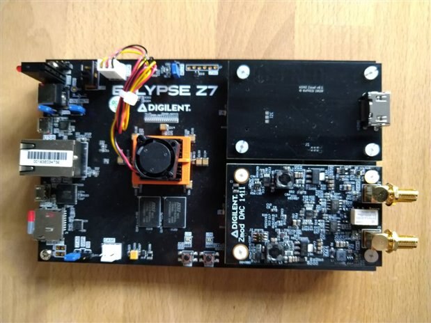

First things first, I populated one of the boards. I didn't use a stencil or reflow oven for the first one. I just added a few blobs of solder paste and got out the hot air gun. It all went OK. I needed some solder wick for the 0.8mm pitch Syzygy and HDMI connectors but all in all it wasn't too bad. I suppose I was most worried about some of the physical aspects. Did the syzygy connector and mounting holes match the Eclypse Z7? Does the HDMI cable foul anything? I needn't have worried about that. It was all fine. and looked nice mounted on the Eclypse Z7 alongside the Zmod DAC. I was wondering whether my choice to put the component underneath made it look a bit bare though. Those three wires are to let me spy on the I2C comms between the host board and my peripheral. Putting all the components on the bottom doesn't make it easy to debug. Strangely, this was the first board I've ever made without even a debug LED on it either! Luckily a sharp probe tip and those vias in the middle do the job.

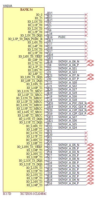

I can see from the Eclyse Z7 schematic that the Syzygy port is connected directly to the Zynq pins, so I should be able to ignore these comms and quickly check that the wiring for the HDMI is right. Let's jump ahead a bit.

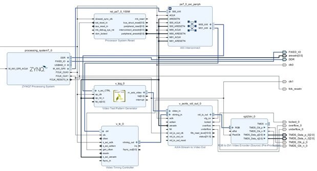

Whilst waiting for the PCBs I knocked up a test project that uses a pattern generator to output a test pattern over HDMI. I made sure this ran OK on the Pynq Z2 and ported it over with only minimal changes to go with the different pins connected to the HDMI socket. I fired it up and... nothing. I figured there was no point spending ages on the polish of I2C and Syzygy DNA if the hardware wasn't even right, so I spent quite a while on this. An embarrassingly long time, in fact.
Nothing was coming out on the pins I'd connected to HDMI. I figured I must have made a mistake. I tested for ages, running PL clock signals and video timing flags out to the Pmod port so I could see what's happening. It was only when I moved one of these working test signal from the Pmod to the Syzygy port that I twigged what was happening. I knew I hadn't told Syzygy what IO voltage I needed but I hadn't realised that mattered. The IO bank used for this Syzygy port was driven from this voltage! Obvious now, but I hadn't realised they were externally powered. I assumed if my Vivado design was right then that was all that mattered.  This tiny "VADJA" label at the top of the IO bank was the key!
