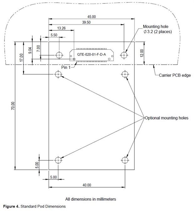

The SYZYGY specification tells you everything you need to know - such as which pins should be used for various functions, the size of the board and the placement of the connector and mounting holes. Here's one of the most helpful parts of the spec. It also mentions that you need to read a bit further and implement the SYZYGY DNA...

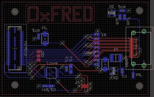

Designing the PCB
I was still determined to keep things as simple and increase the chance that this would work. I added the MSP430 and a TagConnect debug header. I added the Samtec QTE and HDMI connectors. (I got footprints from SamacSys although it's lucky that I checked them because the Samtec one wasn't quite right. The locating pins were a bit off and this would have meant the board and mounting holes would have been misaligned.
The rest of the HDMI circuitry for CEC, hotplug detection, etc probably wouldn't be used, but I decided to add them anyway. In order to reduce the chance of error I took a lot of this from the schematic of the Pynq Z2 board where I know HDMI works and the Xilinx IP does the job. A few evenings later, version 1 of the board was ready and off to a Chines board house it went. It was about $5 for 5 board and another $7 for shipping. Crazy cheap prices! I thought about going for a stencil. This was only $10 buy would have added another $15 shipping and more importantly would have probably caused my package to attract the attention of customs, adding VAT and handling fees. As there are no really tricky footprints I decided to just go with manually applying paste.
Here's a screenshot of the finished board layout. I'll obviously publish it in full, but let me check that it works first! You may have noticed the overly brash and prominent 0xFRED logo. I thought I'd try something that's inspired by the PCB itself. This is actually made from copper traces fully underneath black soldermask, so I'm hoping this will be a lot more subtle that it might look from this image. If it works - and looks OK - then I might expand on this idea and actually incorporate these traces in future designs. For now they're just unconnected copper.
