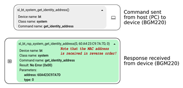

Now, you may have noticed that when you have the Bluetooth NCP Command Tool loaded and your device is connected via the USB port, the first command this tool automatically sends is:
To replicate this in our code, we would send a byte sequence {0x20,0x00,0x01,0x15} for the command “sl_bt_system_get_identity_address()” and based on the docs.silabs.com reference, we would  expect to get a response which includes two parameters “address” (which is formatted as data struct bd_addr or uint8_t addr[6]) and “type” (uint8_t) together with a SL_STATUS_OK if successful or Error Code if otherwise (in uint16_t format).
But if you tried this yourself with some code you will first receive a raw 4-byte response as follows: 0x20, 0x09, 0x01, 0x15.
This looks fine at face value, but how do you confirm this response is linked to the command that was just sent and how do you confirm the payload size?

So in this example our long HDR value is 352389408 and using that formula we get  SL_BGAPI_MSG_LEN = 9 as our answer for payload size.
Then to decode the message received so as to validate which command this response is linked to we convert our HDR (long) value to a “Message ID” (long) value using this formula:
msg_ID = HDR & 0xffff00f8 = 352387104;
Now we can split this long value back to a 4-int array as follows:
Hdr[0] = int((msg_ID >> 0) & 0xFF);
Hdr[1] = int((msg_ID >> 8) & 0xFF);
Hdr[2] = int((msg_ID >> 16) & 0xFF);
Hdr[3] = int((msg_ID >> 24) & 0xFF);
Now if we check these 4 values we get: 0x20, 0x00, 0x01, 0x15 as our linked command confirmation.

boolean system_get_identity_address_handler() {
  refreshScreen = true;
  if (error_check((Payload.get(0) | Payload.get(1)<<8))) {
    String msg = "BGM220P MAC: " + hex(Payload.get(7),2) + ":" + hex(Payload.get(6),2) + ":" + hex(Payload.get(5),2) + ":" + hex(Payload.get(4),2) + ":" + hex(Payload.get(3),2) + ":"
    + hex(Payload.get(2),2) + ", type: " + Payload.get(8);
    if (DEBUG) println(msg + "\r\n");
    SubHeader += "\r\n" + msg;
  else return false;
  return true;
