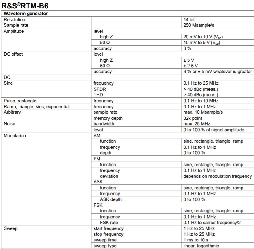

Fig: Specifications of the RTM Waveform Generator
Testing the Waveform Generator in RTM 3004
As it is clear from the specifications, this is a decent but basic 14 bit waveform generator with a low sampling rate of 250 Msamples/sec and has 3% amplitude accuracy. It can generate sine, pulse, rectangle, ramp, triangle, sinc and exponential waveforms with maximum 10 MHz or a lower 1 MHz frequency.

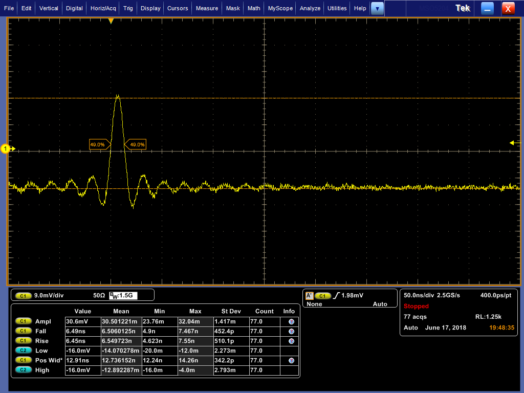

Fig: Sine Signal from the RTM 3004 waveform generator
Fig: SinC Signal from the RTM 3004 waveform generator

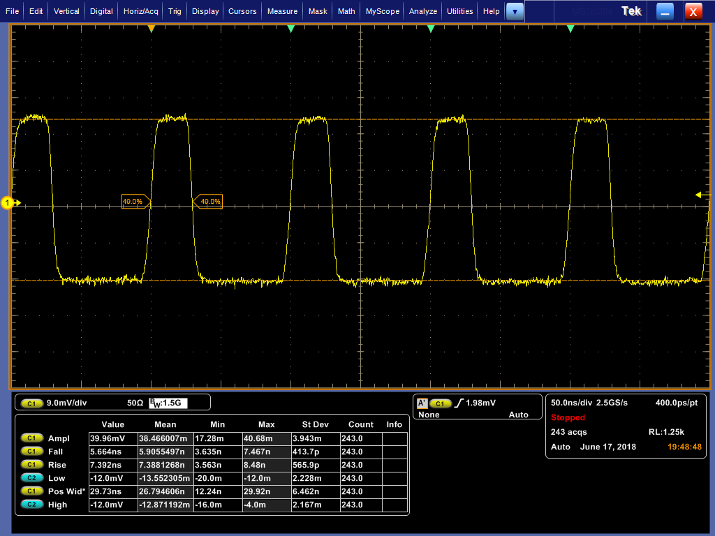

Fig: Pulse Signal from the RTM 3004 waveform generator
Fig: Triangle Signal from the RTM 3004 waveform generator

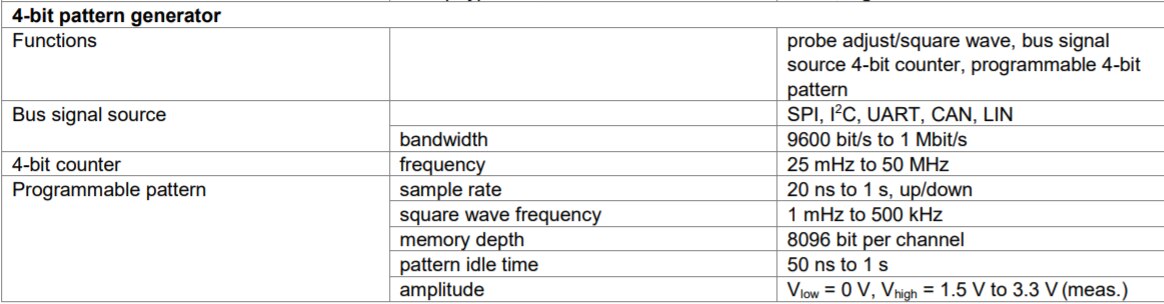

In the RTM-3004 oscilloscope; the pattern generator is embedded in the oscilloscope itself. Normally, I have worked with stand-alone pattern generator devices. This functionality adds a uniqueness to the oscilloscope as it is very useful tool for digital engineers. The RTM-3004 has a 4 bit programmable pattern generator using which one can generate square wave, pulse patterns or any user defined patterns. Each channel can be programmed individually and used for digital testing. It can produce a repetitive signals or single shot pulse for triggering purposes. The voltage levels generated by the pattern generator are normally complaint with the digital I/O electronics standards such as TTL, LVDS, LVCMOS, LVTTL and others.
Fig: Specifications of the RTM 3004 Pattern Generator
