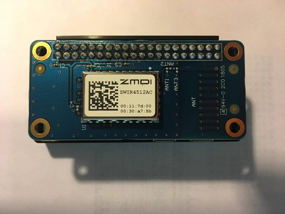

Wireless Hub:
With the case open:
And the backside of the Pi Hat.

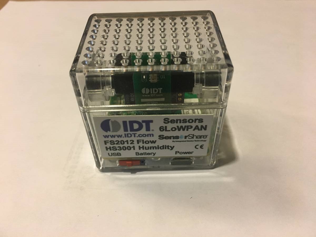

Here are images of the Sensor Cube:
Front:
Back:

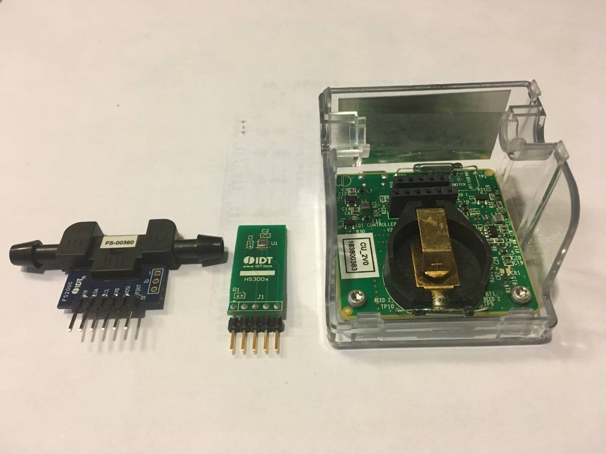

Top opened:

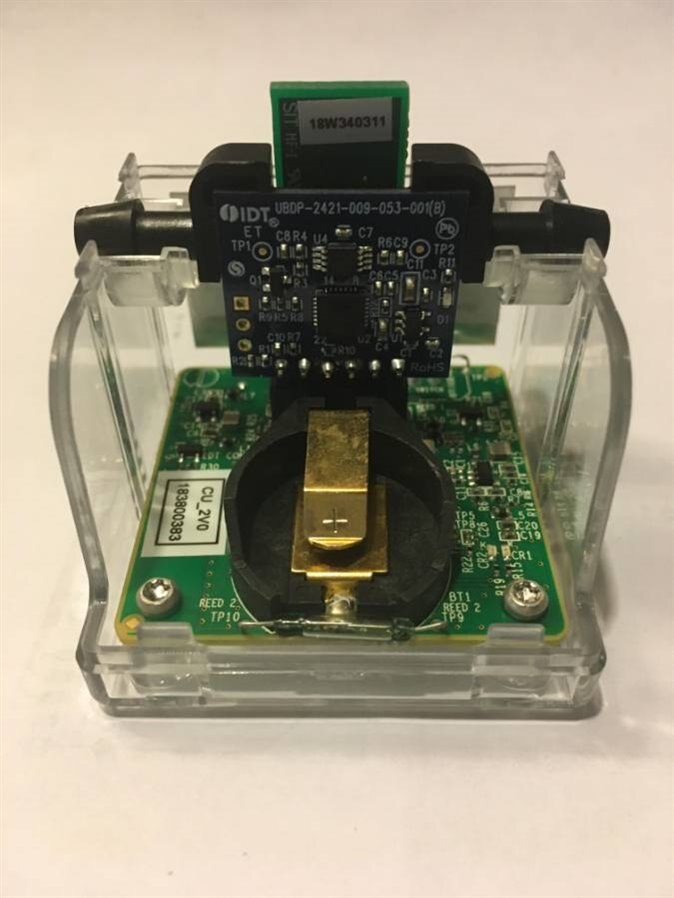

Looking down into the sensor cube (modules removed).

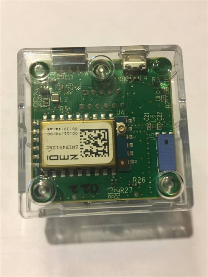

And a view of the bottom of the cube showing the ZWIR4512:

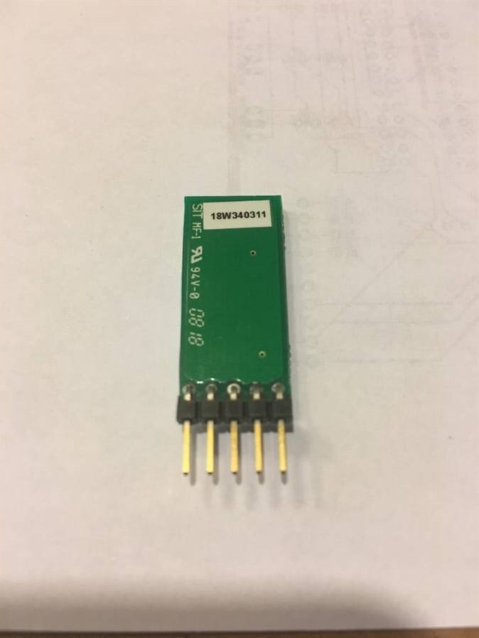

Modules removed. The flow sensor is on the left and the HS3001 temperature/humidity sensor is in the middle.

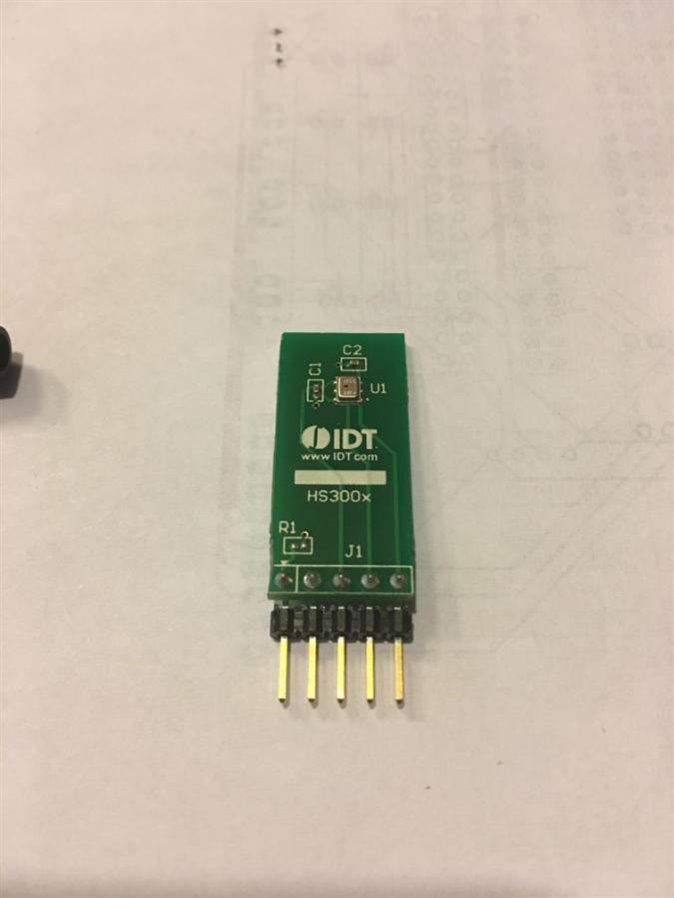

HS3001 Temperature/humidity sensor detail - Front
and back.
