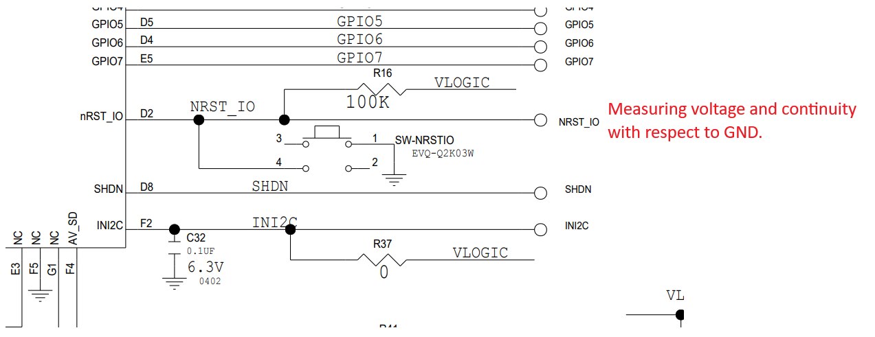

My RoadTest of the MAX77714 EVK just keeps getting more bizarre. Both of the push button switches on my EVK fail to operate. A few weeks ago I was briefly experimenting with the soft power button features and couldn't get it work. Turns out, it is because the push buttons are defective. I have recently discovered this trying to document my failing 32K crystal oscillator. I wanted to reset the PMIC to confirm my memory of the sequence of events that transpired trying to get the 32K oscillator to run were correct.

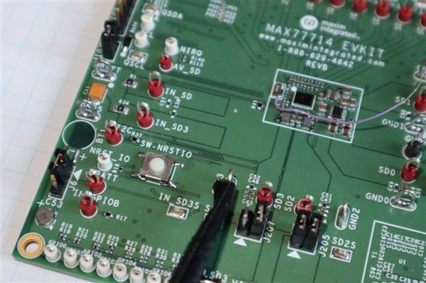

So I pushed the reset button expecting all the PMIC/RTC registers to return to their power on reset values. I pushed the SW-NRSTIO button:
None of the registers changed in the EVK GUI. I proceeded to measure the voltage on the NRST_IO test point and the level on the test point remained high at 1.8 V (VLOGIC).
A short video pushing the button (I can't believe this is what I am Road Testing with a Maxim EVK).
At which point I disconnected the backup battery and micro-USB cable to power cycle the board (I am powering the board via USB minus one diode drop with jumper J103 shorted), which most certainty did cause the MAX77714 to power on reset when I reconnected the USB cable.

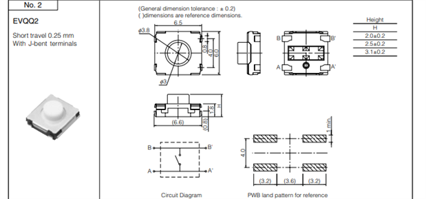

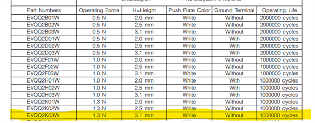

This has me really spooked. Why would both push buttons be defective, the BOM for the EVK lists Panasonic EVQ-Q2K03WEVQ-Q2K03W push buttons.
The dimensions of the buttons on the board match the datasheet specifications 6.0 x 6.5 x 3.1 mm, so I assume these are the genuine parts.
I measured continuity from A to A' and B to B', but could not get the button to actuate.
Why would a push button fail like this?

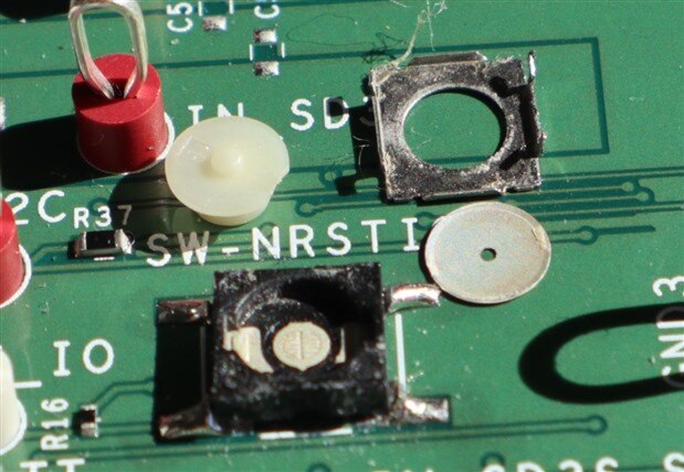

I decide I would go straight to a failure analysis without cleaning or desoldering the component. I lifted the top metal shield/cage of the button off first.
Inside the push button:

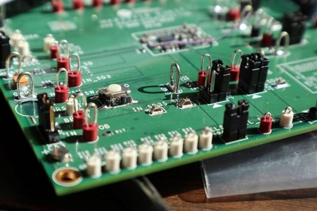

I can ring-out gnd continuity on the center pad and nrst continuity on the left and right pads. I don't get continuity when applying a very light pressure with my multimeter probe, so perhaps the contacts are oxidized or dirty. The dome doesn't appear like it has ever made contact to the center pad, perhaps that's normal. I will try cleaning the contact surfaces and see what happens.
Update #2
Just as @kmikemoo suggested in the comments, the switch contacts were indeed dirty. I captured in a single take video the second switch coming to life: https://youtu.be/LOSyaA2UKl4 with the application of some isopropyl alcohol.
I really don't know what to say. It's not like this board has lived a hard life on the shelf at Maxim or Newark, So, I would not have expected to these push button switches to fail so early.
I now have working push buttons!

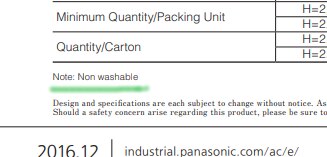

  • jc2048
    jc2048 over 5 years ago in reply to scottiebabe
    https://www.farnell.com/datasheets/2609102.pdf
    If it's board wash residue, then someone missed this note on the datasheet. (Daft place to put it on the datasheet, though - I'd have put it with the soldering temperature profile at the end given that it's part of the manufacturing info.)
