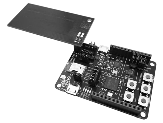

so the first bit, obviously, is opening the box. Inside the small but sturdy Farnell cardboard carrier is a thin, un-assuming book shaped box. somewhat reminiscent of a DVD case.
inside, the no-frills theme is continued. we get 2 re-sealable antistatic bags (Zip-lock! nice) and a small slip of paper that warns us about Disposal of old equipment. Apparently disposal of old equipment is only for the European union and countries with recycling systems.
The rear cover of the box promises "Fast prototyping, Quick start guides, Demo applications, and easy access to module pins", so I'm feeling confident! that's exactly what I'm looking for in this section.

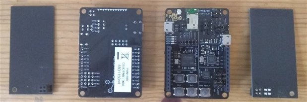

before diving in, lets have a closer look at the boards.
first up, we get 2 almost blank boards (far left, far right) which turn out to be antennas. I can tell that because they say "compensated 13.56 MHz antenna" on them. I had thought that Bluetooth was ISM band 2.4GHz stuff, so was a bit confused until I saw a mating connector on the main board which is marked NFC.

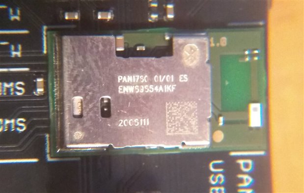

the main board is pretty basic, and quite small, time to get the magnifier out...
the components on the board look like 0402, so the parts on the module itself are silly-small. the "large" white block on the right is a chip antenna I think, and most other things are hidden under the stamped metal can.

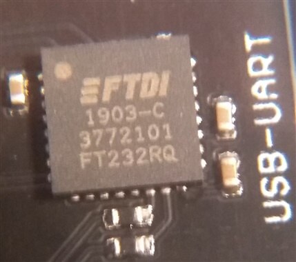

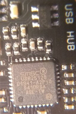

there are 3 other interesting ICs on the board, an FT232 uart to USB interface, an SMSC usb hub, and an Atmel SAM3U2C serving as a J-link debugging probe
the hub is a 2 port USB2.0 chip. I guess the Hub feeds 1 to the J-link and 1 to the FTDI chip. curiously, SMSC were bought by Microchip in ~2012, so its a bit odd to see that branding on a product as new as this. of course, Atmel were also bought by microchip in 2016. I don't know when Microchip will buy FTDI.
The board is nicely partitioned so that even if I didn’t know what these chips were, I could work it out from the silk screen.
there are also 5 buttons, many jumpers, and an antenna socket (uf.l possibly?) though we don't get an antenna cable in the pack.

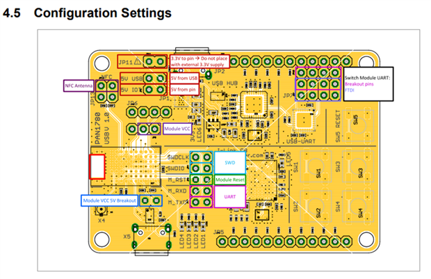

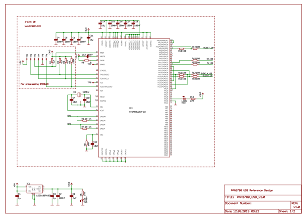

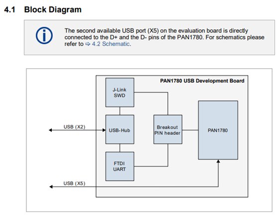

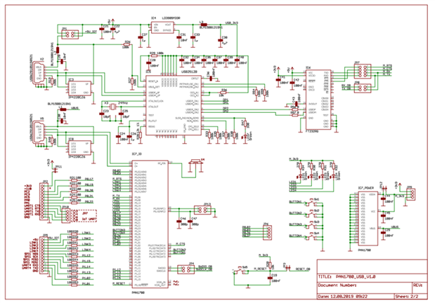

The real goodies are in chapter 4 though. its called "reference design", but its actually about the eval kit. (a subtle distinction, but sometimes the nomenclature matters)
we get a block diagram with some explanatory note about USB:
we get a schematic:
a very nice map of the board with significant parts labelled:
and the jumpers / pins functions:
they also show you how to connect the NFC antenna:
(which really is a bit awkward)
and a print out of the gerber layers.
pretty nIce stuff!image
but I would have liked to have better copies of this - actual gerber files? separate schematics rather than pictures in a long pdf manual? project files? I haven't seen any evidence that its available yet...

first, check all the jumpers are in the correct location. a handy visual aid is provided:
very nice. this is also really useful if you forget which jumpers you've changed and need to get back to the start. next, connect the device via USB to socket X2 to power it on.

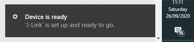

so, power it up - the manual says I may need to install drivers, but its all plain sailing for me (windows 10) . in case I did need to, the guide has links to FTDI and Segger.

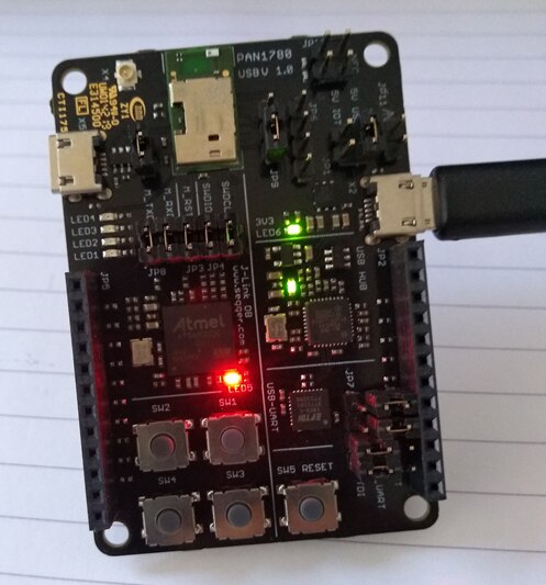

TIME CHECK:
ooooh flashing red and green lights! 1hr 45 mins in.image

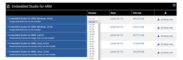

the device comes unprogrammed out of the box, so to get any further i need to set up the tool chain - the Nordic SDK, starting with "Segger Embedded Studio"
when the guide was written, the latest version of embedded studio was 4.30b, released on the 19th of November 2019. 10 months later, and we've had a further 12 updates! the most recent was less than 10 days ago. by the time I've finished writing this it will be out of date!
[*Note - its taken a long while to write this up, but sure enough at the time of posting we've had 2 further updates on V5.10d 2020-10-19 and then V5.20 2 days later!]
download, install, bish bash bosh.
image OUT OF DATE

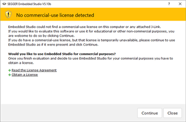

the guide says I should get offered a free license during the install, but I don't. the option on the left (screen shot from the manual) was never available, instead i got the one on the right!
turned out in the end I had to wade through the Segger website and find the link another way - I still got the free license, but i had to jump through a hoop or 2 to find it.
if you need one too, the link is here:
https://license.segger.com/Nordic.cgi

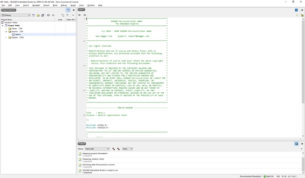

Segger embedded studio is actually pretty nice!
straight into main.c! it feels like a nice light weight fast and functional program.image
some modern IDEs are incredibly bloated and slow to start up for what is effectively a glorified notepad application. not this one.

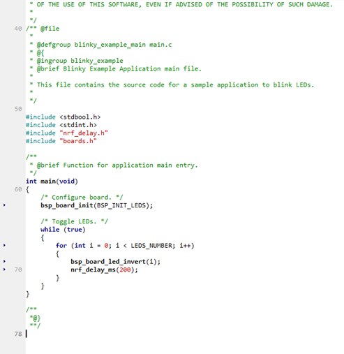

we're told to open a basic blinky project, and mess with the delay timing in the code, before pressing the green "build and run" arrow.
the code is very simple
lets have a look in the bsp_board_init(BSP_INIT_LEDS); function
if you follow the rabbit hole down, all it does is sets up the pins and turns them to the LED_OFF state

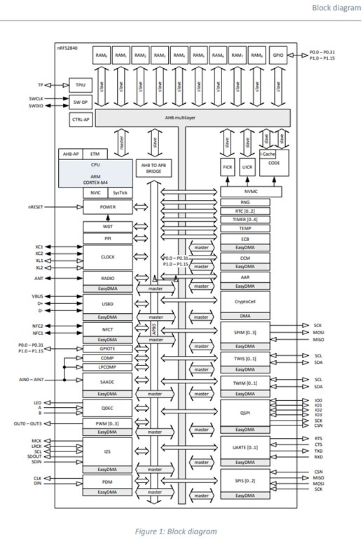

this is a remarkably small piece of code for an ARM Cortex M4 initialisation. I can't see anything related to clock trees / prescalers, power modes, or enabling the GPIO peripheral buses as you must do on the STM32s that I'm familiar with.
the block diagram for the microcontroller doesn't look so simple, I suppose most of the detail is hidden somewhere else? flicking through the source code there seems to be a lot of SDK related defines, so maybe its all in there somewhere.
there's the assembly start-up code, but even that is minimal by the looks of it. I'm not going to complain though, it works!

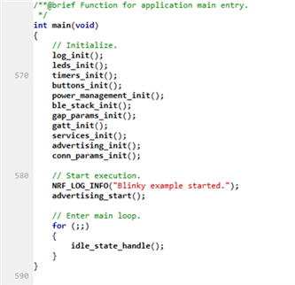

again though, I want to be able to customise it, so instead I'm going to open and compile the project instead.

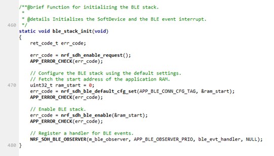

aha! this is significantly more complicated! here's main:
here is the protocol stack initialisation:
the BLE event handler is a pretty big state machine. compilation seems to work!

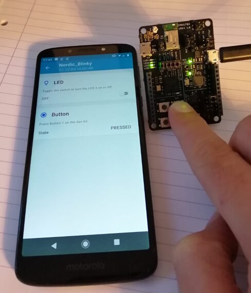

downloading the app is pretty simple, ... And STOP THE CLOCK!
We have achieved 2 way communication with the Bluetooth phone app. Very nice
its not shown incredibly clearly, but in the first picture the LED3 is lit (just below the USB socket on the LHS). The LED state, and the button press is listed in the app.
so, in total, that took 4 and 1/2 hours to get this going. its not all plain sailing, and I didn't exactly follow the guide word for word, but I feel pleased with the result. I could have easily achieved this in a typical work day even if you through in a long lunch and a couple of pointless meetings.
