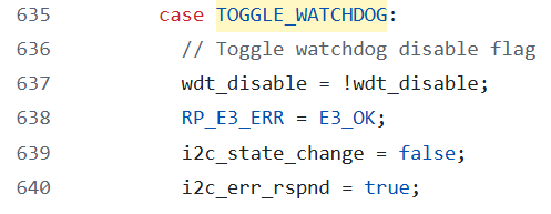

We are looking to update the E3 I2C controller functionality with the next major update. We have not fully confirmed the new code, so it may have some bugs in the feedback reporting.
Even though the changes are not directly reflected in the tool, you should be able to change the watchdog functionality by typing in the following command:
e3_i2c_controller -w 0x01 0xFE
That will toggle the flag.
With the current mode, you can view the HW and SW revisions by checking the error feedback log. This is something we need to fix in the E3 module code.
Alternatively, you can get around this by using the old code and manually changing the "wdt_disable" flag to "true".

I am trying to use the documented eMMC flashing procedure. The difficulty is that the module watchdog resets the Red Pitaya after U-Boot is interrupted, preventing sufficient time to perform the required U-Boot work.
I investigated the official RedPitaya/RedPitaya-Examples repository and found the recent E3 firmware development in the dev branch:
github.com/.../E3_source_code
In particular:
- Commit 39a82ae — "Reworked the E3 board code to allow disabling watchdog"
- Commit ee2051f — "QSPI eMMC code updated - added HW and FW revision feedback and option to disable watchdog."
- The resulting firmware is identified as QSPI_eMMC_code_v1r1.ino, with a corresponding .elf.
- The v1.1 source defines HW_ID as 0x01.
- It also implements VERSION_REQ_CMD (0xFD) and TOGGLE_WATCHDOG (0xFE).
I tested the firmware-version request against my module. The command was accepted by the Linux E3 utility, but the module continued to return:
E3AD0102
rather than the v1.1 firmware-version response. This appears consistent with the module running firmware that predates the v1.1 command interface.

    Another option would be to stick with v1.0 code but add the switch condition for the 0xFE command and have it toggle the watchdog state.
  • beacon_dave
    beacon_dave 2 months ago in reply to cstanton
    That's the main board. I believe we are talking about updating the QSPI eMMC module that plugs into the main board to get access to the eMMC module to use as a boot device.
    It contains a watchdog which will reboot the main board if it it stops responding.
    However to access the eMMC module to flash an image onto it you have to boot the main board into USB Mass Storage emulation which in turn stops sending the watchdog heartbeat, resulting in the eMMC module rebooting the main board before the flash cycle can complete.
    The v1.0 module code has no way of disabling the watchdog from the main board in software. This only appears in the v1.1 module code.
