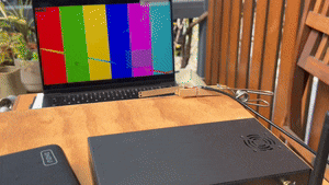

A core part of the dog feeder is watching the dogs and working out whether they’re actually sitting and waiting for their food — the ML side of this project needs a camera feed to work with at all. New sibling project, video-streaming-cm5/, same conventions as the soundboard project (Flask + systemd + mise, no Docker). First USB camera module DOA — enumeration errors in dmesg (error -71, “unable to enumerate USB device”) pointed at real hardware failure, not a config issue. Swapped modules and it enumerated cleanly.
image image
attempting to test all Black, all White and the use of ffmpeg's test video pattern

A cheap camera, and a decode/re-encode bug
At 1280×720 MJPG, the naive pipeline (decode MJPG → OpenCV BGR → re-encode to JPEG → serve) topped out at 14.99 fps, well under the raw driver ceiling (~27–28 fps). MJPG frames arrive already JPEG-compressed, so decoding and immediately re-encoding them was pure waste — setting CAP_PROP_CONVERT_RGB=0 to skip the decode and pass the camera’s original compressed bytes straight through fixed it: 30.12 fps, CPU down from 8.1% to 3.4%, frame-gap stddev down from 16.88ms to 4.13ms. Every metric improved together, which is the sign the fix removed real waste rather than trading one thing for another.
Then the numbers got inconsistent — and it looks like lighting is why
Same camera, same 1280×720 MJPG mode, pointed at different things:
Scene FPS
Indoor wall (bright, direct) 30.12
Monitor playing a test pattern 14.99
Hallway 7.58
Lens covered 3.84
Outdoors, direct sun 22.07
The first four numbers are close to an exact halving at each step darker — 30 → 15 → 7.5 → 3.75 — which points at the camera’s auto-exposure lengthening its shutter time as the scene dims (checked and ruled out a bandwidth/bigger-frames explanation directly: the darker scenes weren’t producing bigger JPEG frames, if anything the opposite). Outdoors breaks that clean pattern, though — direct sun should need a shorter exposure than an indoor wall, not land in between the wall and the test pattern, and dropping resolution at the same outdoor scene didn’t recover the FPS either. So: lighting is clearly a real factor, and probably the dominant one indoors, but it isn’t the whole story outdoors. This camera doesn’t expose exposure controls over UVC, so none of this can be confirmed directly, only inferred from behaviour — still investigating.
A better camera changes the picture
Swapped in a Logitech C922 Pro Stream Webcam and immediately hit a different, unrelated bug: switching modes without explicitly requesting an FPS silently dropped it to the slowest option the camera enumerates (5fps) — turns out leaving that unset isn’t safe to assume defaults to the fastest. Once fixed to always request a specific FPS, the C922 held a clean 1080p30, sub-2ms jitter, no auto-exposure games. Early days with this camera still, but the gap to the cheap webcam is already obvious.
Lesson for next time either way: lighting/exposure is a real confound, easy to mistake for a bandwidth or interface finding. Keeping the physical setup identical matters as much as keeping the test content identical — something to hold constant once CSI actually lands and the real three-way comparison (cheap USB / good USB / CSI) can happen.
