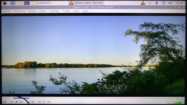

Next I captured some 4K MP4 video with my camera and tried to play it on the Pi 4B - this did not work (so far). The VLC player on the Pi just shows blank. So I used a video converter to convert from MP4 to MP4 with the same 4K resolution. VLC displays this file, but the video is frozen on the first frame. VLC on my PC plays these files well, so it would seem we need to wait for a VLC upgrade for this to work.

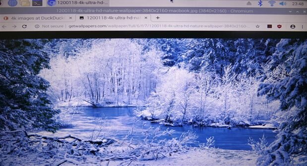

Next I tried to play 4K YouTube videos with the browser - this worked.
The still image viewer also displayed 4K resolution stills.
In both cases the results look good, but I can't tell if it is displaying full 4K resolution. Between the TV performance, the camera performance and the Pi performance, it is tough to tell where the image is being degraded and there are so many pixels, it is tough to tell if there is any degradation at all.
Here is a screen shot, which doesn't do the system justice, since I can't put a full resolution image in this blog and the camera lighting was not good to start with.
Here is VLC trying to play a 4K video, but only showing the first frame:
I am still trying to get audio to be included in the HDMI signal and find a way to play 4K videos from my camera.

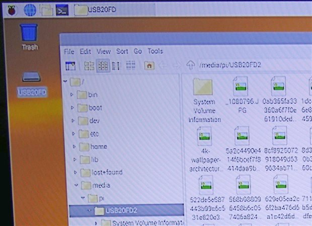

  • I set the desktop to 4K resolution by editing the config.txt file in the boot directory. This is the only directory visible to in Windows, (when the SD card is inserted in a PC) so it can be edited either by the Pi or a PC.
  • When displaying 4K resolution, my UHDTV (which is supposed to display full 4K video) does not display fine text well. This makes the 4K resolution mode pretty useless for any application involving text - until I get a better monitor. This particular TV has various cinematic modes but none of them make every pixel clear. The TV is readable enough to use it to select images and video, so it could be used as a nice media viewer with this TV, just not for general computing tasks.

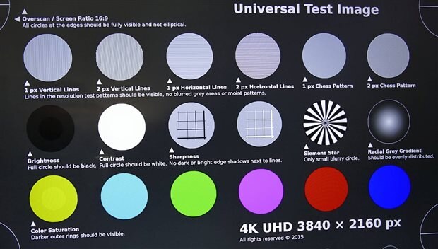

This shot is a 4K test pattern to see if the TV can display every pixel of a 4K image.
Note that it displays 2 pixel lines okay, but single pixel lines show aliasing artifacts. You will need to expand the image to see it clearly.
I think I might put this system in a little box so if and when I go shopping for a TV or monitor, I will be able to see how good the resolution really is.

The next crop is just a small corner of the display to show how small text is readable, but not high quality on this TV:

    You might consider taking a video and/or still of some downloadable lens resolution test charts to get a feel for your system resolution. There may even be downloadable 4K test charts. Ed
