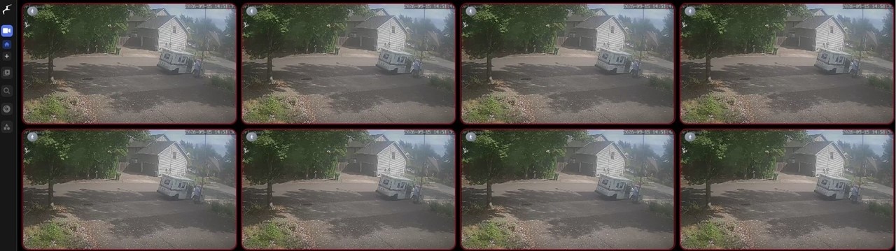

Here is the 8 camera view in Frigate (I am using the same video duplicated 8 times):

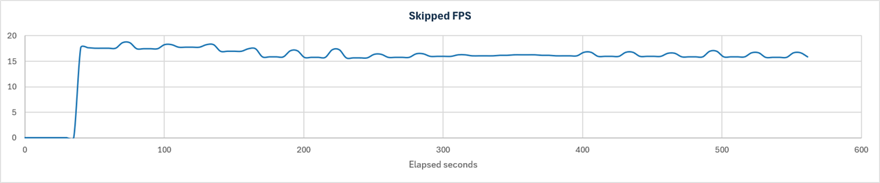

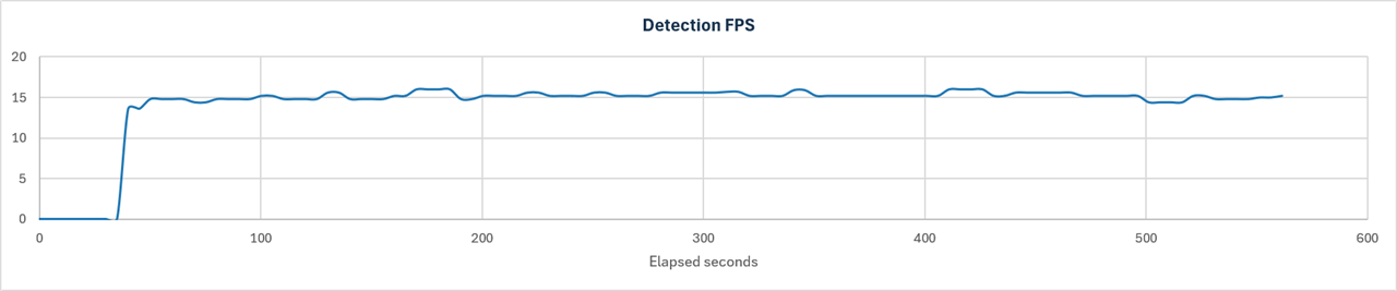

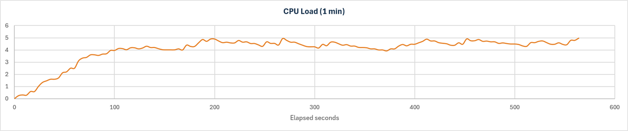

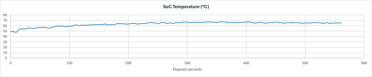

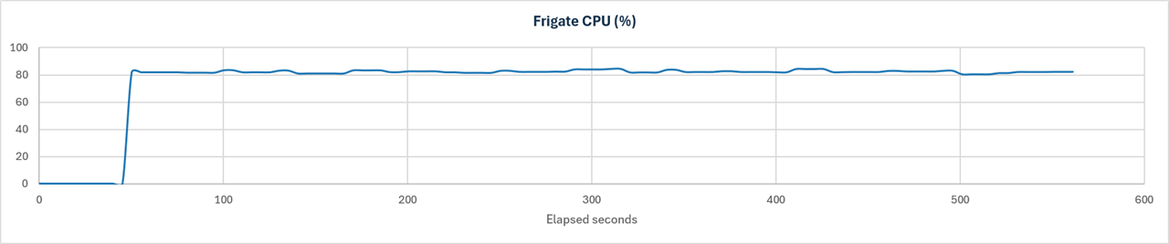

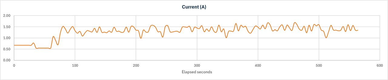

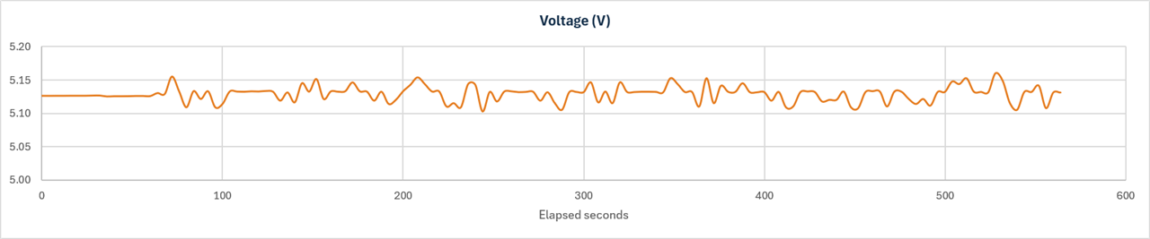

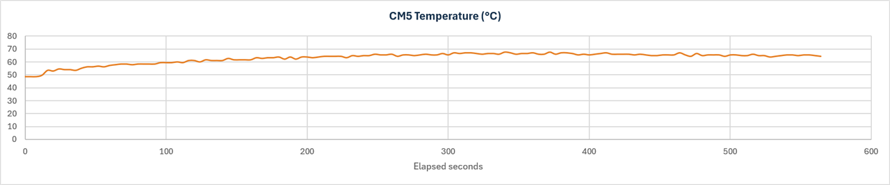

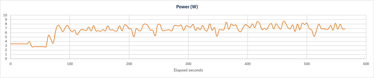

Here is the set of plots from the 4 camera run;
For comparison purposes I took statistics from the middle 5 minutes of each run.

I was surprised that there was not a large increase in power going from 1 camera to 8 cameras.  The Load column represents the 1 minute average load reported from Linux (Frigate plus the OS overhead and background programs).  On a 4 core processor like the CM5, a Load value of 4 represents the full utilization of all the cores.  A value above 4 indicates that some processes are being pushed onto a run queue and are not being executed.  This is an indication of CPU overload and will manifest itself differently depending on what processes are being queued and for how long.  For the 1 camera case, the Load average is 3.22 - the CPU is already highly utilized, so the incremental power increase going to additional cameras doesn't scale.  The max power is about the same for the 2 to 8 camera cases.  But if you look at the max Load, it has increased significantly for the 8 camera case and delays are very visible in the Frigate UI and the Detection_FPS shows a 25% decrease.
Next step is to install the Hailo-8L accelerator and run the same benchmarks.  It appears that for CPU detection - even running only 2 cameras might cause intermittent issues.
