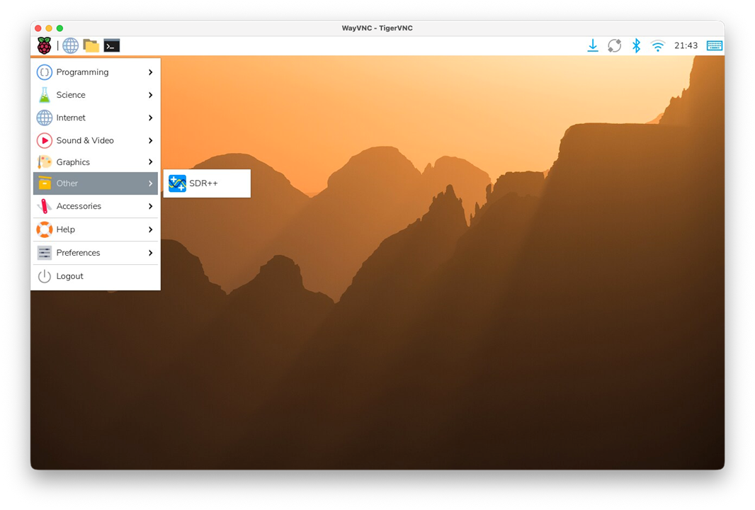

sudo make install
SDR++ was installed as a native application, including the main executable, libraries, plugins, band plans, themes and icons. So, unlike the first attempt with the precompiled package, I now had a working SDR++ installation on the CM5. It even was added to the Raspberry Pi OS 'Other' Menu.

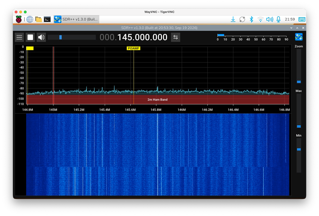

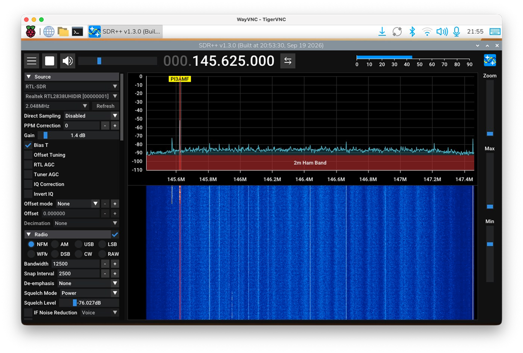

First tests with the RTL-SDR
The first and most important test was with the RTL-SDR. This worked very well. SDR++ started normally, the RTL-SDR was recognised and I could use the CM5 as an SDR receiver without any obvious problems.
This is probably the most interesting result of this part of the RoadTest. The CM5 has no problem running a modern SDR application such as SDR++, while simultaneously driving the 1280 × 800 display. The combination makes for a surprisingly capable little SDR platform.
