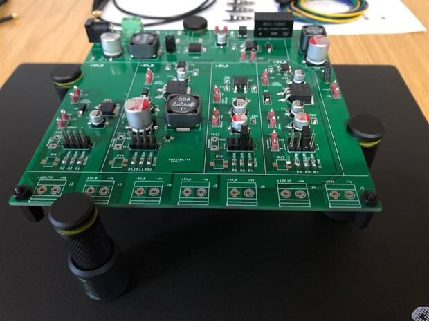

Being metal, the magnetic PCB holders can be placed on top to securely position a PCB.
PCB Holders

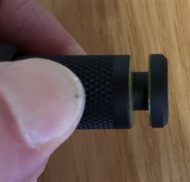

The kit has 4 PCB holders machined from aluminium.  Each requires 2 insulating washers to be fitted, which can be a bit fiddly and I can image that anyone with fat fingers will struggle a little to position them.  The posts are spring-loaded: pull the top shaft down, insert the PCB edge and let go.  The springs are strong and there is no danger of the PCB being accidentally released.  The insulating washers are required as the holder grabs into 4mm from the edge if inserted fully.
{gallery} PCB Holders
PCB Holders: Four, in black anodised milled aluminium.  Really nice.
PCB  Holder: Pull back on the spring-loaded shaft to open the holder.  Maximum thickness of the board is 6mm.  The spring is strong and will grab the board firmly and securely.
PCB Holder: Grabbing the board.  The base of each holder is magnetic and sticks firmly to the base plate.  However, the posts are very smooth on the bottom and can easily be slid around the plate to reposition the PCB without removing first.

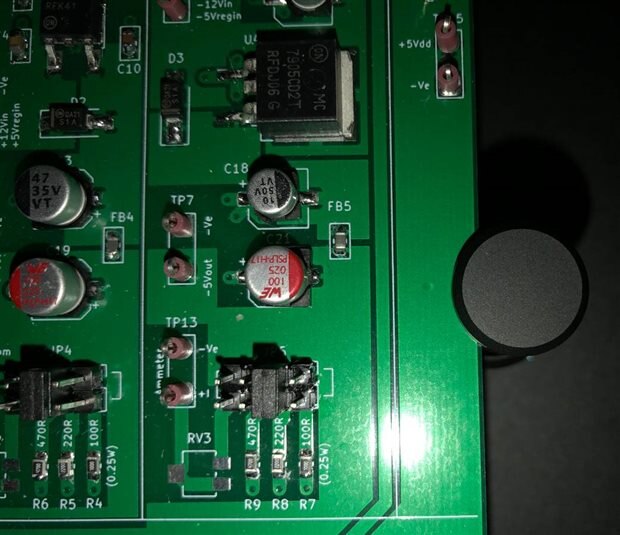

PCB  Holder: This grabs on to approximately 4mm of the board.  You will need to find a suitable position clear of components - you could see that the test points towards the top of the image would prevent that part of the board being used.  I think grip would be compromised somewhat if the board wasn't fully inserted into the holder.

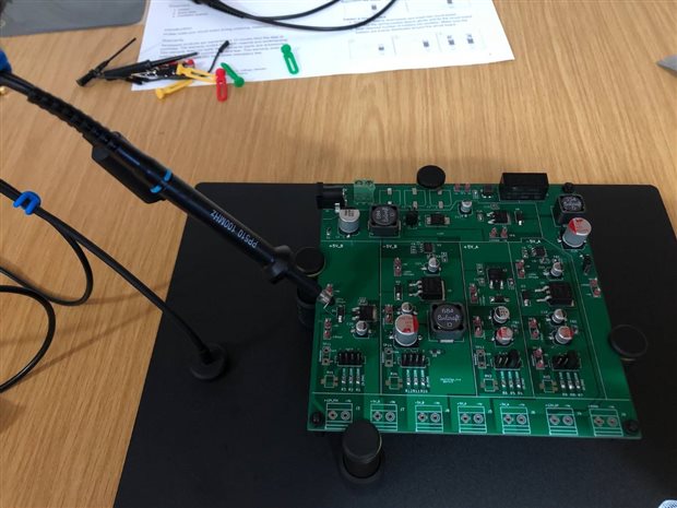

SP10: The probe tip is a very sharp, standard pogo pin (spear point, 30degrees) and 1 spare is provided - the existing pin can be pulled out with fingers or pliers (no doubt lakes of blood will ensue if you try your fingers!)  The dupont leads connect to the pins which are both connected to the probe pin.  The probe head screws onto the probe holder with the silver body.
SP10: Other side.
SP10: Attached to the banana plugs and the probe holder.  I've attached both leads to the pins but this wouldn't work in practice - the black lead should be connected to the ground of the DUT.  Alternatively two instruments could be connected to the probe head.
SP10 on Board: The probe head is positioned where needed, here on a SOIC IC.  Despite its flexibility and lack of resistance, the probe holder easily holds the probe in place with no difficulty.  It's own weight prevents it slipping or pulling away.
SP10 on Pin: Here's a close up of the probe on one of the SOIC pins.  The spring action of the pogo pin and weight of the holder keeps it in place.
Two SP10s on Pins: The probes are held stably enough that two can easily be placed next to each other on pins.
These probes are only suitable for measurements below 10MHz although with a logic analyser they will allow for decoding up to 25MHz.  I measured the resistance of the pin to either connector as 0.08ohms.  Whilst there is a replacement pin I wouldn't be surprised if it gets lost!  These appear to be standard 0.5mm diameter, 30 degree spear tips, similar to these Product LinkProduct Link (actually, this one is a 45degree point); basically, P-50-B-xxxx pins which are 16mm long and 0.5mm point and 0.68mm shaft.  From what I can find, they are readily available from lots of places.

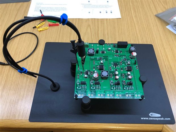

SP200: Kit contents.  The probe head (with spare pin, not shown); an adjustment screwdriver; two different length dupont connectors for the mini-grabber which are used for a ground connection; cable ties of different colours; a probe holder as described earlier; and a cable with BNC connector at one end and a push-fit plug at the other end.  The probe head has the dupont male connector and probe lead push-fit socket just behind the ground-connected shield.  Note that there are also two pads on the head to which an alternative ground connector could be soldered (carefully.)  I assume that's to provide a smaller ground loop for measurements - I think one concern with these probes is the inductive ground loop caused by the leads and mini-grabber and I would have thought SensePeek would have provided an alternative ground connector.
SP200: probe connected up.  The probe head screws into the probe holder as described above; the scope lead plugs into the brass socket.

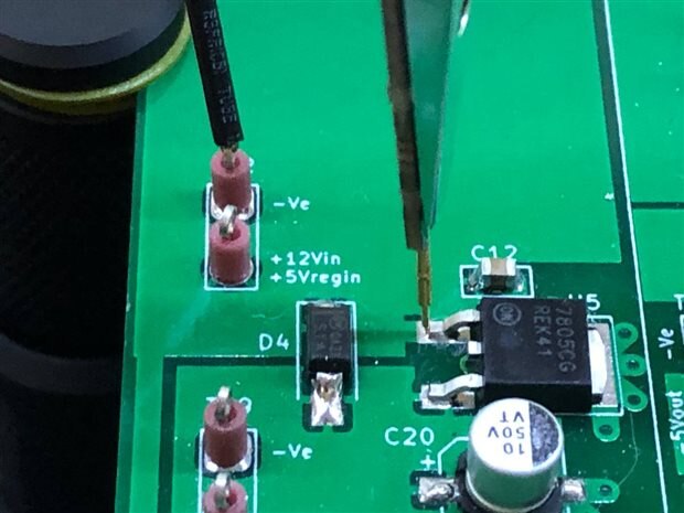

SP200: As before, the holder keeps the probe very steady when attached to the board.  The ties keep the cables tidy with colour identification.
SP200: As with the SP10 Probes, the sharp point makes a good connection to pins and is steady under its own weight.  The ground connection needs to be connected through the mini-grabber to a suitable point.
Alternate Probe: It's possible to use a different probe with the holder.  I found the positioning more difficult, possibly because the probe holder weight tends to drag and the blunt point of the probe doesn't 'stick'.  I did find that keeping a shallow angle to the board helped.  It does show how well the SP200 probe head with holder works though.

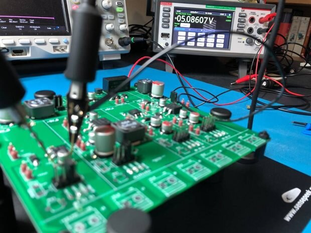

Taking a DMM Measurement - 1: Here, two SP10 probes are measuring across a capacitor with leads to the Keithley DMM in the background
Taking a DMM Measurement - 2: Which gives a good reading.

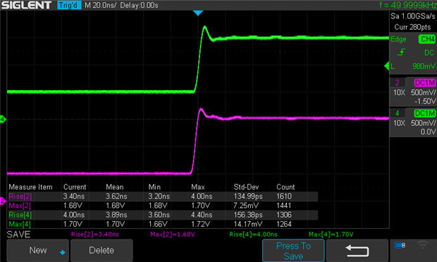

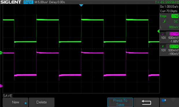

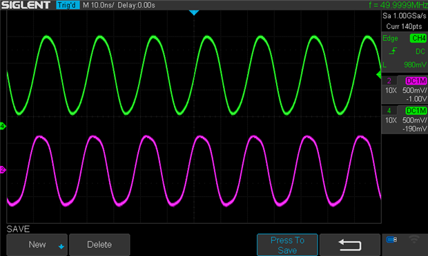

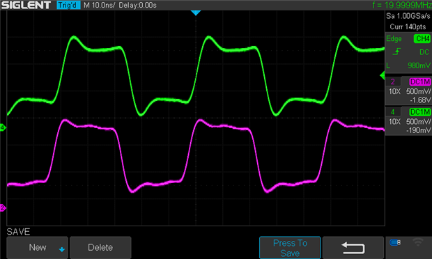

In the following images, I'm checking how well the SP200 can resolve a square wave across various frequencies.  Channel 2, purple, is the SP200 and Channel 4, green, is the Siglent PP510
{gallery} Square Wave Measurement
50MHz: My AWG isn't great at this frequency.  However the signals are very similar; if you use your imagination the SP200 is slightly flatter at the peaks and troughs.
20MHz: Here we're getting at least a recognisable square wave out of the AWG.  Again the SP200 is better
100kHz: Definitely square, with over- and undershoot on both probes.
50kHz: No improvement so lets look at those over- and undershoots
50kHz Overshoot: the SP200 resolves the waveform somewhat better than the PP510.  The rise time is affected by the scope's capabilities.
50kHz Undershoot: Again, the SP200 is better than the PP510
