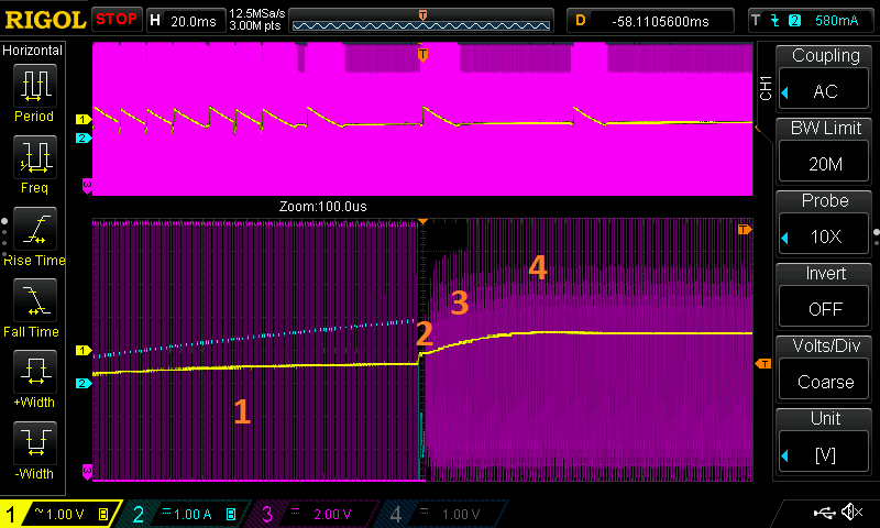

One feature that I did not test in the first blog is the overvoltage protection, but I'm going to cover it now. In my arsenal I have another servo, but this is an "old style one", designed to be powered up directly by batteries and not by a switching converter. The key difference is that this one, during pwm off periods and maybe even during braking, turns into a generator and pushes back current into the power supply! It can then overcharge output capacitors, making easy for me to evaluate overvoltage protection on the BD9G500EFJ-LA.
imageYellow: AC coupled output voltage. Blue: output current
This image shows what I just anticipated: if you push back current into the output, it will inevitably rise. Here, it went up to 7V. Quite a brutal test!
Overvoltage behavior. Yellow: Output channel. Blue: output current. Pink: switching node.
A closer look to an overvoltage event. Notice that the current (blue channel) goes negative., this means that the DUT is pushing back charge
The BD9G500EFJ-LA behavior during an overvoltage event is not that easy to explain, but I hope these images will serve me well. We can define four different phases:
  1. normal operation: the output current is positive and the BD9G500EFJ-LA is regulating just fine
  2. current inversion/overvoltage event: the BD9G500EFJ-LA completely stops switching for a brief period
  3. 100ns discharge mos: the BD9G500EFJ-LA start "pulsing" for 100ns the inductor to ground
  4. overvoltage discharge: after a predefined number of cycles, the discharge mos pulse duration goes up to 400ns
This behavior matches quite well (except for the "zone 2", which I did not find mentioned) to the datasheet description.  On this topic, remain only one thing to disclose: what is all that signal in zone 3 and 4 if the BD9G500EFJ-LA is only switching the discharge mos?

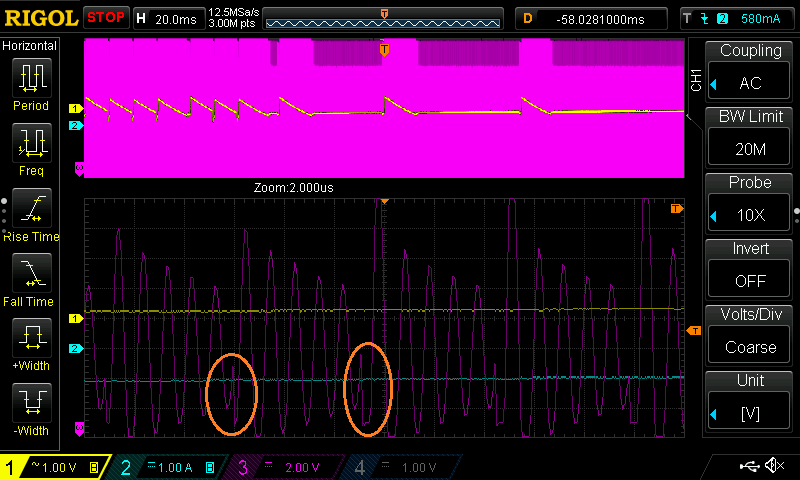

imageA closer look to transition between zone "3" and "4". Yellow: Output channel. Blue: output current. Pink: switching node.
It's ringing! Here we can clearly see pulses from the discharge mos (the first highlighted pulse duration is 100ns, while the next one is 400ns). The discharge mos, when on, briefly charges up the inductor and when the mos is turned off, the inductor resonates with the rest of the circuit. Parasitics resistance is not enough to effectively dissipate this energy so the ringing keeps going until the next "discharge pulse", when some more energy is fed into the inductor.
In this particular case, a snubber circuit would be beneficial to help the overvoltage discharge function dissipate more energy.
