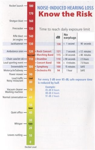

Here is a chart that puts sound levels and their damage potential in perspective:

    dougw over 7 years ago in reply to genebren +3
    Good point Gene. Chronic prolonged exposure to loud sound will definitely damage hearing even though when measured as a pressure loud sounds seem to be very low pressure. For example a .357 magnum gunshot…
    Good point Gene. Chronic prolonged exposure to loud sound will definitely damage hearing even though when measured as a pressure loud sounds seem to be very low pressure. For example a .357 magnum gunshot is about 164 dB, but is still significantly less than 1 psi of overpressure (170 dB). Sounds at this level and above are definitely of concern for hearing damage, but only very specialized (very expensive) microphones will operate at these levels. I will add an interesting list of sounds to the blog to put it in perspective.
