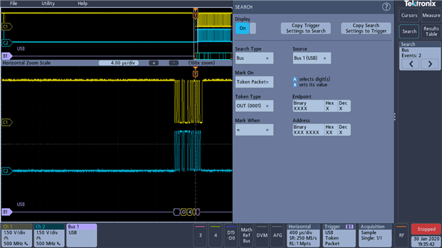

There are three USB signals available on the demo board, low, full and high speed signals. Only the FS signal has a demonstration setup on the oscilloscope and although trying, it was the only one I was able to capture. Only the 1 GHz bandwidth version of the 3 Series MDO has the ability to capture the high speed USB signal.
{gallery} USB Bus Signal Capture Setup
Channel 1 vertical settings
Channel 2 vertical settings
Bus settings for Full Speed USB
Time base settings for Full Speed USB
Trigger settings for Full Speed USB
Data acquisition settings for Full Speed USB
Event Search Settings for Full Speed USB
The signal is triggered on an 'Out' token event, however, it doesn't look like I have actually captured and displayed the token on the screenshot, unless it is displayed as the 'O' block preceding the '4'.
Opening the results table and expanding the view shows the capture of the 'Out' token.
