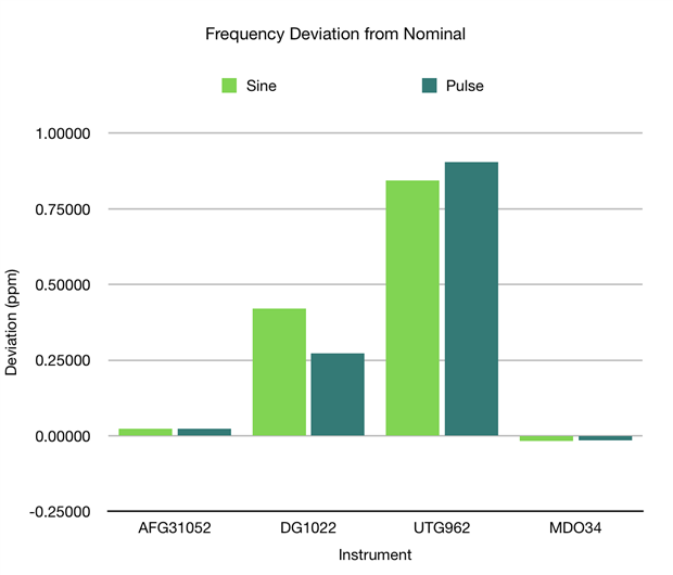

Frequency verification
This test is directly from the Tektronix manual. As the clock is shared between both output channels, the test is only conducted on Channel 1 and only at one frequency of 1 MHz. The measurement is made for both a sine and a square wave. The results can be seen below, the expected readings are from the specifications for the AFG31052.

Apart from the 3404A, all the instruments are extremely close to the nominal 1 MHz output. Both the Tektronix instruments have the lowest number of outliers that fall outside of the 6 standard deviation limits. The MDO34 does have the highest frequency span though. The other three instruments have the majority of their data outside the statistical limits of the AFG31052, indicating that their output is not as stable as the Tektronix instrument.
Converting this data into deviation from the nominal 1 MHz value, in ppm format gives the following table.
It is clear to see that the 3404A cannot meet up to the specifications of the AFG31052, but all of the other generators are well within the deviation tolerance. The data can be plotted for better visualisation with the 3404A omitted from the plot to avoid minimising the rest of the data. Both Tektronix instruments are seen to have a similar deviation, followed by the DG1022 and finally the UTG962 at around 0.9 ppm deviation.
As stated previously, the instruments are left to warm-up before taking the measurements. For the AFG31052, I collected readings just after switch on and then after warm-up to see what the difference would be. A summary of the data can be seen below. The main point is that the spread of the frequency measurements is reduced after the instrument has warmed up. The overall number of outliers, falling outside the 6 standard deviation limits, had improved by just under 5%, although this is seen as a reduction in the upper band as the lower band saw more outliers after warm-up.
This lower spread of frequency data can be seen in the histogram plots above. Both plotted to the same X axis scale, the histogram on the right is seen to be narrower. Both histograms follow a standard bell curve distribution.
To aid with instrument warm-up, the AFG31052 has a builtin timer that can be activated from the utility menu. When activated, a 20 minute countdown timer is displayed along with the option to abort the countdown if desired.
