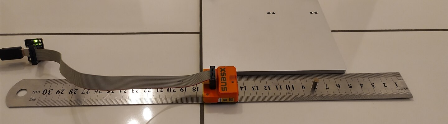

Compass Calibration in Magnetically challenging environments
In the previous test I tested the consistency of calibration (to my best abilities) in a magnetically interference-free environment. In the real-world, a lot of the times it isn't possible to find such a location to mount the device/compass. This is where the calibration feature really needs to shine by calibrating out the deviations due to soft/hard iron effects. So, the setup for this experiment will be similar, except that I will add some magnets to the MTi's environment to act as magnetic sources. Note that these sources will move with the MTi device (a.k.a "Soft iron" and "Hard iron" distortion sources).

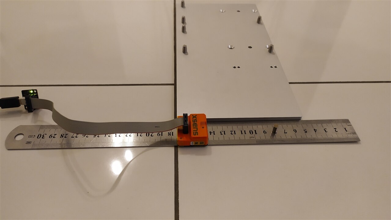

For this test, I needed to mount the MTi device to something that was ferrous, and I could align the module to it, while it being small enough that I would be able to move it around for magnetic calibration. After looking at various items I had lying around, I finally chose a 30cm metallic measuring scale. This was made of ferrous steel material, which I confirmed by sticking a magnet to it. I also could see the "Mag Norm" value change by ~0.5 when the MTi was brought next to it, which gave me a good indication that this is a decent choice for a soft-iron mount. I fixed the device to it using 5mm wide Kapton tape, while keeping the edges aligned (to my best abilities).
I had also procured two small but very strong rare earth magnets to add to this setup and simulate different "hard iron" distortion situations by sticking these to the metallic scale at different random locations. In this way, the magnets moved WITH the MTi device during calibration and afterwards. In all cases, I made sure (using the Mag Norm live value reported by MT Manager) that I wasn't mounting the magnets so close that the magnetic values should start to clip, while still close enough to give very strong distortion to the MTi's magnetometers.
The full setup, including the magnets, can be seen below. The magnets are stacked at the 8cm mark. The Aluminum plate serves as orientation reference surface.
Of-course I had to lift the MTi device with the metal scale and rotate/orient it in different directions when performing calibration and return to the reference location to measure reference heading after the calibration.
Below are screenshots from the Magnetic Field Mapper application during the tests.
Calibrating with the device attached to ferrous metal scale:
Calibrating with the device attached to ferrous metal scale AND magnets attached to the scale:
The offset in the data as well as the oval-ness can be very clearly observed. These are due to the soft/hard iron distortions introduced by our setup. In general, soft Iron distortions shift the center of the data away from the origin, while hard iron distortions change the data shape from sphere to more of a rugby shape. You can compare the below images with the previous case when no major distortions were present (first experiment).
Here are the "Advanced results" for the case with magnets attached. Notice the shape of data before and after calibration (top-left).
And finally, here are the results from my tests:
Test Conditions Heading at Reference orientation - No Calibration Heading at Reference orientation- After Calibration
Initial value (No calibration done, no ferrous/magnetic materials around) 59.6 N/A
Mounted on Metallic scale - no magnets 21.9 87.3
Mounted on Metallic scale + magnets 10cm away in one direction 72.0 86.3
Mounted on Metallic scale + magnets 10cm away in opposite directions 38.1 88.3
Mounted on Metallic scale + Magnets 7cm away in opposite directions -40.3 87.1
One thing I want to mention is that it was relatively harder to move the device in all the orientations due to size and shape of the metallic scale I had mounted the MTi device on. This may (or may not) have had some detrimental effect on the calibration accuracy.
Conclusions:
1. If we look at the values after calibration, we can see variation of up to 2 degrees between the different cases. This is certainly more than what we got in the previous experiment, when the environment was more magnetically neutral. However, if we compare the calibrated values with the uncalibrated values, then we really start to see what a HUGE difference a good compass calibration makes. The variation in uncalibrated heading values is more than 100 degrees across the different use cases. The calibration seems to be bringing it to within 1-2 degrees of accuracy, which is two-orders-of-magnitude better! I was quite impressed after seeing this comparison. It also might be possible to improve the calibration results further with some more experience (I noticed the post-correction distribution for my data didn't follow the bell curve too well - something that was suggested in the documentation). Also, I did try to cause as much interference with the strong magnets as I could, while still staying outside the clipping range of magnetometers.
2. The test results show very clearly that if we're using the Magnetometers for a North-reference heading output, we must calibrate the Magnetometers using Magnetic Field Mapper (Application or SDK) for decent results!
