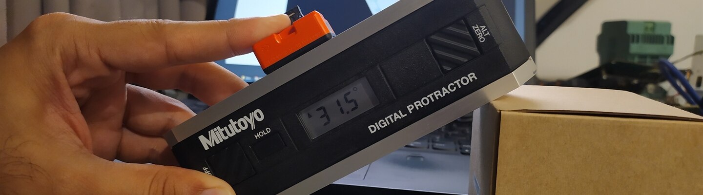

The MTi-680 module comes factory calibrated. The first thing I want to test is test how accurate the factory calibration is. For this test, I am using a Mitutoyo Pro-3600 Inclinometer as reference, which boasts an accuracy of ~0.1 degrees. Before performing the tests, I recalibrated the Mitutoyo inclinometer by following the procedure prescribed by the manufacturer in the manual. I have used this instrument in the past to test and compare some accelerometers for commercial work and know that it works well. However, this setup can only be used for static measurements and so I will not attempt to measure dynamic accuracy.
The setup was quite simple. The Mitutoyo inclinometer has a flat machined top surface that is a reference surface. The MTi-680 has a flat top surface. I used these two surfaces lightly pressed against each other to align the MT-680 module with the inclinometer. I also aligned one side-surface of the MTi-680 module with the side surface of inclinometer top using a machined flat piece of aluminum. This was to make sure the module axes (tilt/roll) were aligned with the inclinometer measurement axis while taking measurements.The MTi-680's specifications say it should be accurate in roll, pitch to 0.2 degrees (RMS).
For doing these tests, I had to take the MTi-680 off the development kit and used it standalone using the USB-UART cable provided with the kit (I am very glad it came included!). I also had to change the mounting orientation of the module since I am using the top flat surface as the bottom surface. This was done in MT Manager's "Device Settings" window. It took me some time to figure out how to do this. The way I eventually did it can be found in my forum post.
/products/manufacturers/xsens/f/forum/51841/specifying-mti-680-orientation-in-mt-manager
My final setup looked like this:
The results I obtained:
Mitutoyo Roll Angle MTi-680 Roll angle
0.16 0.3
3.08 3.0
19.3 19.4
24.3 24.4
29.2 29.1
45.6 45.7
89.8 90.0
Mitutoyo Pitch Angle MTi-680 Pitch angle
0.24 0.0
3.19 3.0
11.9 11.8
15.2 15.0
30.7 30.8
32.4 32.5
43.7 43.7
89.6 89.4
I did notice that when moving to a new roll angle, while the MTi reading was immediately accurate to < ~0.4 degrees, I had to wait ~10s for it to settle down to its final value which is what I recorded in the table above (and which was closer to the value on the Mitutoyo inclinometer). I think this has to do with the parameters of the filters inside the MTi-680 (I was using default). Another filter could have shown slightly different behavior.
Another thing I noticed that, since for this experiment I was pressing the module to the Inclinometer's surface with my fingers, it seemed to matter where I had placed my fingers. After some trying, I concluded that pressing at the 3 mounting locations seemed to give the best results. I did find myself wishing the module body was made of machined metal, though.
I also realized while taking the actual readings, that while on the MTi-680 I can see both roll and pitch angles at the same time, the Mitutoyo only displays the angle in one dimension, so there can be some inaccuracies due to the other axis of Mitutoyo not being completely horizontal. Interestingly, I worked around this by looking at the reading of the other angle (the one I was not measuring) from MTi-680 and making sure it was very close to zero. This way I knew the Mitutoyo was also inclined on only the axis I was measuring, since the two devices were held pressed together.
Nevertheless, as far as the final values are concerned, they all look fairly accurate, which seems to confirm that the module was indeed well calibrated before sending it out.
