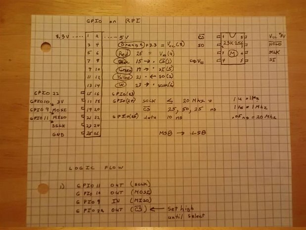

Here are my notes so far. Any comments or issues please let me know. I think I am on the right track.

    I read the recent discussions this morning. It is great to hear everything works fine. Sometimes, a simple test for SPI master is to link MOSI and MISO lines together and see if the data I sent comes back on the receive side. If this doesn't work either it is time for Logic Analyzer or oscilloscope ... image

    I'm glad it's working - how fast are you running the spi clock and how long are the wires ?
    Any chance of a picture ?

    Well guess what...
    I decided to pull everything and remount changing colored wires and new positions and the thing is working! image So cannot tell what is wrong!?! I have a few bit flips, but that may be timing or something. But progress is being made. Thanks for the help. Next is a code rewrite/cleanup because so much extra stuff

    Well I am stuck again, but this time I think software. I can program using python, but nothing gets stored(?) and the chip does not respond (0XFF) ! If I unplug the chip's +3 volts, all responses are 0X00... I am too close to this to figure it out. Ask me questions to send me on the right track.

    With the pullup resistor on HOLD, I can boot RPi with power to SPI memory. Thanks @bbolo1 ! image image image
