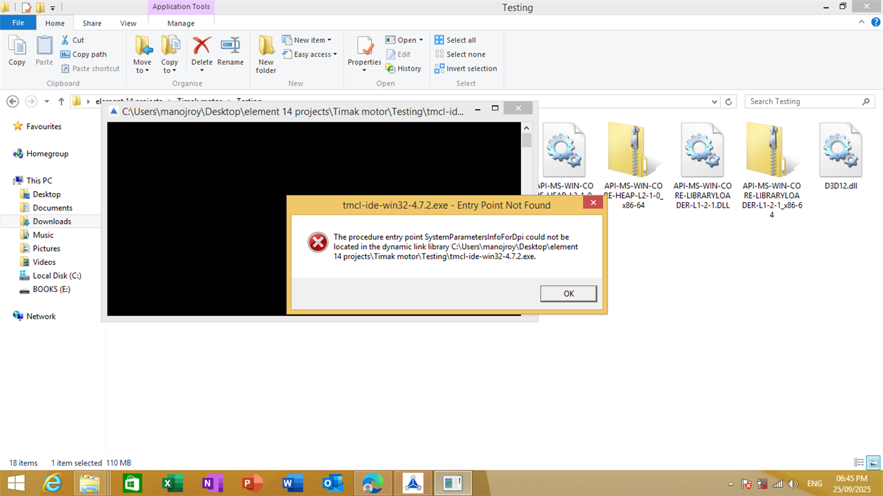

I am trying to install TMCL-IDE for windows. I am getting this error. Please help me in solving it.

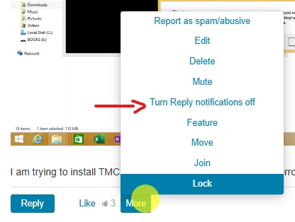

    manneveru said: This is not right forum for this post This post is relating to a RoadTest and its consequent review, it's the correct place for it to be situated. You can turn off replies to the thread…

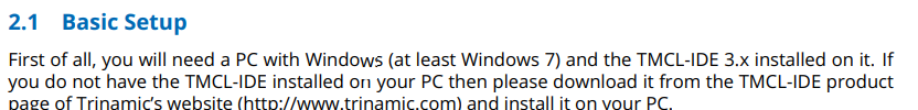

    https://www.analog.com/media/en/technical-documentation/user-guides/how-to-start-linux-tmcl-ide.pdf

    (Are you on a windows 32 operating system?
    If yes,) is your OS version on the supported list for the software?
    Asking, because this is a Windows API function that's missing.

    Does it behave differently if you run it "as an administrator" ?

  • manojroy123
    manojroy123 5 months ago in reply to cstanton
    Yes. It is showing same error.

  • hlipka
    hlipka 5 months ago in reply to cstanton
    Hmm, it says 'TMCL-IDE (Win32)', not sure whether this runs under a 64bit Windows...
  • hlipka
    hlipka 5 months ago in reply to hlipka
    but from what I found when looking for 'SystemParametersInfoForDpi' is that it needs a relatively new Win10.
