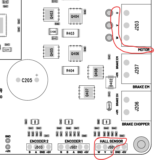

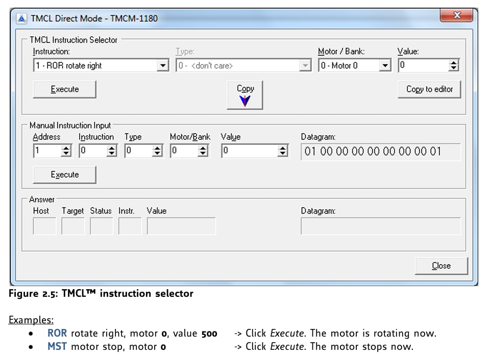

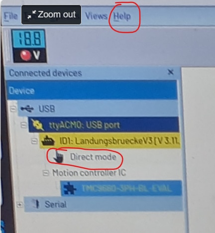

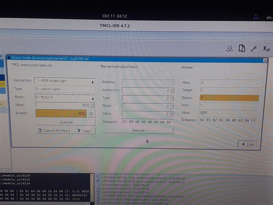

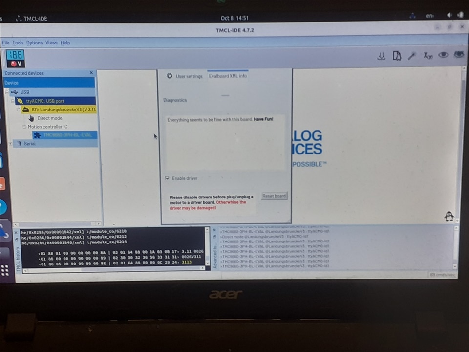

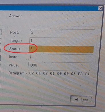

Most of the problem with the software and driver board are solved. I was even able to get fault LED on driver board OFF. I am not able to start the motor. Can someone Please guide me in starting the motor.

    Yes, but it will be hard to see if the signal is a trapezoidal wave.
    Do you have an oscilloscope?

    Perhaps also check the motor configuration parameters against the specification of the motor in use.
    e.g. if the motor current is set too low then the motor may not run.

    How to check if trapezoidal wave is being generated or not.

    Depends if you mean UVW phases of the motor or UVW of the feedback hall sensor.
    Perhaps include a schematic and photograph of you RoadTest setup along with motor details.

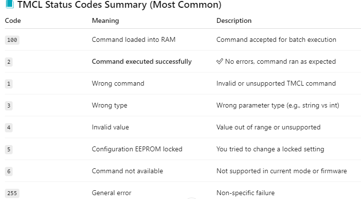

    Perhaps also check the documentation for what the status code returned means
