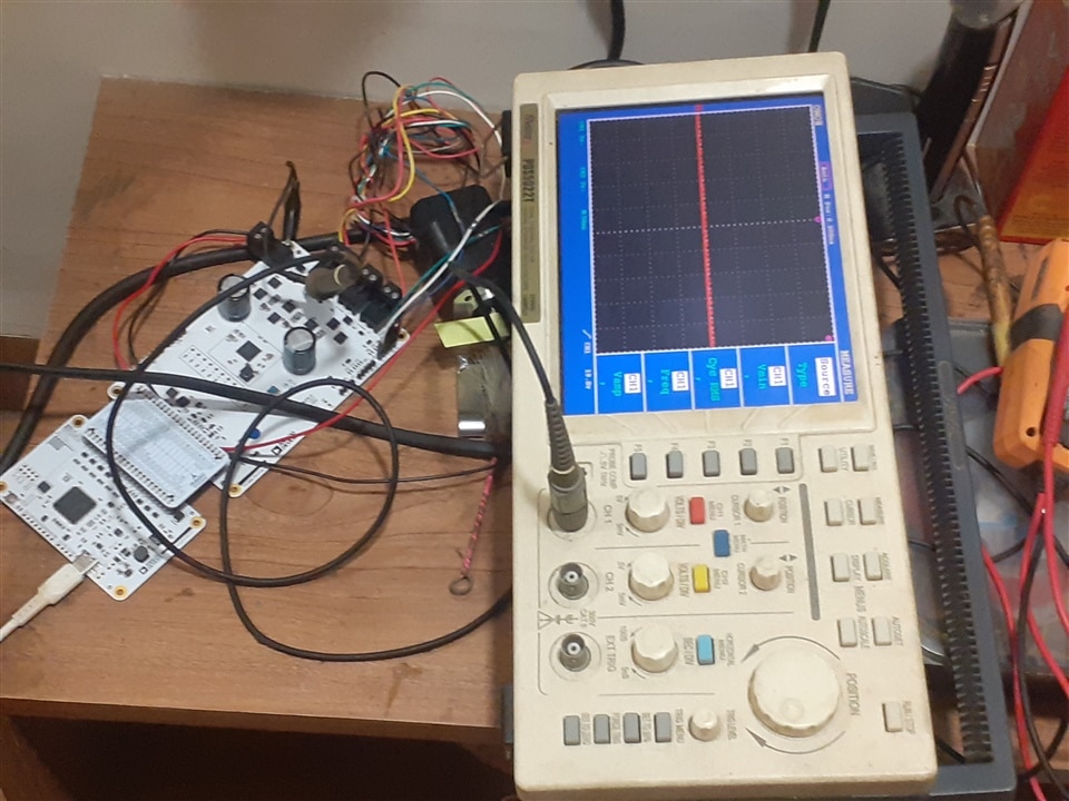

Can someone please share me detail on how to see trapezoidal wave in TMC9660 driver board using osciloscope.

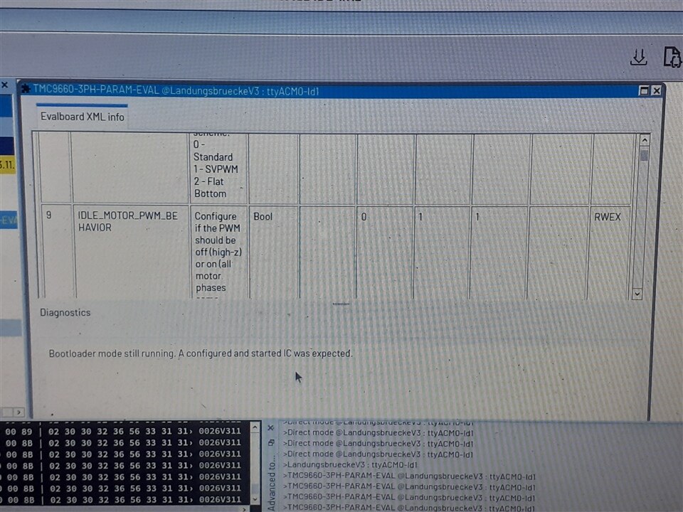

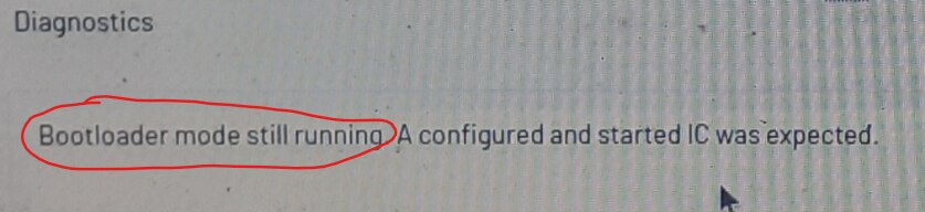

    Looks like it is still in bootloader mode.
    Perhaps try using the separate UBLTools app to configure the bootloader.

    'Copy to TMCL editor' button is inactive Direct mode dialog

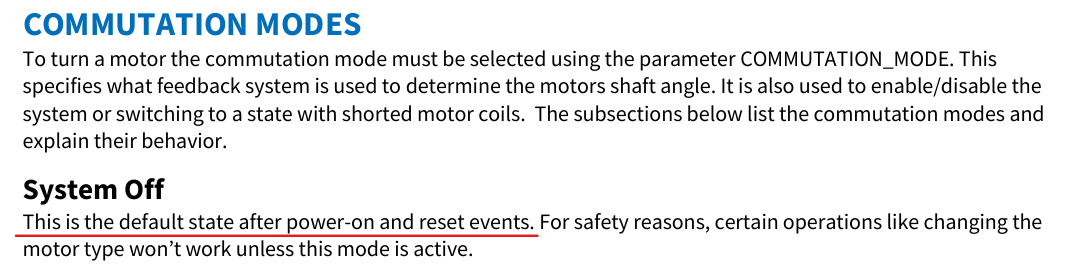

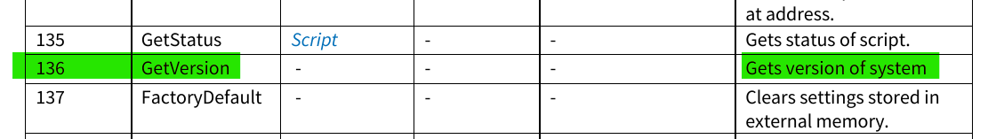

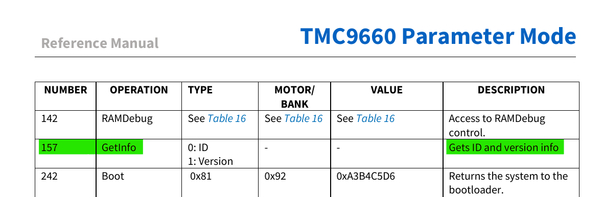

    Ok, that may be due to the 'commutation mode' defaulting to 'system off' after a reset.
    https://community.element14.com/products/roadtest/f/forum/56270/wan-t-to-know-how-to-test-for-trapezoidal-wave-in-tmc9660-using-osclloscope/231276
    Perhaps try sending it a status request like GetVersion or GetInfo using the TMCL protocol and see if you get a sensible response back from it.
    If so, then you can start using param mode commands to configure the motor board and get the motor turning.

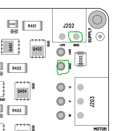

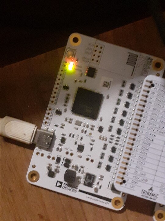

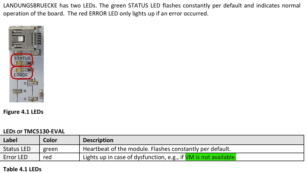

    Is the error LED on the interface board still lit, with a valid VM displayed on the TMCL-IDE ?
  • manojroy123
    0 manojroy123 over 1 year ago in reply to beacon_dave
    How to configure bootloader. VM voltage is displayed on the TMCL-IDE
