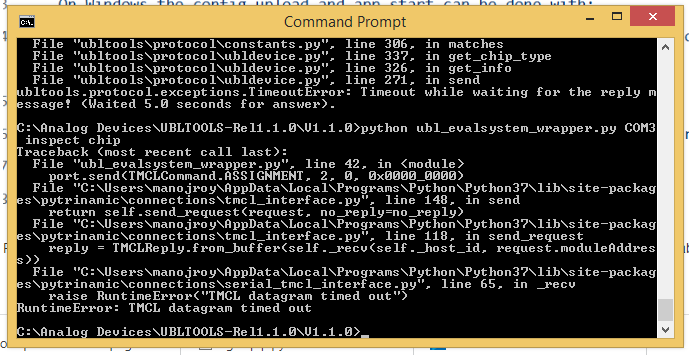

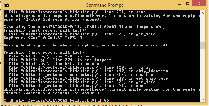

how to solve this error for UBL tool in windows 8.1 pro
manojroy123
manojroy123 over 1 year ago

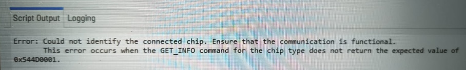

How to solve the above UBL error.

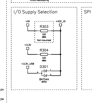

  • jc2048
    0 jc2048 over 1 year ago in reply to beacon_dave

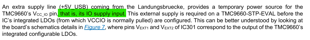

    "I'm guessing that up until now that has been 5V from the USB via the Landungsbruecke interface ?"
    No. This is doing the selection on the TMC9660 board for the +VCC_IO
    So it comes set for +3V3, derived from the internal buck if the motor supply is there, or +3V3 derived from the USB supply from the application processor board if not. (There's a linear regulator on the TMC9660 board to take the +5_USB down to +3.3V_USB.)
  • beacon_dave
    0 beacon_dave over 1 year ago in reply to manojroy123
    You've already done that back here:
    https://community.element14.com/products/roadtest/f/forum/56322/how-to-solve-this-error-for-ubl-tool-in-windows-8-1-pro/231436

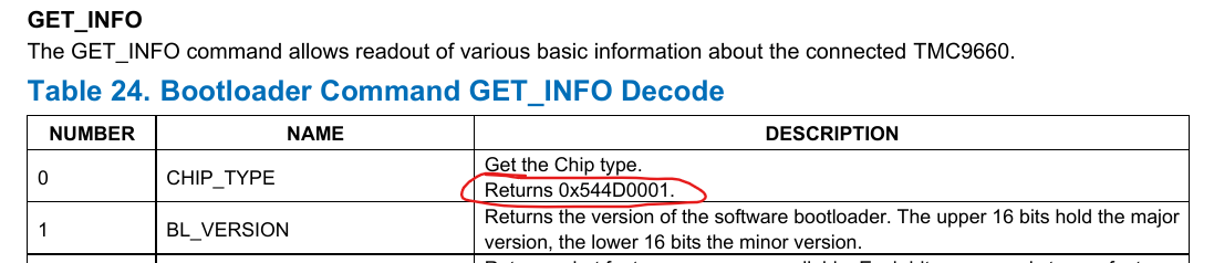

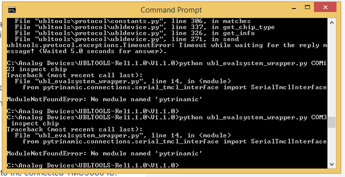

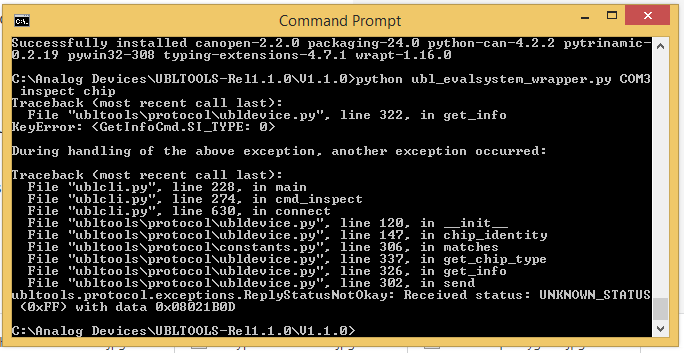

    The problem is that it appears to be getting an unrecognised response back when it is expecting the device ID value.
    You could perhaps try the standard fault-finding stuff like:
    • snoop the COM port to see what data is being sent/received
    • check any driver configuration settings on the virtual COM port in Device Manager
    • look at the Python code to see what it is doing where the error occurs

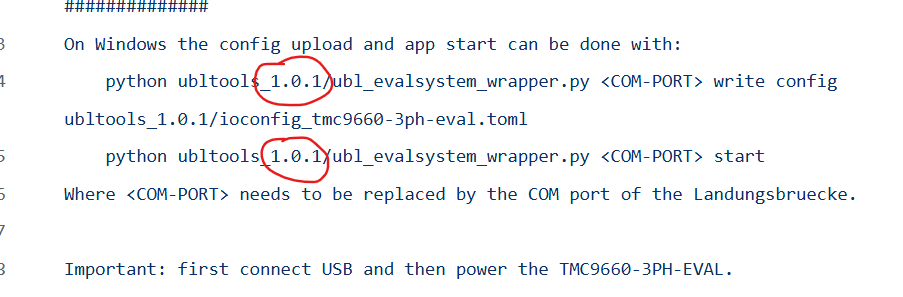

    • try rolling back, the PyTrimamic code example used ubltools_1.0.1
    • try re-flashing the firmware
    • try rolling back the firmware
    • try getting it up-and-running on an up-to-date and supported OS first
  • beacon_dave
    0 beacon_dave over 1 year ago in reply to Jan Cumps
  • manojroy123
    0 manojroy123 over 1 year ago in reply to beacon_dave
    How to do it using the microcontroller board provided from TMC-9660-3PH-EVAL using python wrapper.

  • beacon_dave

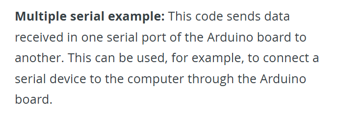

    It's probably easier with an UNO but perhaps take a look at the Multiple Serial Example in the Arduino language reference.
    Hint: you will probably want to use the .write() function rather than the .print() function shown in the example.
  • manojroy123
    Yes, I have arduino mkr wifi 1010. will it work.
  • beacon_dave

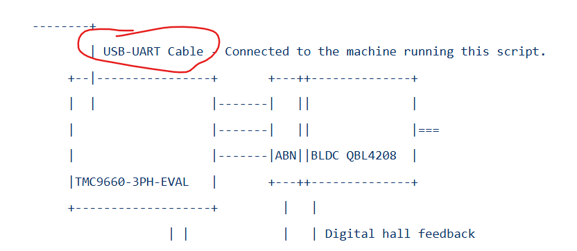

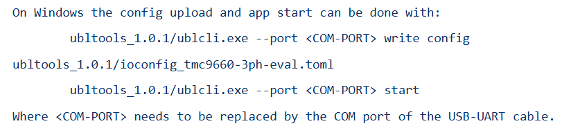

    You need to use the Python wrapper if you are connecting via the Landungsbruecke interface.
    If you have a serial UART you can bypass the Landungsbruecke interface and go direct to the TMC-9660-3PH-EVAL motor controller board. (This temporarily removes the Landungsbruecke and wrapper from the equation in order to configure the bootloader)
    If you have an Arduino you may be able to use that as a USB to UART.
  • manojroy123
    I am using the microcontroller board that is provided by the TMC-9660-3PH-EVAL to perform that operation. I don't have USB to UART serial cable.
  • beacon_dave
    Is that with a USB-UART serial cable direct to the EVAL board bypassing the Landungsbruecke board ?

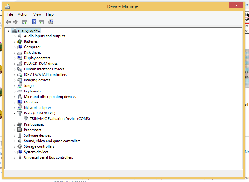

    Is the UART cable still using COM3 and showing up ok in Device Manager ?
    Is your UART set at the correct BAUD rate etc for the EVAL board ?
    Is Tx/Rx wired the correct way around ? Tx -> Rx / Rx <- Tx
