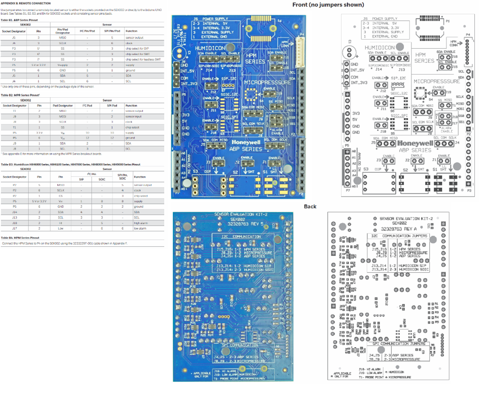

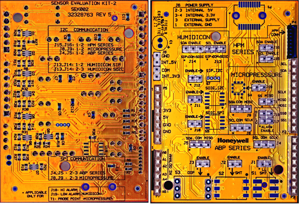

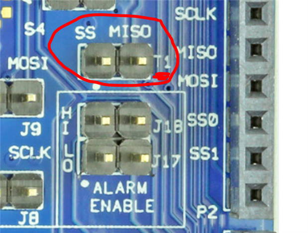

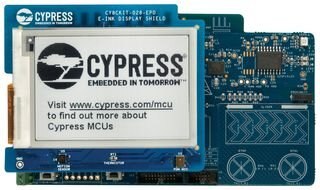

    Please could you check with Honeywell which pin is used as the select pin for the SPI sensors on the SEK002 kit. Documentation not clear. Images in documentation show an SS0 (Arduino pin 10) and an SS1 (Arduino pin 9). Reason being is that the PSoC 6 EPD Display Shield uses Arduino pin 10 as its SSEL pin.

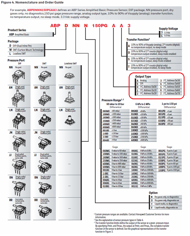

    Then wanted to check product codes and descriptions before ordering. Farnell order number 2773682 is listed as a differential sensor (ABPLANT015PD2A5) even though it is described as a single axial barbed sensor, which matches image. I always assumed that differential sensors require two ports.
    Also, order number 2490463 is listed as a gauge sensor (ABPDRRT005PG2A5) and has two ports.

    The pinouts on the SEK002:
    I think, its not so a big problem.
    The device name code includes which interface the device has.
    So for the both of your selected sensors ABPLANT015PD2A5 and  ABPDRRT005PG2A5ABPDRRT005PG2A5 they has an I2C interface with the address at 0x28

    Now I have received the circuit diagram, which I would like to post here as well.
    Now you can set the jumper settings correctly.
