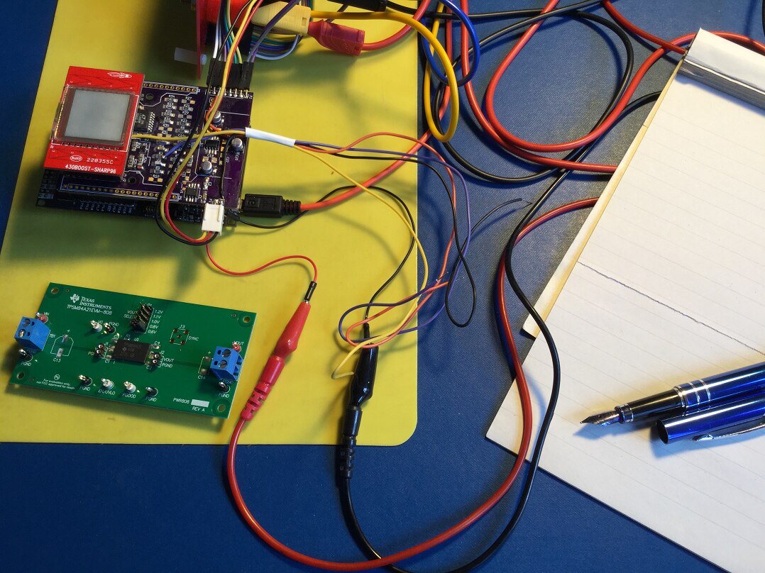

  • no, nothing is running warm on the board.
    There's not much else besides the IC. Just some configuration resistors that don't draw significant current.

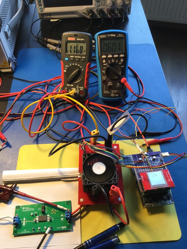

  • With 1.3W power dissipation - is anything besides the actual chip getting warm?
  • for no particular reason, a scope capture of the device switching 12 V DC to 1.2V, 5 amps:
    7.56 Watt in, 6.20 Watt out. The package still less than lukewarm after half an hour.
    Yellow is input close to the package, blue is the output. No external capacitors used.

  •   wrote:
    Firstly I like your crock clips...
    They are for low current only - very thin wire. Here they just have to feed  12 V into the DC load.
    I've been testing the kit this afternoon, at 0.6 V 1.5 A, with 12 V as input. Only to see if my setup was correct.
    The amazing thing is that there's no inductor or capacitor on the PCB. Except for a few resistors to select functionality and voltage, all is within the switcher package.
