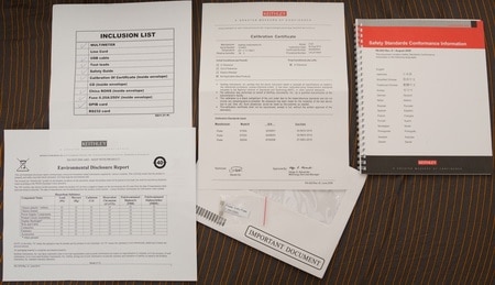

An inclusions list which has multimeter, USB cable, test leads, safety guide, certificate of calibration, China ROHS, Fuse 0.25A/250V and GPIB card ticked. Unticked were Line Cord, CD, and RS232 card. As far as I know, there is no RS232 option for this meter. There is no CD nor a printed manual, but this isn't a problem as all of the software is available from Keithley's website after a quick registration process.
There is also a one-page leaflet which tells us about the Unicable probes which are included - a generous 1.2m lead length to allow you to reach from one side of the bench to the other. The USB lead included is about that long as well, an acknowledgement that we don't always have our computers close to our test instruments, and a very welcome inclusion. Well done!

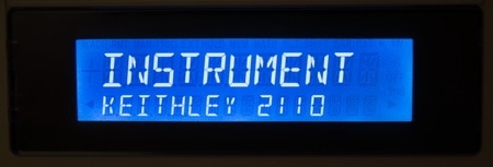

A Firmware Update
Because I had visited Keithley's site for downloads, I had also noticed a firmware update was available with resolves a problem with repeat trigger average filtered ACV/ACI sampling.  It's a sign that the meters are more like computers than ever before - the software on these devices are field upgradable, allowing bugs to be resolved. It's also a sign of Keithley's dedication to support it users by providing updates (whereas prior, you may have had to ship the device in and get the ROM replaced or firmware update applied there, often at some cost to you).
The instructions provided were clear, and the firmware was updated quite quickly - no hassle at all.

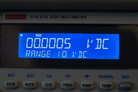

Lets first tackle the accuracy aspect of the meters. It's no secret that anyone who is using their meters for hobby purposes is slack on the calibration. But even with that in mind, the DT-830B has a DCV accuracy of just 0.5% +/- 5 count on most ranges. Let's say we've measured a 3v cell and it's 3.27v displayed - you really only know it's between 3.20v and 3.34v. Paying a little bit more for the QM1548 gets you to 0.5% +/- 1 count - between 3.24v and 3.30v. How many digits did you say your meter was again?
On the other hand, measuring 3.270v in the 10v range on the Keithley 2110 would give us certainty that the voltage is 3.270v +/- 0.012% reading + 0.002% range which works out to be 3.270v +/- 0.0005924v. We're pretty darn sure it's 3.270v.
Don't be fooled by the fact the meter gives you readings in digital form - it often has no relation to how intrinsically accurate the meter is. This can be important when it comes to aligning devices for particular current or voltage levels - say if you build your own current to voltage converters for other measurements or logging activities. In fact, although you shouldn't do this, you could even use this meter to just check whether your other meters are calibrated properly.

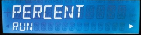

The front panel buttons are two-featured through the use of a shift-modifier key. This isn't too difficult to master, and the most accessed features are accessible without the use of the shift key. The range is alterable through the use of the up-down keys. Pressing each of the keys results in an auditory feedback beep which cannot be disabled and can become annoying after a while.

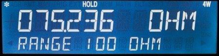

4-wire Measurements - Four wire measurements are available for resistance and RTD temperature. Four wire measurements of ratio or reference to a reference voltage are also easily enabled, however, require an additional set of probe leads which is not included in the package.
For a test, a measurement of the resistance over an F-terminator (nominally 75 Ω) was made with 2-wire mode ...
... and four wire mode with measurement hold (to free my hands to take the photo) ...
... the slight difference in reading is use to the lead resistance, which is effectively negated through the use of four-wire mode.

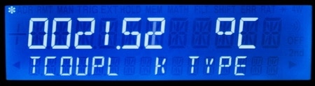

Thermocouple Measurements - The DMM is capable of high accuracy thermocouple temperature measurements with a dedicated thermocouple port on the front panel. Unfortunately, with the "low cost" K-type thermocouples I had on hand, the blade of the +ve terminal was too wide to fit into the socket (which may be designed for their own termocouples) and require some butchering to fit. It does work though! Note that you cannot just stick a few wires into the socket and extend/adapt the thermocouple wire as dissimilar metal junctions can produce a voltage which would introduce error or completely ruin the measurement of the voltage formed at the sensing junction of the thermocouple!

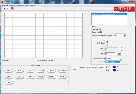

The KI-Tool software detected and accessed the Model 2110 without any necessary configuration, the software offering a "virtual" front panel to the instrument with a chart recorder. There is settings for trigger interval, scale, and readings plotted on the chart.
In this case, I was setting up for one of my later experiments. The design of KI-Tool is a bit lacking, as other important features are buried under the Settings menu.
These settings can be changed, and are applied once Submit is clicked, but the settings are not remembered. I somehow wish these were also visible on the main interface, and profiles could be set up for quick access.
Like-wise, this little gem under Reading Settings allows you to save all measurements to a data-logging record. Forgetting to tick this and starting a measurement will leave you with only the graph visualization - it's a mistake I've done before, so I would have much preferred to have it also on the front page, and maybe accompanied by a big record button.
The software itself has ten recording slots, beyond which, you must delete your data or append to an existing record. Listing the data does take a few seconds - where you can export to CSV for further processing.

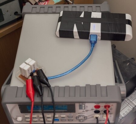

The DMM in action - Exploring the Real Capacity of Rechargeable USB Power Banks
This part is a little bit of a bonus - in fact, it's fairly involved and of interest to many smart-device users that I have posted a more thorough posting on my blog here: http://goughlui.com/?p=4321

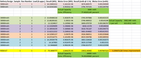

I configured KI-Tool to sample DCV and DCI in dual measure mode, with a configurable ceramic resistor load (5 ohms and 2.5 ohm load). I was going to build and align an active load, but if I can measure both variables at once, it's not as critical. Short alligator to banana clip leads with thick copper wire were used to keep the resistance low.
After many many hours of testing, I was able to come to the conclusion that the 30,000mAh brand-less cheap power banks I have come across on eBay are very fraudulent to the point that I rebuilt a pack. You will have to visit my blog for the full details.
The capacities were calculated using 1.015s per sample (15msec latency) to calculate the watt-seconds per sample, which were summed and divided by 3600 to find Watt-hours, divided by voltage and multiplied by 1000 to find mAh. A figure for meter error based on the x% reading + y% range was calculated for each sample and summed to find the total contribution of error from meter error (naively, it's unlikely to be this much).
The result? The errors from the meter are so small even after multiple hour runs that the lead resistance is probably several magnitudes greater in terms of error contribution. I definitely have confidence in these results.
