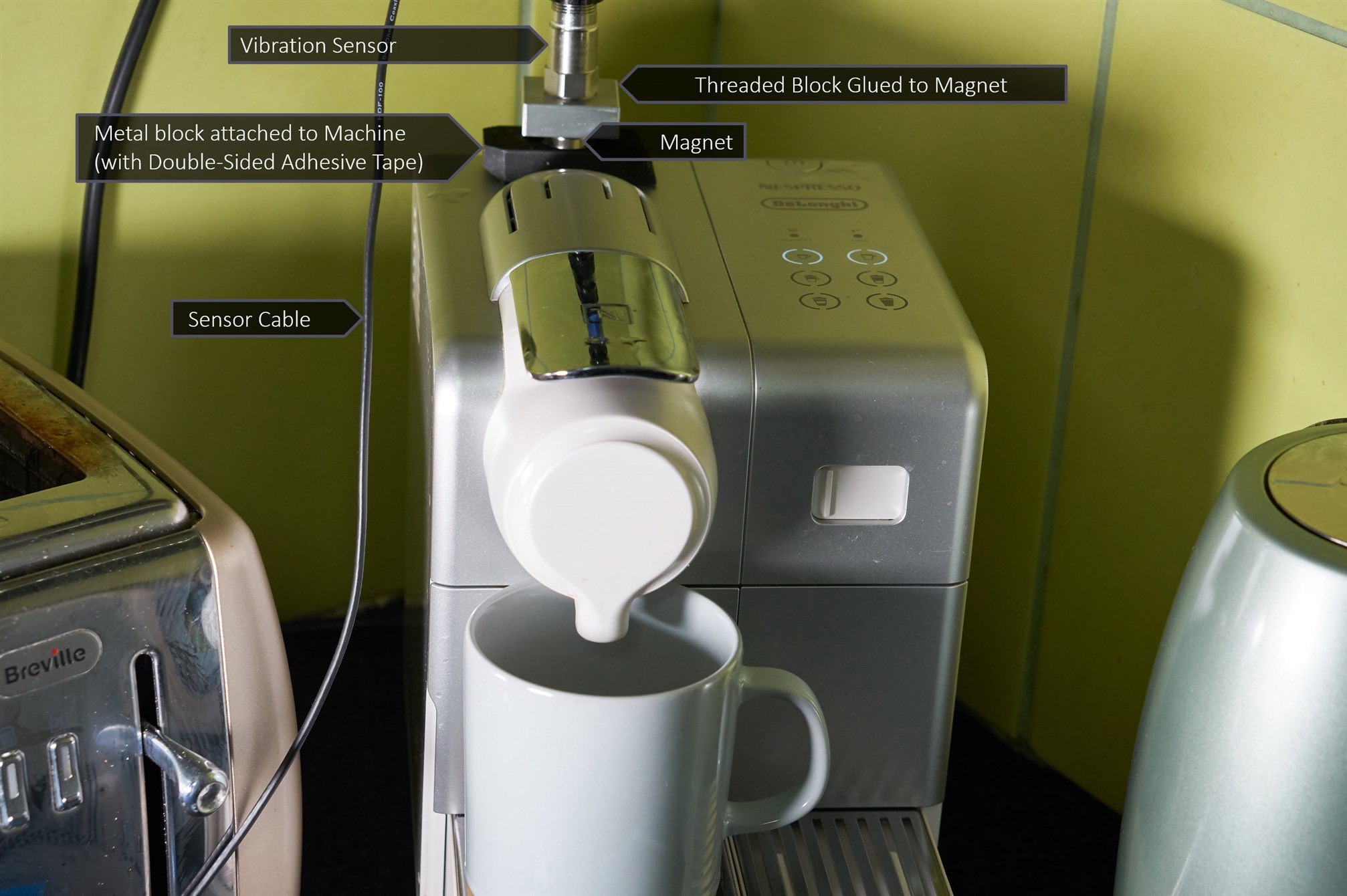

The photo here shows, from left to right, a BNC-to-MIL-C-5015 connector, the accelerometer itself (model 603C01 see the PDF datasheet from IMI Sensors), and a 1/4-28 UNF set screw. The set screw sticks out so it can be used as a stud to attach to the desired machinery.
The accelerometer is powered from an inline constant current source which the Measurement HAT can supply under the control of the Raspberry Pi.
I tapped the required 1/4-28 UNF hole into a block of aluminium, and superglued a magnet onto one side of the block for attaching to metal machines. There are more stringent requirements than this for effective coupling, especially for high-frequency vibrations, and so for a proper machine test in a factory, you'd want to spend more time designing the way to physically connect your machine to the sensor. The sensor PDF Product Manual discusses this in a little more detail.
The constant current source can be switched off if the accelerometer is not used, and the Measurement HAT can then be used with all sorts of other signal sources.

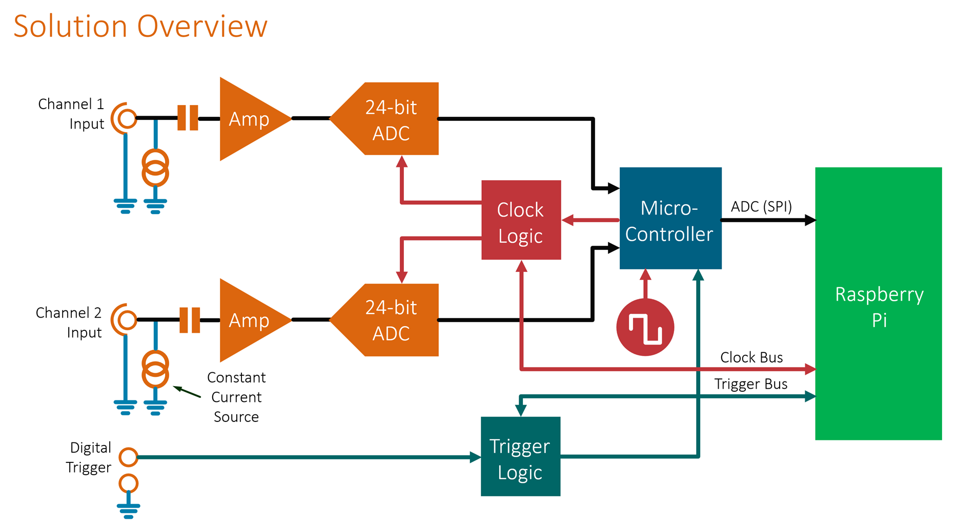

There is a block diagram in the documentation, a simplified view is shown here. Both ADCs sample simultaneously, and the clock and trigger logic can be used to synchronize multiple boards. The constant current source can be switched off. When enabled, it supplies current to power IEPE sensors.

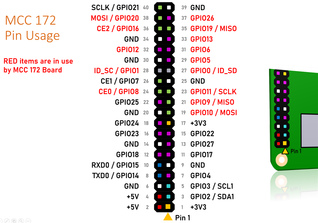

A photo of the board is shown below, and it is possible to decipher some of the main functionality from that.
Underside of the board:
The Raspberry Pi pins used by the board are shown below in red text. Pins with black text are free to use for other purposes. The Measurement HAT can be integrated into solutions with additional Pi-attached hardware.

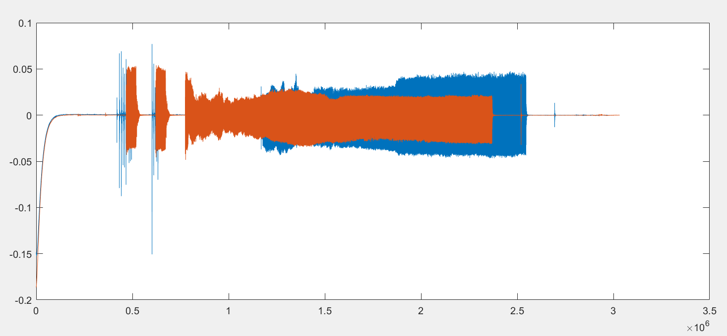

I used this standalone operation mode to test the performance of a coffee machine pre- and post-maintenance. The maintenance operation was descaling!
I didn't know what to expect, but the difference was significant. The chart below shows the time domain view of the vibrations from the pre-maintenance first coffee (blue), and the second coffee (red) which was immediately post-maintenance. There is a difference in the start and stop times, but at least partially it is likely because the water pump took some time to prime itself, and so the absolute time may not align, but the amplitudes are noticeably different. The datasets are on GitHub if anyone wishes to examine them, they are 50 Mbyte CSV files (too large for Excel, although they could be easily split – using the aptly-named split command in Linux for instance).
I used Matlab's Signal Analyzer to examine the frequency domain. In some parts of the spectrum, the vibrations from the second coffee (red) were larger, however at low frequencies, the first coffee (blue) generated larger vibrations, and that has made a significant difference.
The frequency-domain view shown above is zoomed in to a time portion near the beginning of the espresso cycle. The resolution bandwidth is 50 Hz. The view below shows later in the cycle:
A persistence spectrum view from the Signal Analyzer is shown below. It would be nicer to animate this but I've not figured out how to do that yet. With the first coffee, it can be seen how the spectrum changed as the espresso progressed, I arbitrarily annotated three positions in time as A, B, and C for the first coffee. With the second coffee, the difference is less between the stages and more difficult to separate out; an animation would be better here.
I found the persistence view of the spectrum to be highly useful, and I used it throughout the RoadTest as a result.
In summary, it is feasible to make a portable standalone instrument with the Measurement HAT. Another option could be to control the Measurement HAT from a mobile phone (using Bluetooth for instance, since the Pi supports that). The data obtained was very valuable for rapidly providing insight that if machine learning were to be employed for coffee machine descaling operation optimization (obviously less relevant for a consumer machine, but more important for the larger coffee shop machines), then it is immediately apparent which area of the spectrum to focus on so that data is sampled at a more sensible rate for both machine learning and for classification.

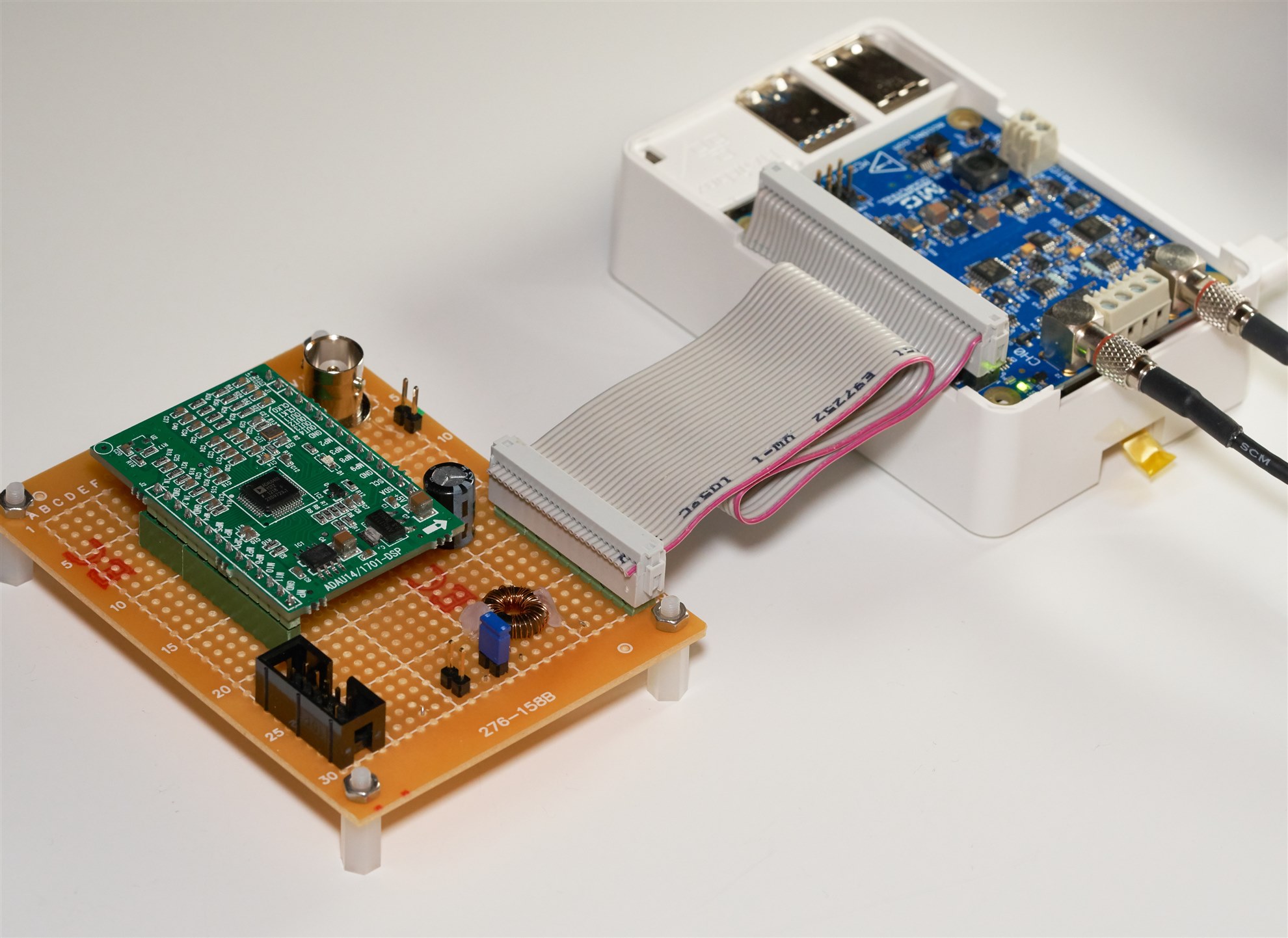

The DSP board can run with a separate Pi, or it can use the same Pi as the Measurement HAT since the HAT has stackable header pins.
To use it is simple; I wrote some code called dspgen (at the GitHub link). If you wish to (say) generate a sine wave signal of frequency 1 kHz, you'd type the following from the Pi command line:

The photo below shows the prototype DSP board that I used (I have not built it on a PCB yet). It communicates to the Pi using I2C (which doesn't clash with the Measurement HAT, which primarily uses the SPI interface). The DSP board powers itself from the Pi.
