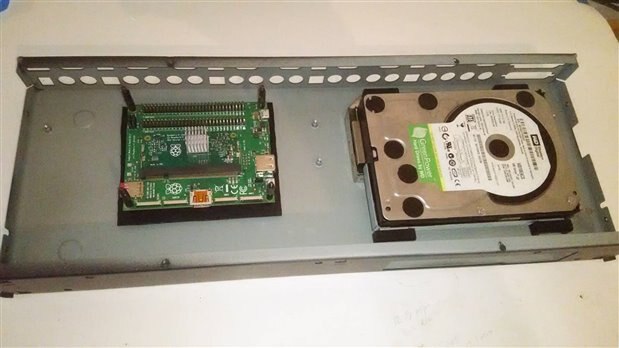

  The CM3L and 1 Tbyte HD in standard sized 19" Rack Mount Caseimage
