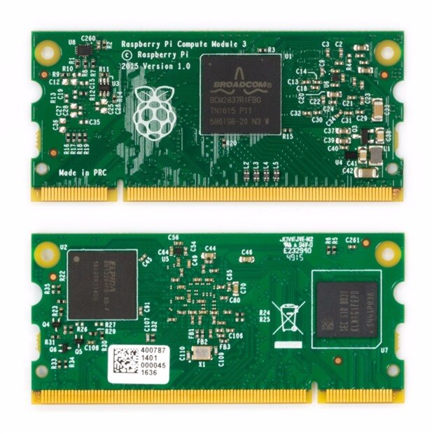

{gallery} Raspberry Pi 3 Compute Module
Compute Module: CM3, CM3 Lite & IO Board
Compute Module: CM3 with onboard eMMC
Compute Module: CM3 Lite without onboard eMMC
Compute Module: IO Board and CM3 modules

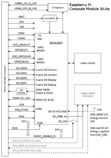

Datasheets and Schematics
You can find all of the documentation that has been released by Raspberry Pi Trading / Raspberry Pi Foundation on their website. The documentation gives a full breakdown of the IO Board, Compute Module(s) along with guides on using the Raspberry Pi Cameras and attaching the Official Display along with software guidance on flashing the eMMC. I have also attached version one of the datasheet to this document, you can find the link at the bottom.
Compatibility and Differences Between CM1, CM3 and CM3 Lite
If you have already produced a design based on the CM1 (Compute Module based on Raspberry Pi 1) then you're in luck, the CM3 (Compute Module base on Raspberry Pi 3) is practically a drop-in replacement so long as you have the appropriate software updated onto the on board storage (eMMC). You also need to take into consideration the new power and thermal requirements, failing to do so will mean that the speed of the CM3 module will be throttled. There is a minor size difference as the CM3 is 1mm higher/longer, this change and other alterations are laid out in the documentation available on the Raspberry Pi Foundation website.
There are few design differences between the modules. The CM1 and CM3 have been made with the intention of using the onboard eMMC (embedded MultiMedia Controller) storage. Between the CM1 and CM3 there has been a practical change in how the HDMI_HPD_N_1V8 (hot plug detection) is accessed, and also EMMC_EN_N_1V8 (which I'm not entirely sure what this is, I'm assuming it's an 'enable' voltage) and these are now via an IO Expander before hitting the SoC. This doesn't make a great deal of a difference to the typical application.
The main difference between the CM3 and CM3 Lite is that the eMMC storage is not populated at all. The layout is still on the PCB, however the pin out of the compute module has changed so that the relevant SD/SDX pins are now broken out onto the 200 pin connector. This allows use of an external microSD/SDCard connector (or potentially an external eMMC storage) such as the one on the IO Board. Going by the documentation, you will need to connect SDX_VDD to a voltage between 1.8v - 5% and 3.3v + 5% at 50mA.

Due to the CM3 using the BCM2837, this means that consideration needs to be made for power consumption and heat dissipation. According to the documentation, VBAT will require more power to the processor when it is under heavy load. For the CM3 module, and CM3 Lite, there are six power supply rails to the module which have to be accommodated for (excluding consideration for SDX_VDD).
- VBAT which feeds SMPS and generates core voltage
  o Min 2.5v
  o Max 5v + 5%
  o 2000mW for CM1, 3500mW for CM3/3L
- 3v3 for processor, i/o and eMMC
  o Min 3.3v - 5%
  o Max 3.3v + 5%
  o 250mA
- 1v8 for processor, i/o and SDRAM
  o Min 1.8v - 5%
  o Max 1.8v + 5%
  o 250mA
- VDAC for TV-Out DAC
  o 2.5v - 5%
  o 2.8v (if DAC used)
  o 3.3v + 5% (if DAC not used)
  o 25mA
- GPIO0-27_VREF for GPIO 0-27
  o 1.8v - 5%
  o 3.3v + 5%
  o 50mA
- GPIO28.45_VREF for GPIO 28-45
  o 1.8v - 5%
  o 3.3v + 5%
  o 50mA
This means that although the CM3 is a drop-in replacement for the CM1, the design ideally needs to be able to supplement the processor with 3500mW. For the benefit of clarity, here are the requirements for if an external eMMC/SDCard/microSD is connected for the CM3 Lite:
- SDX_VDD which powers the SDCard pins
  o 1.8v - 5%
  o 3.3v + 5%
  o 50mA
Also interesting, is that the VDAC, which handles the composite TV-Out, requires a connection of 3.3v if it is not to be used for video output.
