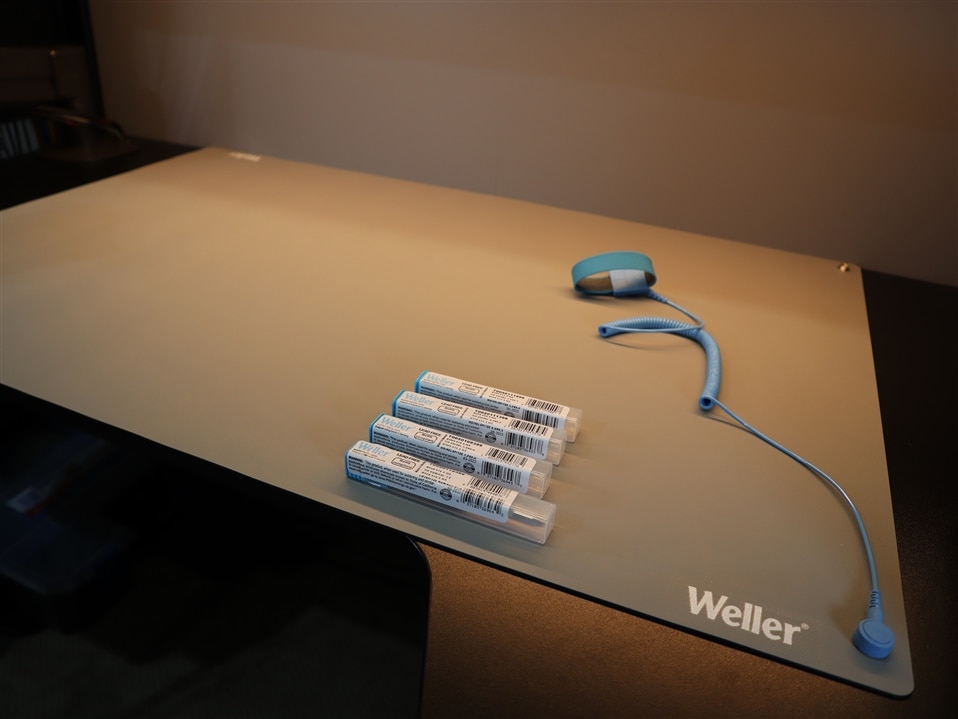

Weller provided a comprehensive WXsmart demonstration kit for this evaluation. I have made an unboxing video (here), which introduces the components and equipment of the kit. Even though I reviewed the expected contents in advance, I was still pleasantly surprised with the kit’s complete and generous assortment of equipment:
In addition to the demo kit, Weller thoughtfully provided additional equipment:

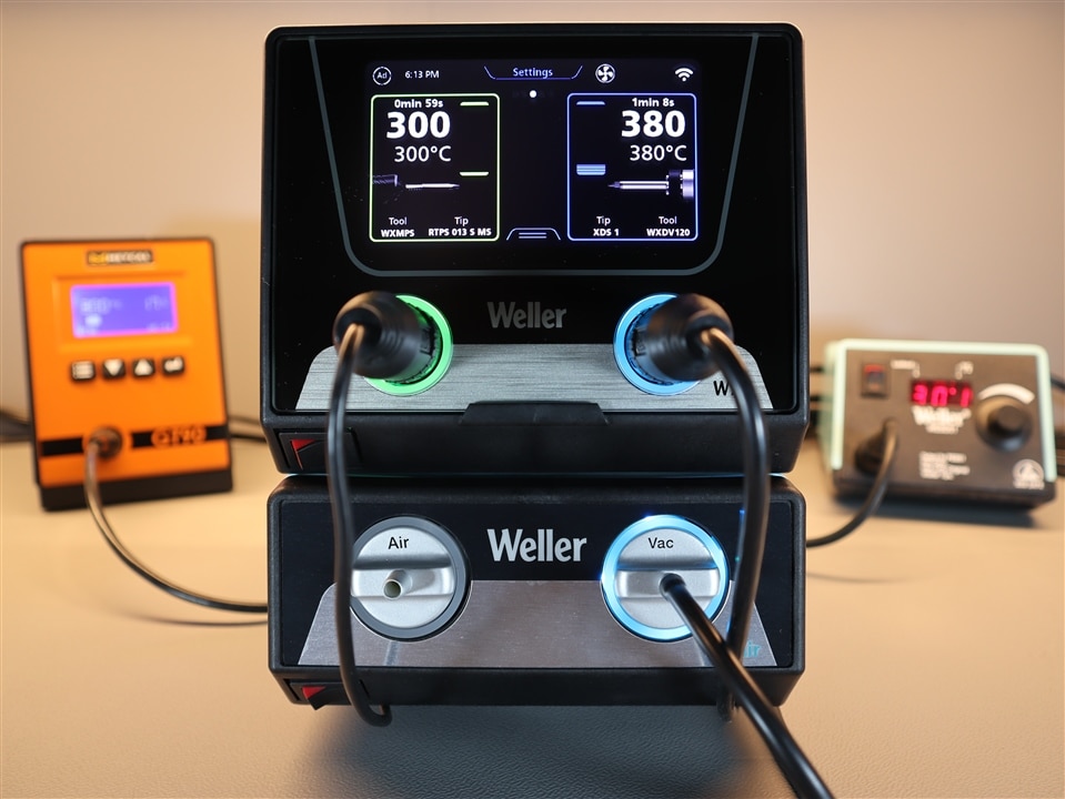

WXsmart Power Unit
WXsmart 300 power unit

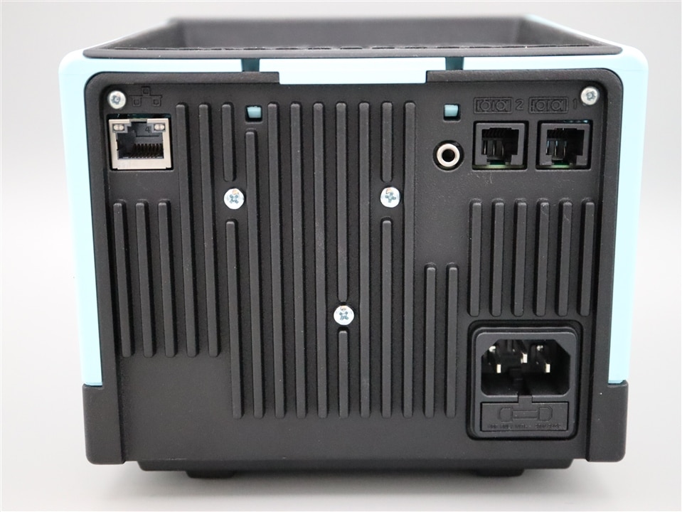

The WXS 300 power unit is the heart of the system and enables intelligent control of all connected devices. Weighing in at nearly 10lbs, this beast is better placed on your bench than in your pocket!
Connectivity is easy, there are two DIN connectors on the front for the hand tools. On the back are female outlets for power, ethernet, a grounding connector and two RJ6 ports that connect serial devices to the WXS 300, importantly the WXair module and the WCU temperature measure/calibration device. Nearly the entire back is a heat sink.

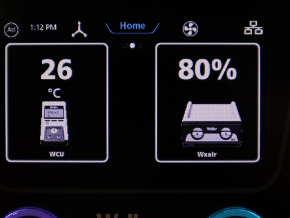

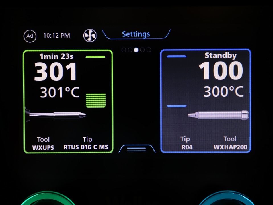

Once on, front and center is the bright 4.3” capacitive TFT color display. The informative display is crisp, nicely set out and responds quickly to a screen press or swipe. The screen is ESD safe and heat resistant for additional protection.
The main display provides status information, it indicates what is connected and provides additional detail for the two devices connected to the front 12-pin DIN ports. Within each colored square matching the tool’s color ring, you can find the current/set temperature, tip model, tool model, picture, and an informative power graph. The irons plug straight in and a twist of the ring locks them in place, though it normally takes two hands for this operation to ensure the arrows are in alignment when plugging the handpiece in.

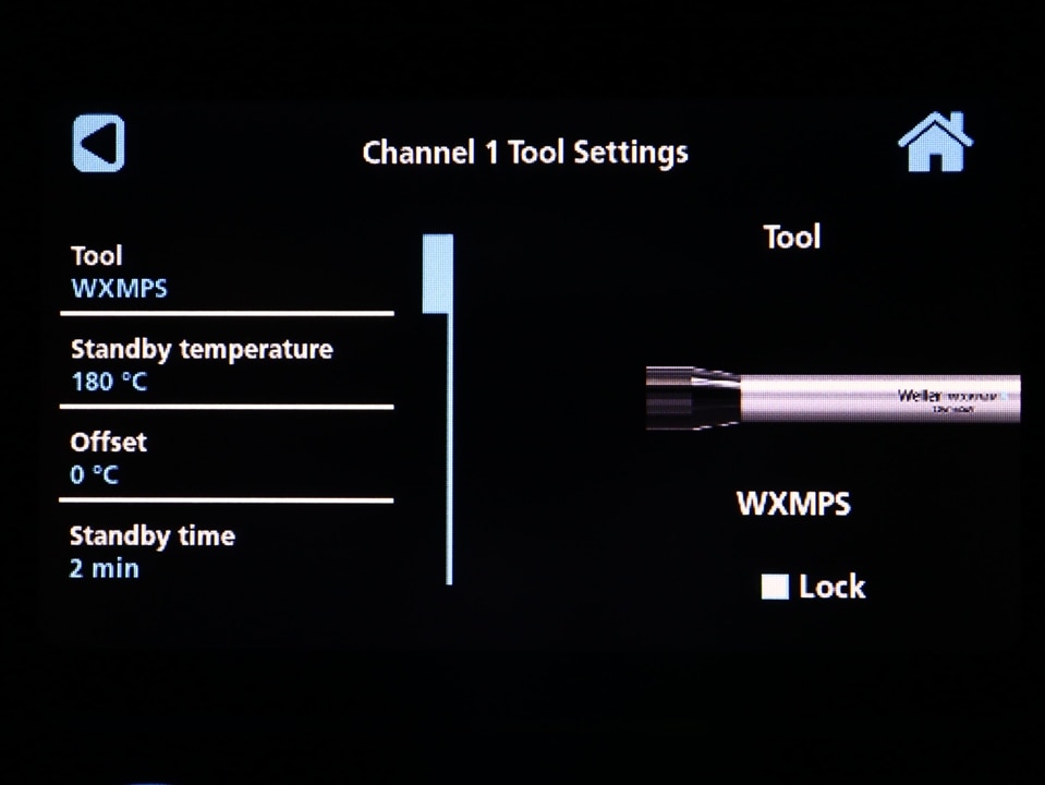

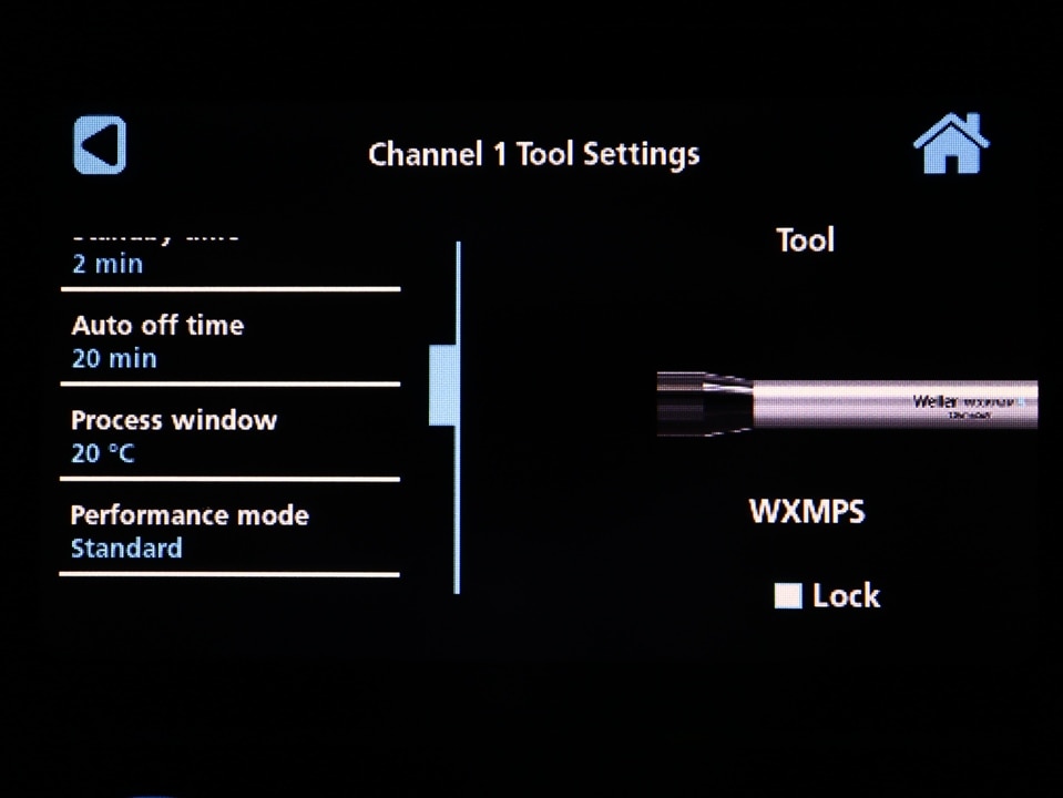

Swiping left will bring up the detailed settings screen for the tool connected to channel one. Here you can adjust the set temperature, select or set a pre-set, or configure the tool and smart tip along with detailed tracking information. Every conceivable detail and setting is available - from offset and standby settings, to drop counters, device color and calibration dates.
Switching handsets or tips dynamically changes the intelligent display and configurations in real-time. For example, connecting the WXHAP air tool changes the displays and presents different options including an adjustment for air value (in %).
The color for the irons can be selected here from a palette of 16, which will change the display for the rings on the iron, the ring surrounding the DIN connector and the channel's square on the control unit display. This choice is saved to the iron so that the color follows as the iron is plugged back in regardless of which channel is used – a handy visual cue. The air tools are always blue, so it is probably best to choose other colors for the two soldering handpieces.

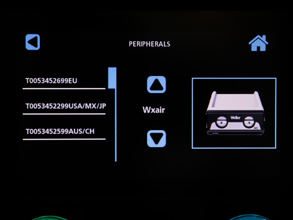

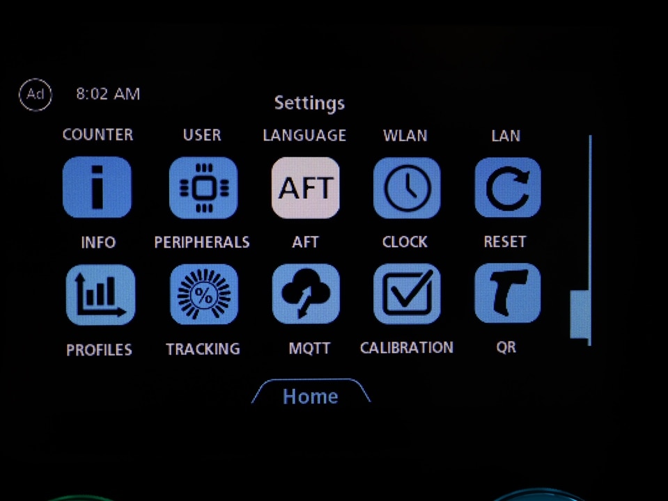

The settings button at the top of the main page opens an expansive menu.
Here you can display or set most of the station's parameters:
Set station-wide settings
Configure tools and tips
Enter new user details and restrictions, or change the active user
Set the language, date, networking and MQTT details
and display information, reset the station and update firmware
With an optional software upgrade, additional controls appear here for temperature/time profiles, solder joint time tracking and to enforce re-calibration intervals. The upgrade also enables QR codes which, with an external scanner, promise to allow rapid reconfiguration of the WXsmart’s settings to suit the task at hand (more on these features later)

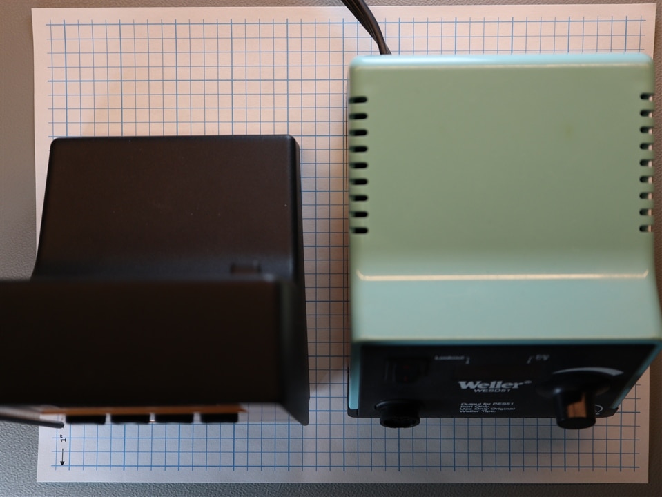

The WXsmart power unit significantly outclasses my comparison power units. The legacy Weller WESD51 offers only temperature control with a single LED display and dial. I previously reviewed the Metcal GT90 (here), which provides basic functions for temperature pre-sets, energy management and administrative control displayed on a 2.5” monochrome LCD. The larger footprint of the WXsmart is understandable - considering it is an all-in-one unit, the footprint is much smaller than four individual units would be.
WXsmart 300 footprintComparison stations footprint
I found the WXsmart power unit to be highly customizable and informative. Every setting I could think of using was readily available. Relevant information is displayed clearly. The Weller WXsmart 300 Power Unit has impressive, expansive capabilities while ensuring complexity is concealed with a presentation that is intuitive and easy-to-use.

Each handpiece stores settings for tool offset, ring color, standby temperature, standby/off times, performance mode (high/normal/low) and motion sensitivity. They also store tracking information specific to the handpiece such as firmware, energy consumed, serial number and calibration dates. These settings follow the handpiece and are not bound to the channel on the station, allowing maximum flexibility during tool changes and configurations.

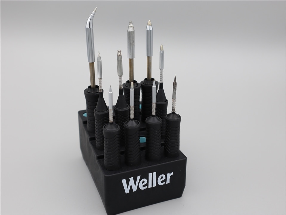

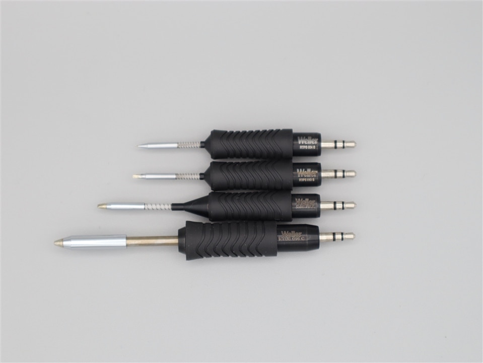

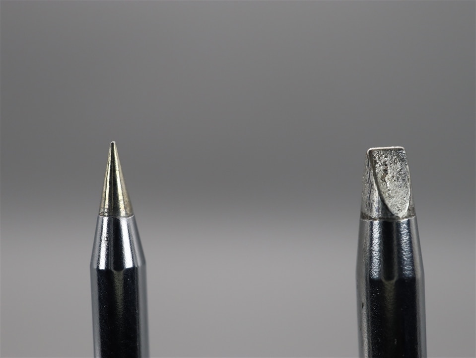

For this review, Weller included a tip stand and a generous choice of smart RT active tips to experiment with, I did tend to favor the RTPS013S and RTMS015S chisel tips for most applications. Like the handpieces, the tips store tip specific information such as solder drop counter, serial number, energy consumed and calibration dates. Combined with the software logging capabilities, full traceability is maintained from iron right down to each individual tip. The setting of a tip offset is stored in the tip which is separate from the one stored on the handpiece. I discovered that during auto calibration with the WCU calibration unit, the tip offset will be automatically configured, and the handpiece offset must be set manually. The tips for the WESD51 and GT90 are simply metal and have no intelligence nor traceability.

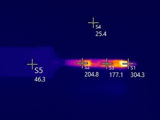

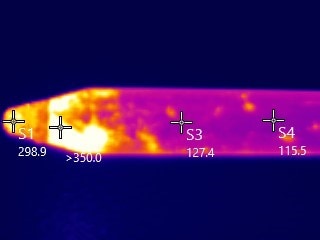

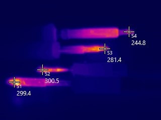

Using a Keysight thermal camera, I was able to capture some close thermal distribution images. In the 3rd image, four irons are displayed - from top to bottom are irons for the: WESD51, GT90, WXMPS, WXUPS.
The WXMPS MS accepts the smaller RTMS (micro) and RTPS (pico) series tips, both types have an exposed coil on the tip shaft. The WXUPS holds the larger RTUS (ultra) tips. Changing tips is fast and easy, simply pull to unplug the tip’s 3.5mm TRS connector and press in a new tip - while holding by the grip to avoid burning yourself. The Weller WXsmart will automatically recognize the new tip, although I did have rare occasions where I had to re-insert the tip before it was recognized. I would not attempt this operation with the WESD51/GT90 irons, I don’t often have the patience to use a silicone pad or glove to grab the hot tip and would likely continue using the current tip until the next session. The WXsmart allows me to use the best tip for the job at hand!
Over the course of this evaluation, I used the handpieces and various tips to solder 100’s of components, wires and connections. The Weller WXsmart handled all of these with ease and high performance. I used the smallest pico tips to solder 603 and 805 SMD components under a microscope, with the WXsmart turning a task I found difficult using the comparison irons to be easy now with the small WXMPS and pico tips. I even tried a few test cases to press the limits of the 150W iron, by soldering a 1AWG cable to a battery cable clamp and 14AWG solid wire to a flat copper board. Both tests proved successful, though I feel it would be faster to solder 1AWG wire with a torch and thick solder.

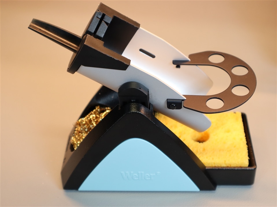

These irons rest on their own custom safety rest, which have both a wet sponge and a brass sponge. The rests are reversable depending on which sponge you would prefer to be forward facing. I reversed one to have a sponge in front and left the other with the brass sponge so that both were readily available to use (more so the brass sponge). The legacy WESD51 has only a wet sponge and the Metcal GT90 has the advantage of both sponges available from the front.

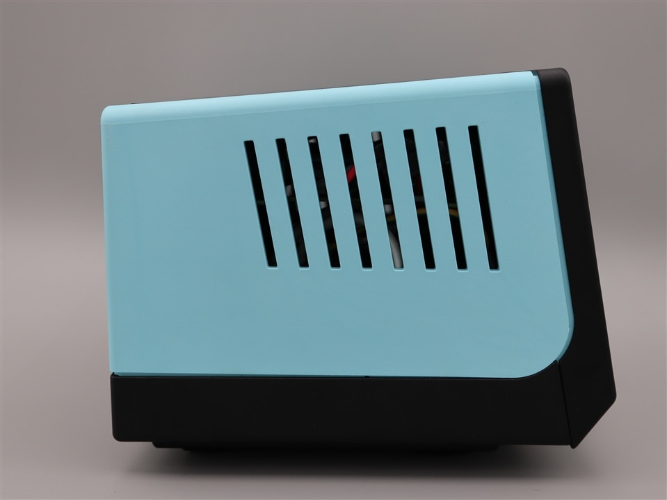

The WXair provides the air/vacuum system for the WXsmart platform with one air channel for the WXHAP200 hot air tool and one vacuum channel for the WXDV/P120 desoldering iron. It is fully controlled by the WXsmart power unit through the provided RJ6 RS232 cable. Depending on which air tool is connected, the 70W WXair will light up a blue ring surrounding the correct port. Only one air tool can be connected to the WXsmart power unit and WXair at one time. An optional foot pedal can be added for additional control.

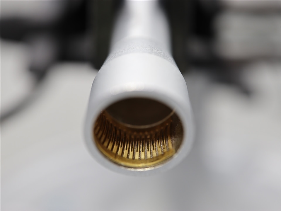

I noticed one issue, a grommit inside the WXair on the vacuum side was fitting loosely inside the port. I pushed it back in place, however, I feel this may be something to watch for when changing the filters.

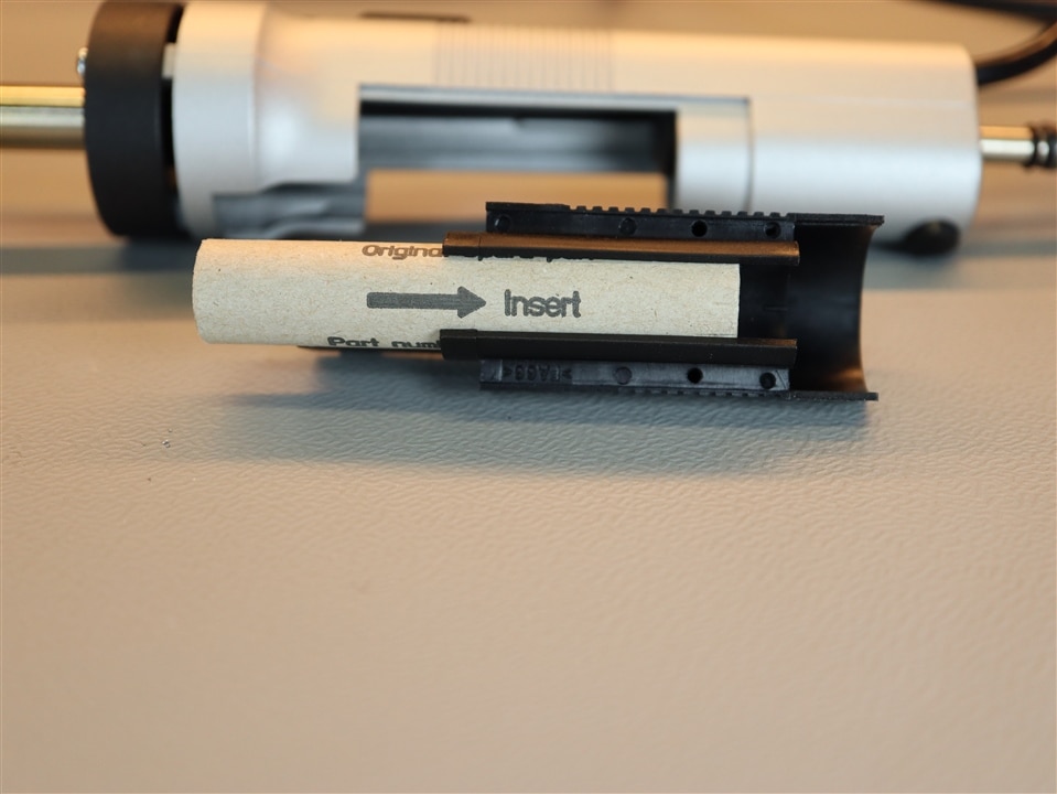

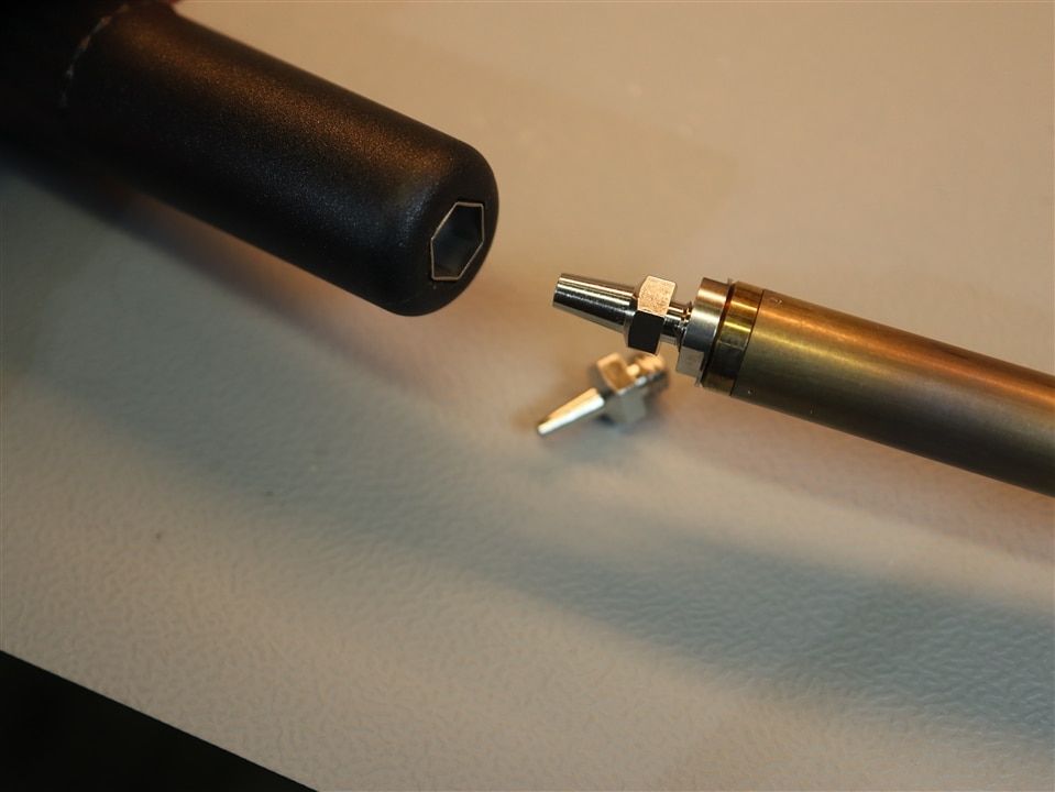

The WXDV120 desoldering tool cleans up solder joints nicely - easily and quickly. It is many times faster and more thorough than manual tools are capable of. Using the WXair for vacuum, the WXDV120 was able to quickly remove solder from through-hole solder connections. This was a treat – it is now possible to un-solder almost as quickly as soldering! Integration with the WXsmart control unit makes this a breeze to control and use. The case is plastic and bulky; however, the bulkiness is to be expected with the air hose attached and air filter contained inside the handle. Changing the filter is easy. It was, however, not easy to use the WXDV120 under a microscope as the lenses get in the way of the vertical orientation. Weller does offer a horizontal desoldering iron for the WXsmart (WXDP120) which may be better suited to small precision work.
The WXDV120 included three size tips, #1, 3, and 5. These metal tips are not smart and don’t need to be. As a result, the WXsmart power unit would need to be manually adjusted to be aware of the tip change, though it is unclear if the WXsmart uses tip identification to adjust performance characteristics for the WXDV120. Also included was a Erem hand tool for removing the tips. I did get a tip stuck trying to change tips while the iron was hot, so I would not recommend trying this, but it does bring me to briefly mention the cleaning tools. One brass brush is included along with a multi-tool containing three straight rough cleaning rods and one that looks more like a drill bit for debris that needs persuasion to be removed.

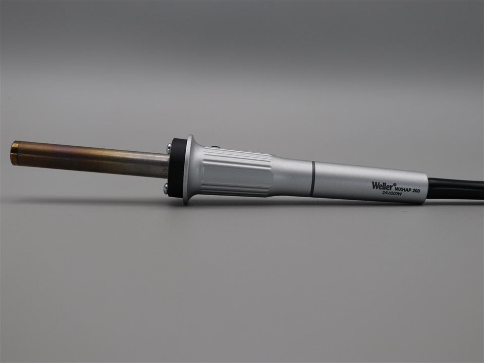

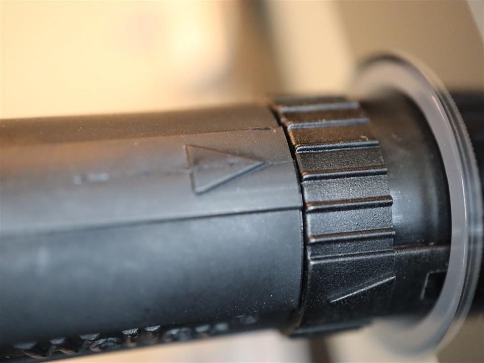

The WXHAP200 air tool is powerful and precise. The packaging is plastic, and the shape is reminiscent of a nostalgic Weller hand solder tool.

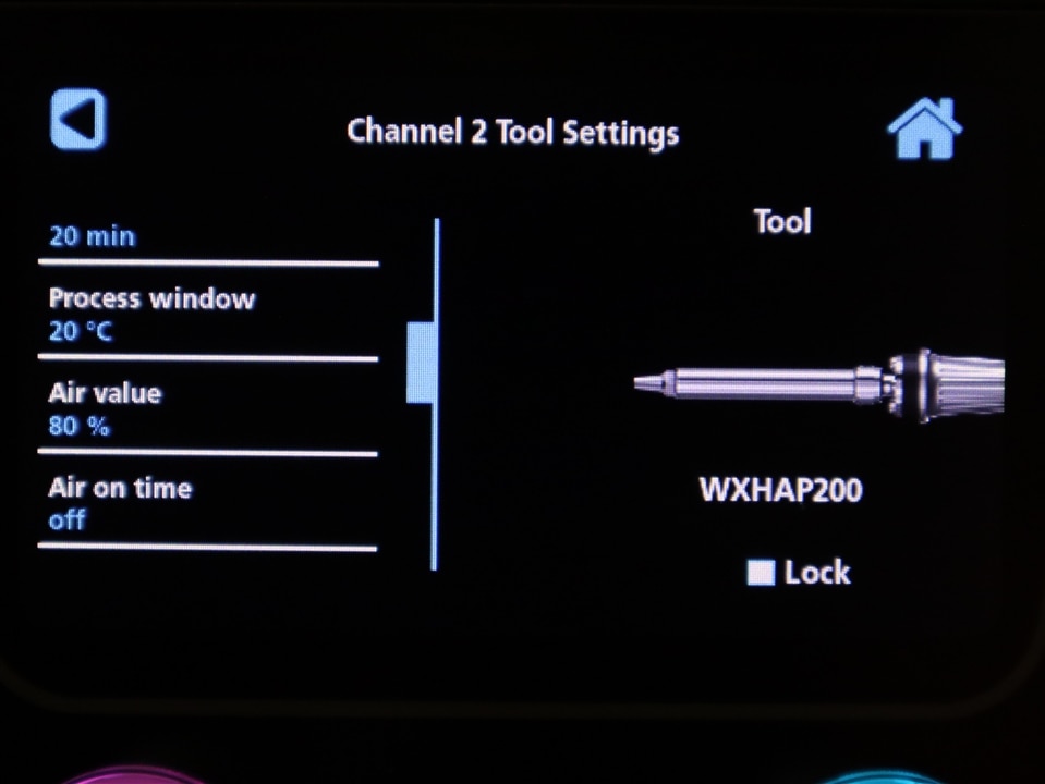

In addition to selecting the temperature, the WXsmart power unit allows you to set the airflow as a % of the maximum, from 10%-100%. You can also change the behavior of the button (momentary or latching air flow) and set a pause to allow the iron to heat up prior to flowing air.
I used the WXHAP200 to shrink heat-shrink which it handled amazingly well as expected. In another experiment for precision, I was able to heat shrink the outer base and emitter leads on a TO-92 transistor package without (significantly) shrinking the centre collector lead’s wrap and without separating the leads. This took some effort but was possible due to the iron’s significant control of temperature and airflow using the small metal tip! Two tips were included, and like the WXDV120, these tips are not smart and don’t need to be.
Reflow activities are a snap with the WXHAP200, as is the removal of components that require heat applied to many leads simultaneously.
I also tried soldering SMD components with solder paste and the WXHAP200. The key word is tried. Though I was somewhat successful with low airflow and high temperatures, I still managed to blow those tiny parts around and make a general mess. Thankfully I was able to use the WXDV120 and a small smart tip to make things look better, but still generally not great. This was not due to any issues with the WXHAP200, rather this was an operator problem. More practice would help. When soldering SMD, I may just stick with the WXMPS handpiece and one of the small pico smart tips, like the tiny RTPS001.

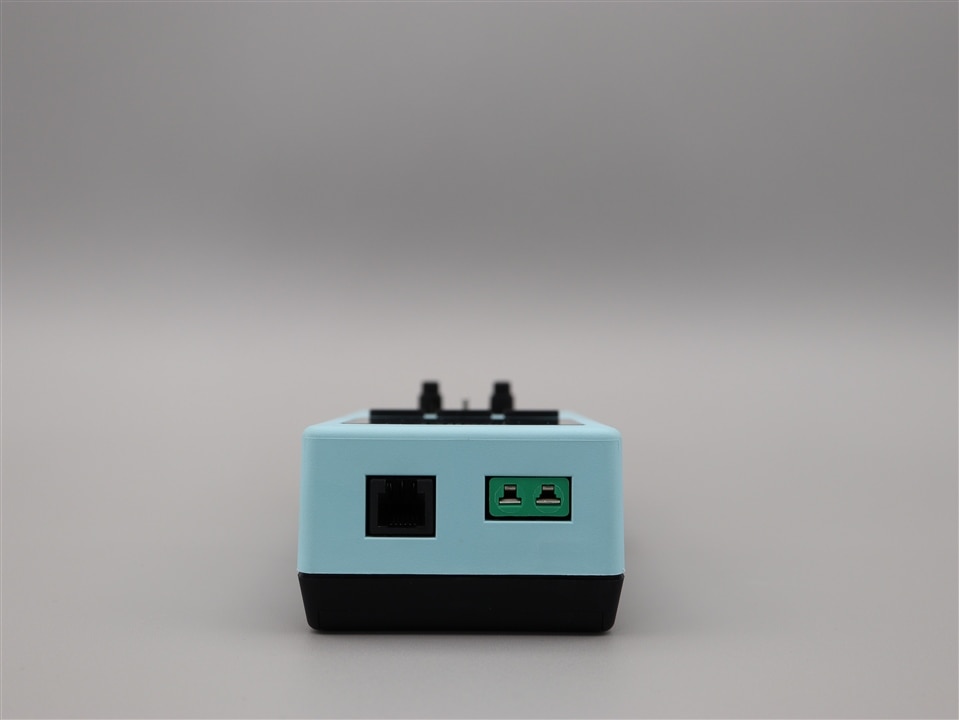

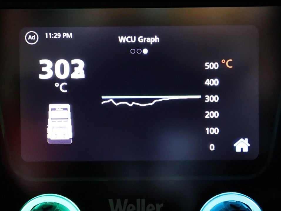

The WCU temperature measuring and calibration unit is a great addition to the platform and ensures consistent accuracy. The top mounted thermocouple is designed for specifically for soldering iron temperature measurement and is suspended in place by a tension spring. Calibration is simple and quick. Using a reverse wired RJ6 cable, the WCU can automatically calibrate the temperature offset for a smart tip on a selected channel. Or you can manually calculate the required offset. Temperature displays in °C or °F. I tested the accuracy against a 6½ digit multimeter and thermistor – the two units were within 1°C each time. An additional thermocouple can be plugged into the back for external measurement.

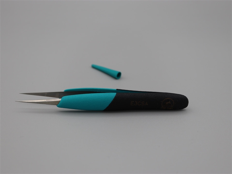

The WXsmart demo kit also includes the Swiss made Erem E3CSA tweezers and Erem 622N side cutters. In keeping with the rest of the WXsmart platform, these are superior quality tools. They are ESD safe and have firm but comfortable grips. The tweezers are great for working with tiny SMD components under a microscope and the side cutters were able to slice through wire like butter, with clean cuts. I have ESD safe metal tweezers along with Craftsman long needle nose pliers however the Erem are more comfortable and precise. I also have several side cutters that are comparable, including Xcelite 170M (now Xcelite by Weller), Xuron microshear 170 and Plato 170. The Erem 622N are more comfortable and the grip is firm.
Like the soldering irons, Erem tools bring you much closer to the material for enhanced precision and control. I have strong appreciation for quality tools and the Erem have become my favorite hand tools to work with.

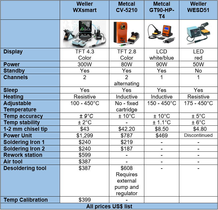

Specification and cost comparison
The Weller WXsmart platform is positioned for industrial use and maximum capability - it is not cheap. There are other Weller models better suited to the average student or hobbyist budget. There is no known direct all-in-one competitor to the WXsmart system, however some components can be compared as below.

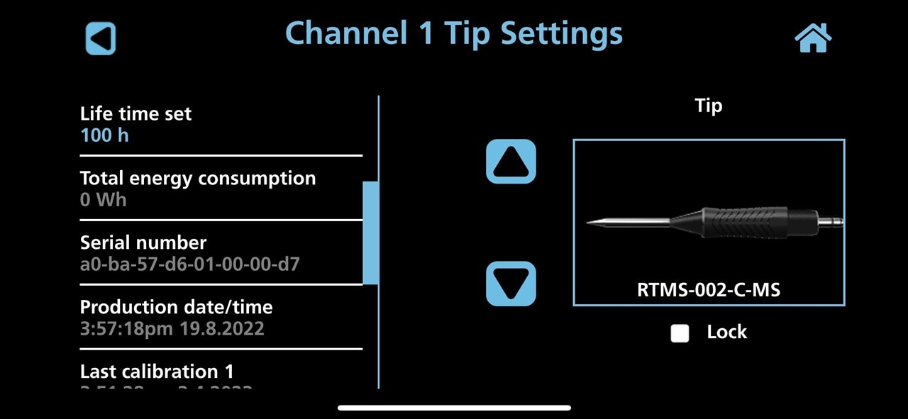

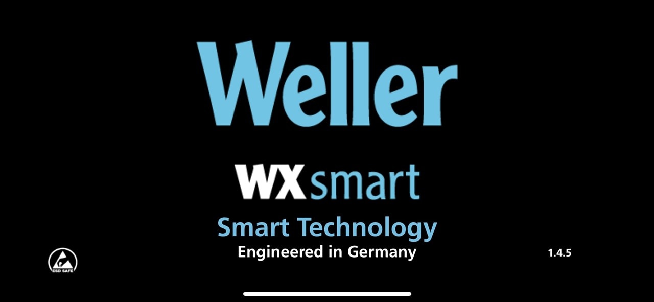

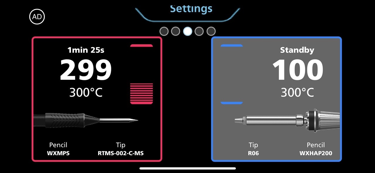

The Weller Smart Control app for Apple IOS

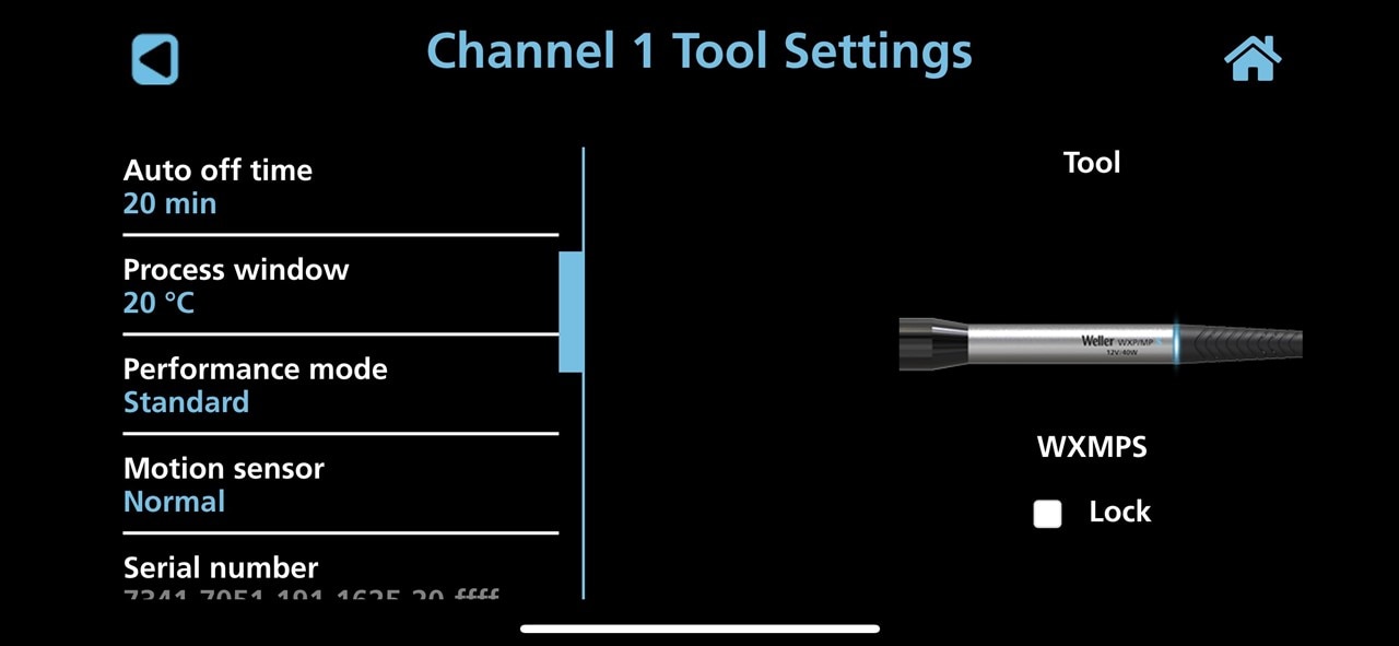

This is a well presented application. You can log in as any user on the system, provided you use the correct password and pass a simple two-factor authentication challenge. The main display is nearly identical to the front display on the WXsmart power unit, where you can swipe left or right to set the temperature, change tip/tool settings, change ring colors, or view a power graph for either channel. The main display includes a settings page where you can make limited changes to the WXsmart 300’s configuration.
The QR code sheet takes you to a video to ‘Install the Weller Mobile App’.  It shows you how to use the app but unfortunately does not provide installation instructions. Go to the Apple store and search for “WX Smartcontrol”.

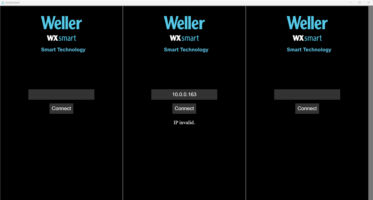

The Weller Smart Control app for Windows
The Windows app has different functionality from the IOS app and does not allow control of the station. This app provides a nice color interface to view up to three stations simultaneously along with power graphs and temperature settings. It allows you to record and export a .CSV file of the station’s setpoint/actual temperatures with timestamps which supports the traceability of the platform - this feature is not available on the IOS app.
The QR code sheet takes you to a video to “Install the Weller Desktop App (Windows)”. This video will tell you to “Download the WX Software from the Weller website”. However, the video is out of date and the software was not found anywhere on the website. After reaching out to technical support, I was able to determine the software is available in the Microsoft Store. Search for “Weller”.
Once installed, the software would not allow connection over my home data network. The software determined that addresses on my LAN are “IP invalid.” I use a valid 10.0.0.x/24 IP address scheme and the IOS app worked fine, only the Windows app had this issue. Instead of reconfiguring my network, I used a hotspot on my iPhone to create a new network that the app supported.

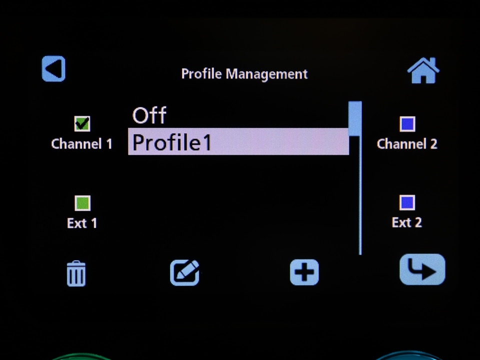

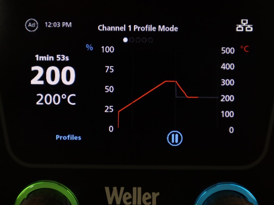

Weller also provided hot-off-the-press feature update to unlock the optional settings in the power unit. This feature update installs the same as the firmware update – easy. Previously unavailable modes for Profiles, Tracking, Calibration, and QR became available to use! While these features were not part of the formal test, I did have a look at each.
Profile allows the setting of heat profiles over time. With this mode, you can program the station to start from a set temperature and adjust through a series of up to three different temperatures, holding at each for a customizable time frame. The temperature adjustment rate can be customized for each transition.

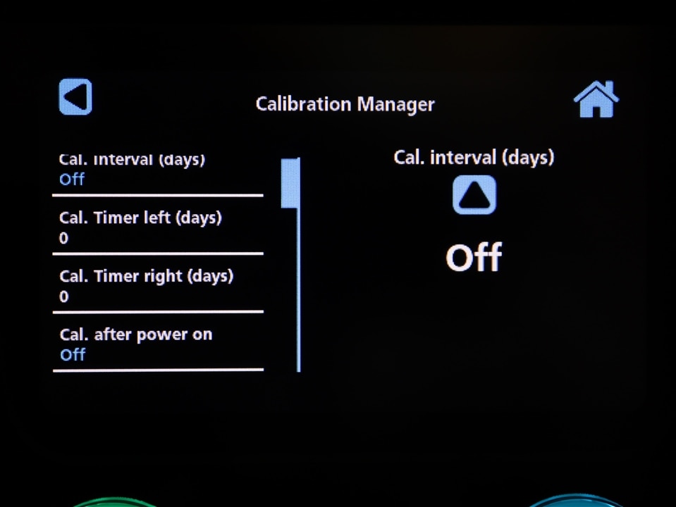

Calibration reminds the user to calibrate the tips at set intervals of days, after power on, or after tip changes. Testing with the tip change option, it reminded me to calibrate with the first tip change right away, the notification for the 2nd change was a few minutes delayed. As these features are new, a firmware update may reduce the delay.
