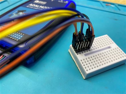

For those that cannot watch the video, getting started is really simple.  I did the Windows install since I have Windows laptops.  Using the provided USB cable, plug the ADALM2000 into the computer.  Initially, it looks like a USB stick.  Select the info.html file and it will load a local webpage with installation instructions. Install the three files it directs you to and reboot.  You are ready to start hands-on learning.  You will need to provide your own breadboard.  I found the most convenient breadboard setup was to use four of the extra-long male headers provided in the box and arrange them as pictured below.  The remaining open hole allows for a male jumper to expand the buss if you need it.
To try the instrument out, connect one of the Ground wires to one of the male headers to create a Ground buss.  I chose the right most row.  Connect Analog Output 1 (Signal Generator Channel 1) to Analog Input 1, Positive (Oscilloscope Channel 1).  Connect Analog Input 1, Negative to Ground.  Connect Analog Output 2 (Signal Generator Channel 2) to Analog Input 2, Positive (Oscilloscope Channel 2).  Connect Analog Input 2, Negative to Ground.  See picture above.

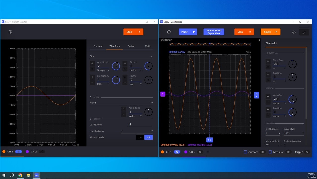

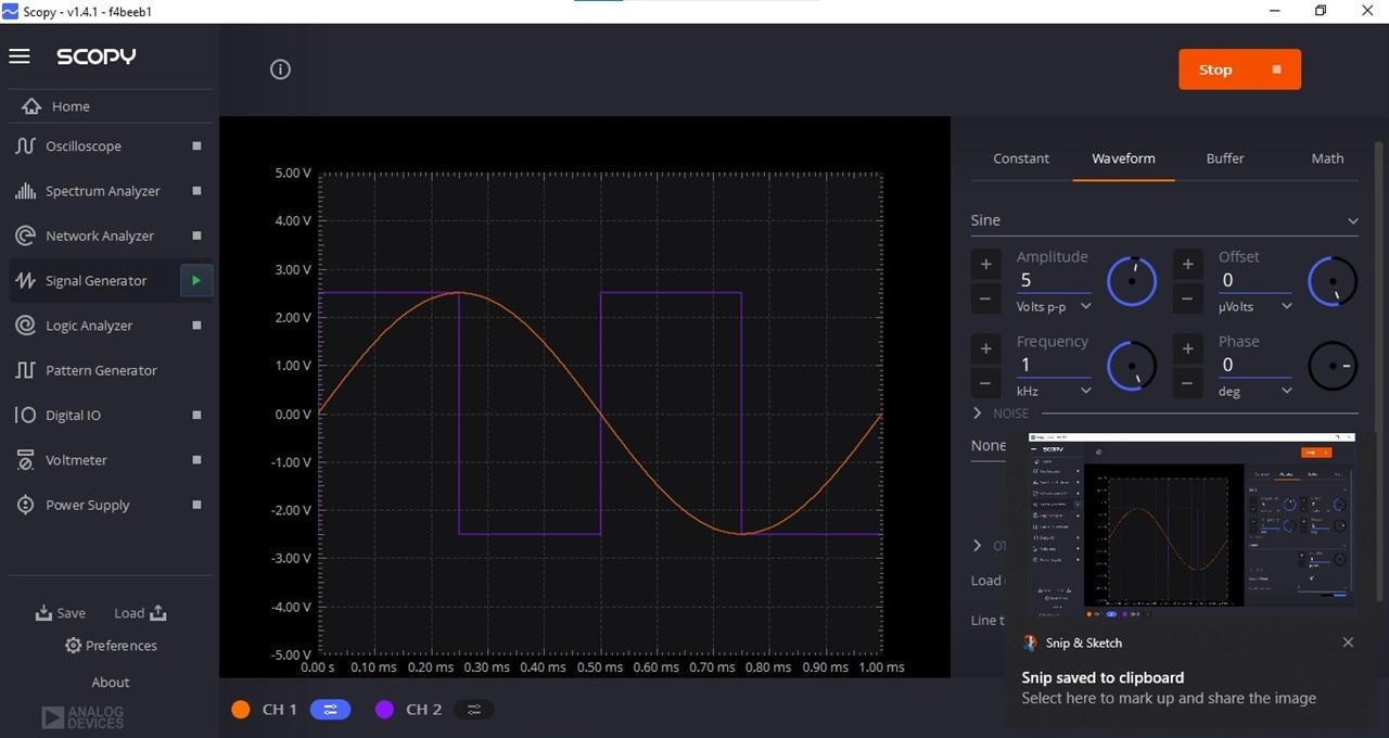

Now launch the Scopy software you installed earlier.  Scopy is the ADALM2000's interface software.  It has a demonstration mode that allows you to try out a mock ADALM2000 without actually owning the device.  Oddly enough, it behaves exactly like the real instrument in that if you have a bunch of windows open on the computer running Scopy... you can lock the software up to where you have to close the application and re-launch it.  Not always... but sometimes.  This proved to be true on an Intel I3, I5 and I7 laptop.  The system is most stable when the ADALM2000 is the only user process going on.  You do have to remember to RUN both instruments (the signal generator and the oscilloscope).  This can be done by selecting the [RUN] button for each instrument or by clicking on the small white square next to the instrument name on the left instrument pane.  The white square will turn to a green triangle (pointing right) when the instrument is running.
The Signal Generator output is below.  Channel 1 is a 1kHz sine wave.  Channel 2 is a 2kHz square wave.

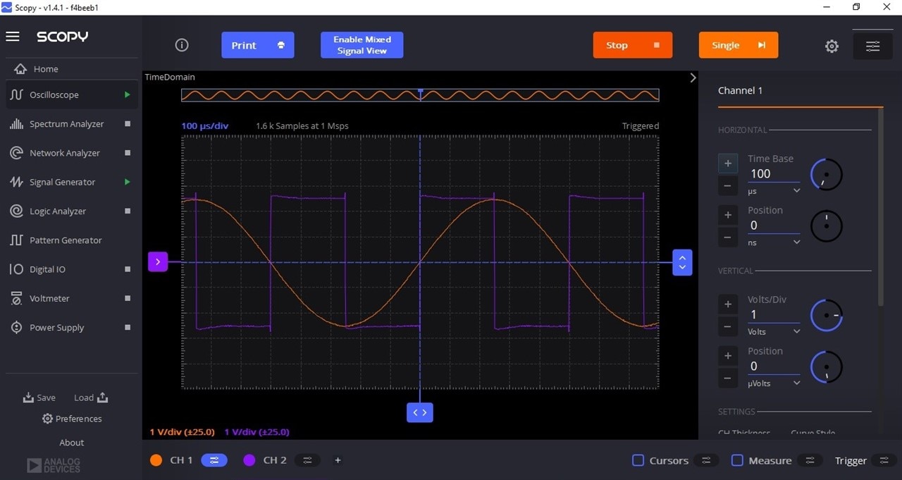

The Oscilloscope display of the Signal Generator output is below.
A SUPER COOL feature of Scopy is that you can detach and move the instrument windows.  Just double click on the instrument name and it pops out a separate window.  The two windows below were placed on a second monitor for the screen shot.
An even cooler feature is the zoom feature.  Just draw the box and the software zooms to the box.  You can zoom within the zoom.  Clicking the right mouse button backs you out to each successive zoom level.

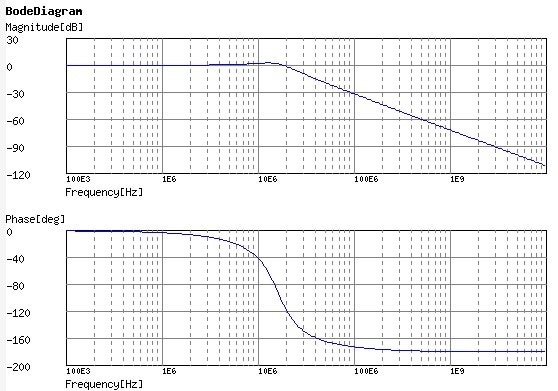

I would be lying to say that I wasn't excited to get to this part of the RoadTest.  However... once again, I fell into the trap of tweaking the circuits.  I kept reminding myself, "It's about the instrument, not the experiment."  I also discovered another cool feature.  When I ran a sweep with the Network Analyzer, if I had not set the limits correctly, I could adjust them afterwards and still see the data.  I can't do that on my NanoVNA.

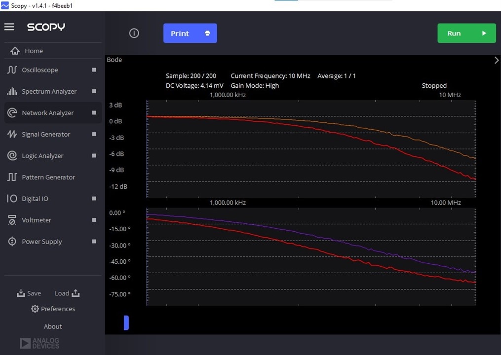

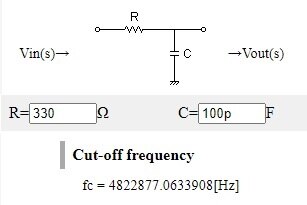

The first filter was a 3.5MHz lowpass filter.  My band of interest is actually 3.5MHz to 4.0MHz so I set the rolloff frequency around 4.5MHz.  I played with a few mutli-stage filters before settling on a simple RC lowpass circuit.  I used http://sim.okawa-denshi.jp/en/Fkeisan.htm as my online calculator.
I assembled the circuit and ran the sweep.  The results are below.  The red trace is the circuit with the 100pF capacitor.  The orange trace uses a 47pF capacitor because a 5dB loss at the final desired frequency seemed a bit much.

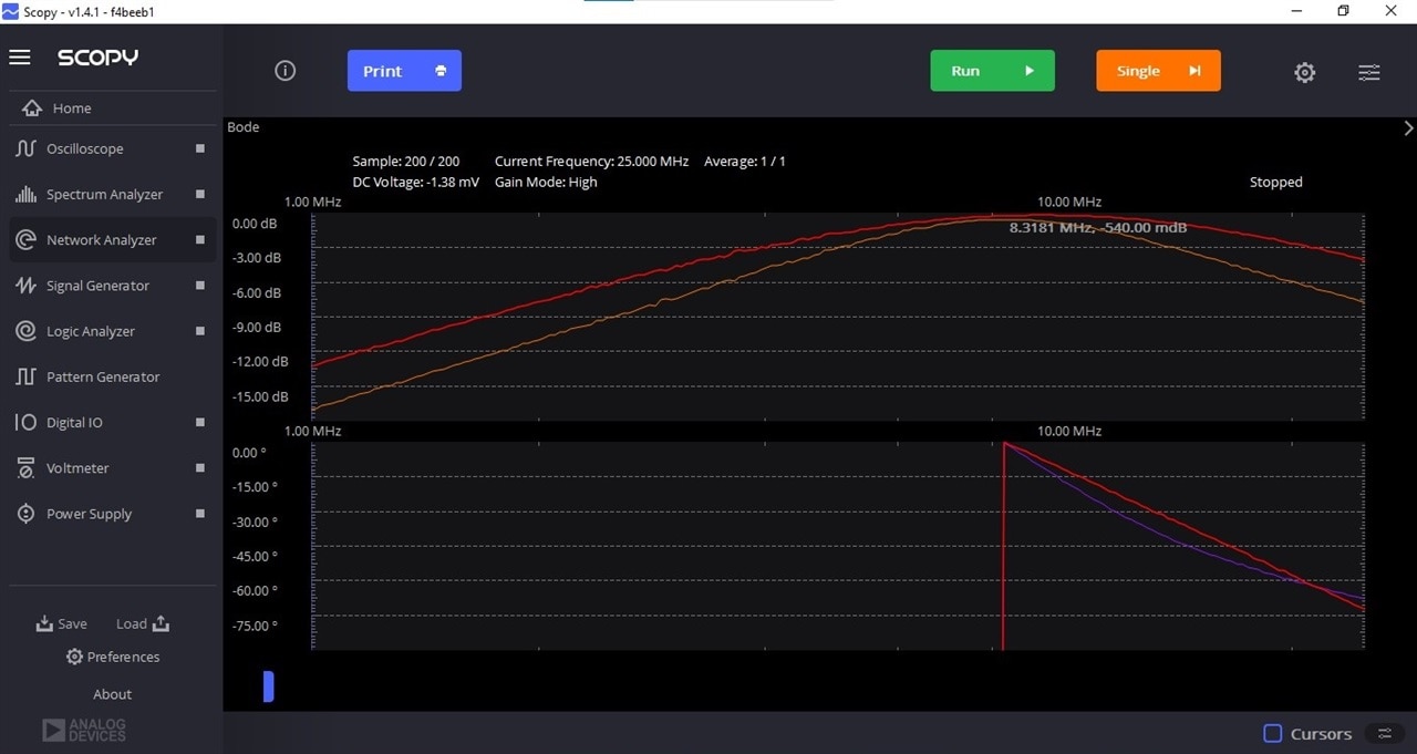

I was able to get better results with a bandpass filter - but that was primarily through experimentation.
The result from the assembled circuit is below.  The red trace was with the original calculated components and the orange trace was the trace after swapping a few components.  The actual ideal capacitance to get the bandpass centered on 3.75MHz proved to be 122pF (determined by successive substitution).  This response was way more in line with what I wanted from a filter and far better than just what the RC lowpass filter yielded.  I also discovered a 14MHz bandstop filter.  The component that allowed such a change in the trace wound up being the parallel resistor.  Go figure.

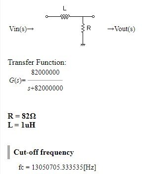

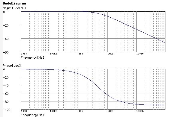

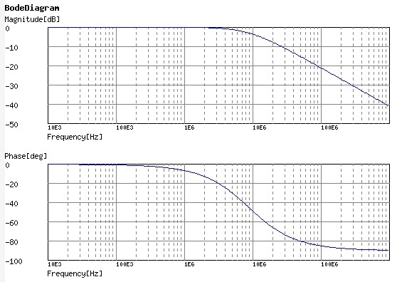

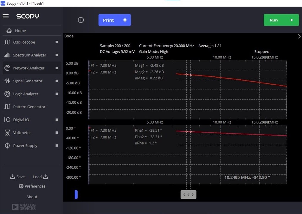

On to the 7MHz filter.  Seeing the sweep in real life was a bit disappointing.  The RC filter plot looked promising.
What i measured was...
2dB+ loss at my target frequency and essentially a flat curve.  "FOCUS, Michael.  It's about the instrument."
The Bode plots and the circuit simulations can cause us to have unrealistic expectations.  But the real circuit... is real.  The response is what you measure.  The ADALM2000 is doing its job.  I'm learning.

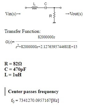

For the 7MHz bandpass filter, the results were more promising.
The red trace has the 82Ω resistor.  The orange trace is with a 51Ω resistor - that more closely represents coaxial cable and an amateur radio antenna.

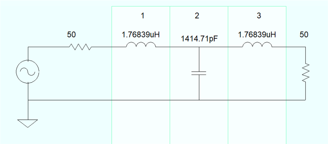

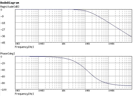

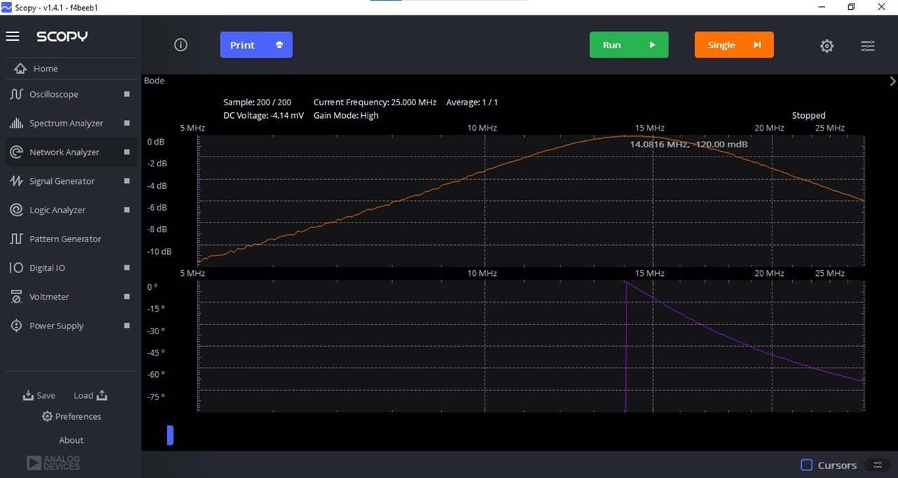

The next endeavor was 14MHz.  Once again, the simple lowpass filters were underwhelming.  The RC filter was unimpressive so I tried a LR filter.  Also underwhelming.
The red trace is what I measured for the LR filter.  I opted to try a LCR lowpass filter.  This is the orange trace.
The LCR filter is better in the frequency range of interest (14.0MHz to 14.35MHz).  It has better low end pass through and high end rolloff,  The resultant frequencies are off a bit from the calculated values, but that is fine as the calculated rollofff frequency was too low anyway.  The LCR calculated values and traces are below.
 Once again, the bandpass filter proved to be the better option.
The measured curve is flatter than the calculated response, but there is still around 5dB attenuation at the 1/2x frequency and the 2x frequency points.

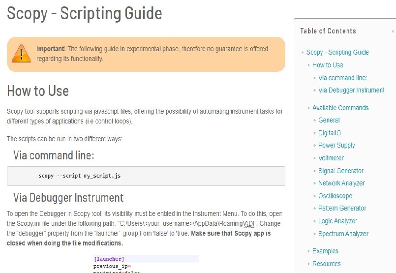

    I recently finished a contract job. Compensation was a System76 laptop. In all my careers I have never had a computer a good as this. It runs only Linux (YES!), a joy to use.
    I have followed some of your posts. If scripting was an interest, I feel you have the skills to take it on.

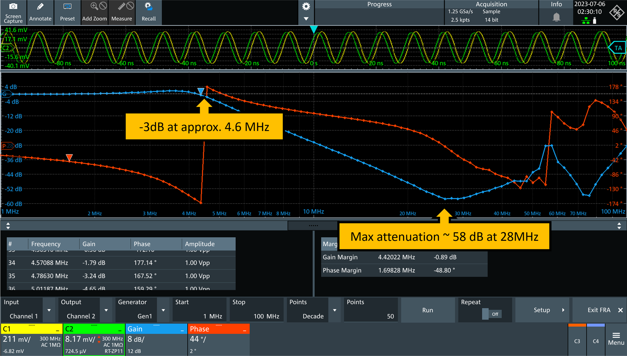

    I don't have an ADALM2000, so used the MXO 4, but the results will be similar of course:
    The filter worked nicely to about 28 MHz, and then parasitic stuff from the long wires got in the way, and so it no longer behaved like a model filter.
    If you like, I can write this up, showing the layout etc. I used enamelled copper wire, 24 AWG, and wound it around a drill bit, and then measured with a cheapy inductance meter. For the 1.414nF capacitance, I used 5 disc ceramic capacitors in parallel (1 x 1nF, and 4 x 100pF).
    In summary you'll be OK on breadboard for the filter values you mention, although it won't be as effective approaching 30 MHz or so (but HF radios will likely have their own filter beyond that). But copper-clad, or custom PCB would be good if possible.

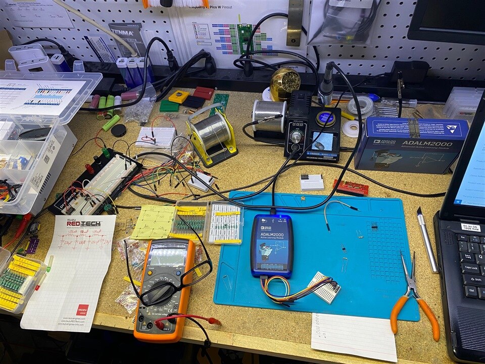

    Doing the filter experiments, I wondered how much the breadboard capacitance impacted my readings.  I was going to try some dead bug style assemblies but - honestly - I set the PCBs down somewhere while cleaning and have yet to find them.  I don't want to revert to the "Hail Mary play" of buying more only to have them return from that parallel universe they are hiding in moments before the postman delivers the new boards.
    Thanks again for the guidance.
