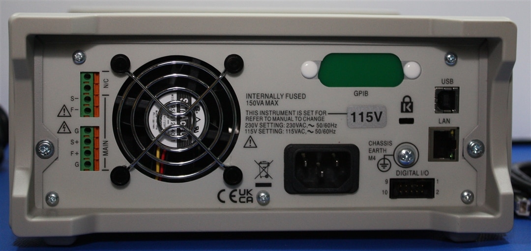

Figure 2. SMU4201 back panel.

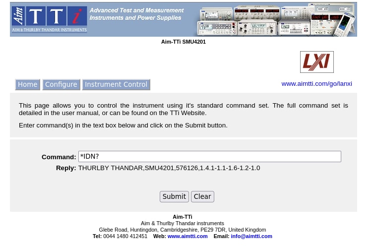

The SMU4201 supports control and automation through Standard Commands for Programmable Instruments (SCPI).  SCPI allows flexible data acquisition, collection and analysis of measurements.  The commands are encoded strings and measurement setups consist of multiple commands sent in successions.  The list of available SCPI commands are listed in the Aim-TTI 4200 Series Programming Manual
SCPI Programming With Python
A very straight-forward method of sending SMU4201 SCPI commands is to use the USB interface and Python.  These are simple examples, but suggest how more complex automated test setups and frameworks can be created using open source tools.  For this example, I used Ubuntu 22.04.2 LTS and Python 3.10.6, though this should work for a wide variety of Linux systems and Python3 versions.

Example: Instrument Identification
If everything works, the following commands should return the SMU4201 identification string.
$ python3
>>> import serial
>>> conn = serial.Serial(port=’/dev/ttyACM0’, baudrate=115200)
>>> conn.write(‘*IDN?\n’.encode)
>>> print(conn.readline())
b'THURLBY THANDAR,SMU4201,576126,1.4.1-1.1-1.6-1.2-1.0\r\n'
