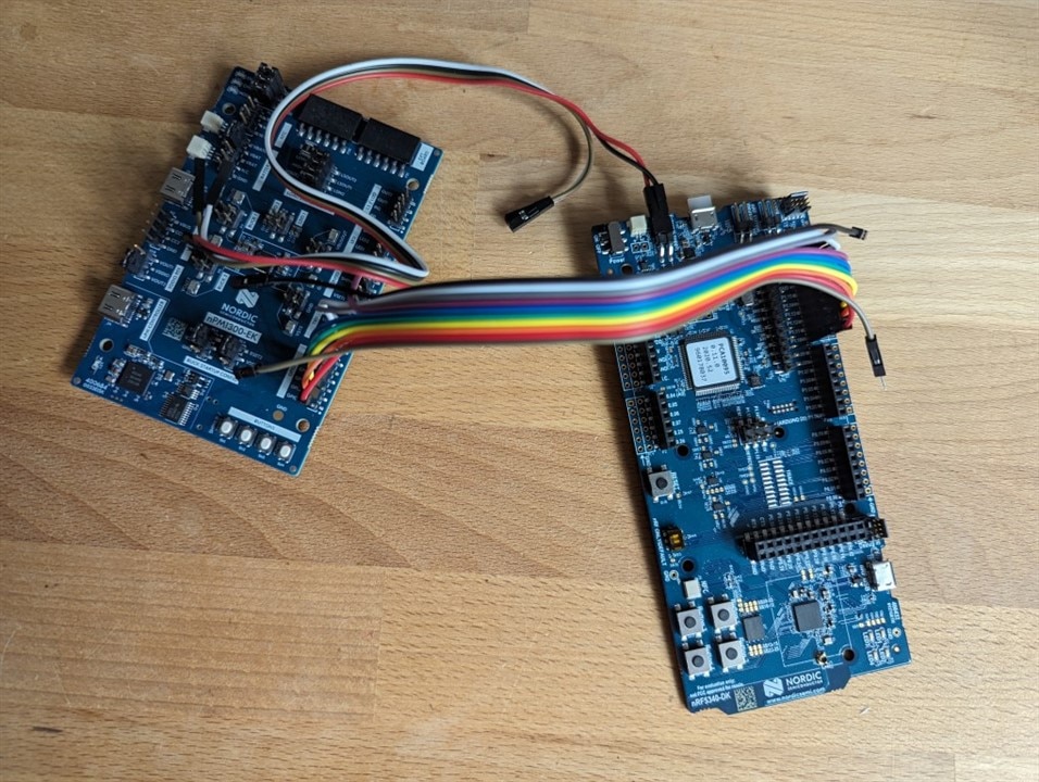

Hardware configuration
A major feature of the nPM1300 EK, is to help you create the code that you can then run on an external microcontroller. Naturally, Nordic's devices are well supported, although there woudl be noting stopping you doing some porting and using any microcontoller that an I2C interface and some GPIO - i.e. pretty much all of them. I briefl wondered whether it woudl be possible to create code that would run on the on-board nRF5340 rather than connecting a separate development kit. It's probably possible but would risk bricking your nPM1300 EK. Anyway. connecting this board to a nRF5340DK is well documented.
Perhaps it's a little too well documented! I got to teh section of the getting started guide that deals with connecting the nRF5340, but had a feeling that wasn't all of it. I eventually tracked down some better documentation that I'd seen when applying for this road test. This was in to Info Center. However, even this had some minor discrepencies between the text and the diagram. For instance, the diagram does not show the SHPHLD connection. There's even a third set fo documentation here.
To be honest, they're all adequate, but it's confusing to find 3 sets of slightly different documentation. In the end I wired thing up as per the InfoCenter diagrams, including the GPIO and SHPHLD connections. Here's how it looked:

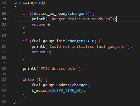

So, once the hardware was connected, it was time to look at the software, Once you have the toolchain up and running it is fairly easy to create a project from the nrf_fuel_guage example that comes with the latest SDK. This came with some default battery data already present so it compiled easily and I was ready to run it on the nRF5340DK. As the example project uses a serial port to report back on what's happening with the nPM1300, I needed to connect 2 micro USB cables - one for programming and debugging the microcontroller, and another as a USB serial port. With only a minor delay whilst I guessed which one of the serial ports was the right one, I was up and running. The sample application happily popped up "Charger device not ready" on the serial port and stops...
Of course, this is completely correct. I'm happily running the code on the nPM5340 but it is expecting that the nPM1300 to be providing power. There would be no point powering this from the nRF5340 DK as that would rather defeat the point of a Power Management IC! This is the main function of the sample application, so you can see that it does nothing unless it finds a happy nPM1300 to talk to.

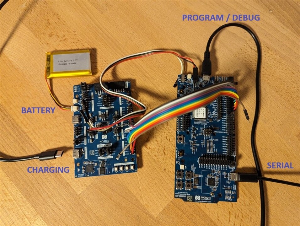

I added a third USB cable - this time USB-C power only from a phone charger I had handy. Re-running the sample and I had some more meaningful output. The code runs in a loop and every second gives a report from the PMIC. This is what I saw:
V: 0.019, I: 0.000, T: -88.12, SoC: -5.00, TTE: nan, TTF: nan
...etc.
Well, that's certainly better than coming to a stop, but it didn't really seem right - a battery voltage of 0.019V, no current, a negative State of Charge and no idea when the battery would be full or empty....
The battery! Of course. After sorting out the mass of wires between the boards and the 3 USB cables I'd forgotten to connect the battery! The nPM1300 has been configured to supply the microcontroller with the required 3.3V whether it comes from the battery or USB and it is doing so. Power regulation is one part of its feature set and it's managing this just fine. However, the application is a fuel guage application and it correctly reporting that there's nothing going on.
Once I'd re-connected the same battery I'd been using earlier with nPM PowerUP the values made a lot more sense. The battery voltage was a mroe senible 3.994V, there was 128mA flowing into it, it has about 65% SoC and rising. That's lookng correct. However, as the capacity of the example battery is unlikely to match the one I'm using the Time To Full of about 40 minutes is probably incorrect.
