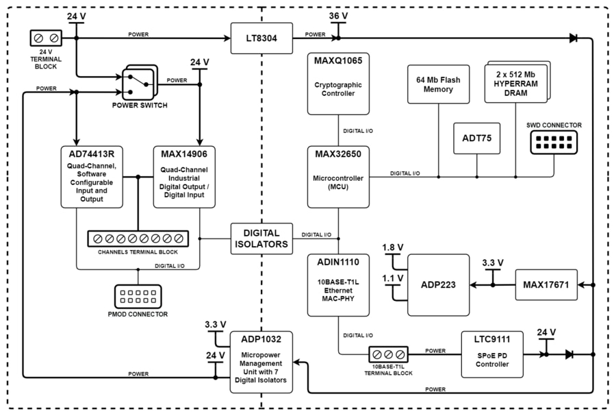

As can be seen, the module consists of two isolated parts - one connected to the "field" and one connected to the Ethernet interface, with possible power transmission both ways, which gives the opportunity to power it either using SPoE or a dedicated 24 V/2 A power supply. This second option provides more current to the MAX14906 digital interface, allowing for driving more power-consuming loads, as it is capable of supplying any of it's outputs with 1.2 A of current (and 2.4 A for a short time when Inrush Current Mode is activated).
Any of four channels available on the terminal block can be connected either to the MAX14906 or AD74413r interface, giving many possible I/O functions, configurable (and reconfigurable) at runtime. These functions include:

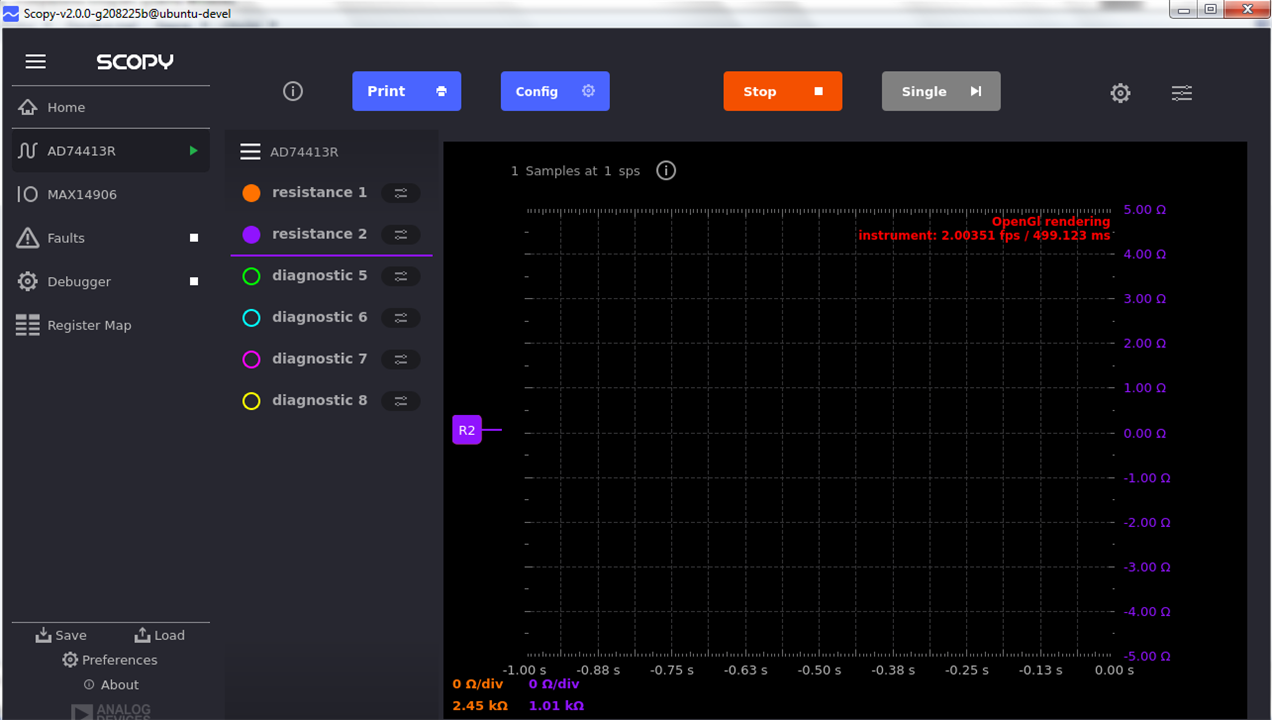

After configuration was applied to the board, different screens are available, allowing for more fine-tune interface configuration and operation. In case of MAX14906 interface, output topology can be changed here, along with current limit and output state (low or high)
MAX settings

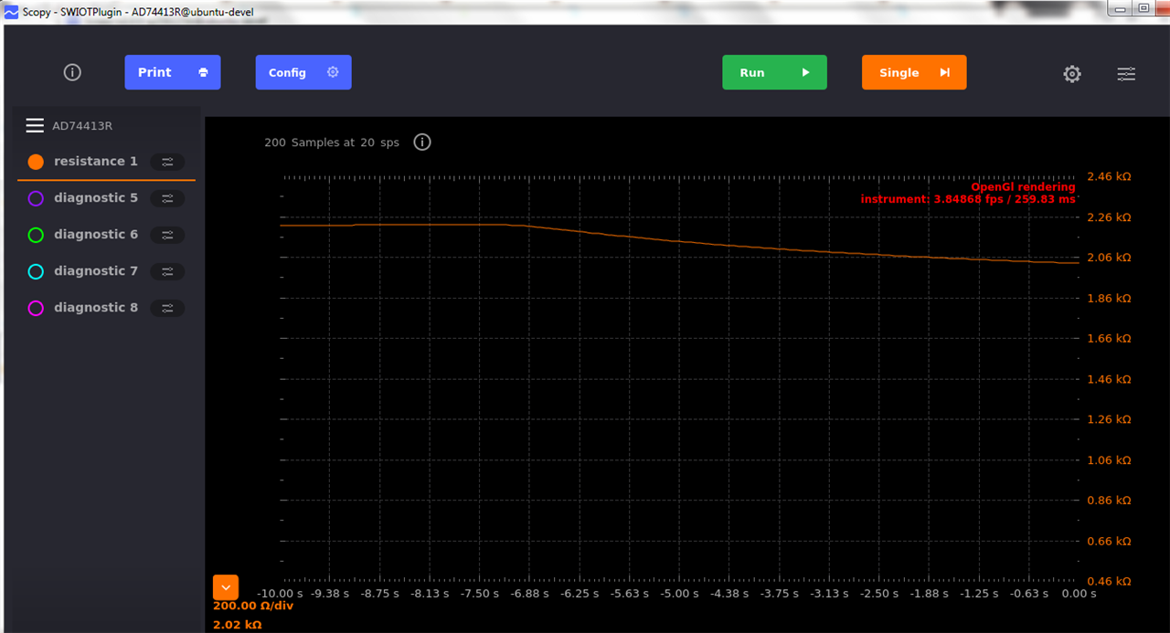

In case of AD74413r, input data is displayed in the graphical form - below is a presentation of data captured during heating of NTC termistor
NTC resistance
as a comparison - below there is a screenshot of the graph as above but using preprogrammed firmware - one can see that resistance values are displayed in the lower left corner of the graph but no data lines are present (probably because GUI got confused by the data returned by the board - more information in the next paragraphs)
no graph lines using old firmware

After the upgrade, many problems observed previously have disappeared - PyADI-IIO script stopped generating exceptions, correct graph of measured resistance in SCOPY software have appeared, stability problems of GUI largely disappeared.
