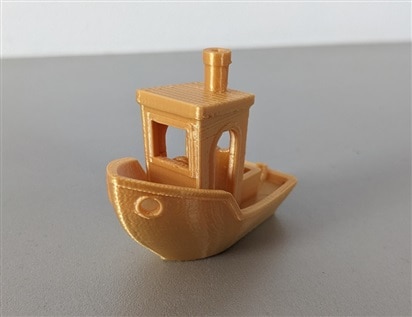

In my experience, the Multicomp Pro Silk PLA prints well, similar to other good quality PLA:
The 3D Benchy and the Astronaut printed very well:

Compared to the Metallic Green PLA from Filament PM, I would say the two materials perform about the same:
Now, before looking at the price I would have said I'm impressed by the Multicomp Pro Silk PLA filament.
But, apparently this filament costs about 42 EUR for a spool of 1KG. This about 1.5-2.5x more that what I would normally pay for a 1KG spool of PLA. So, I would not really recommend the filament at this price, unless you're already shopping at Farnell / Newark and you don't really care about the price.
If I would have to guess (again Sunglasses), I would say the Multicomp Pro Silk PLA line is a re-branded version of the eSun ePLA-Silk Metal product line.

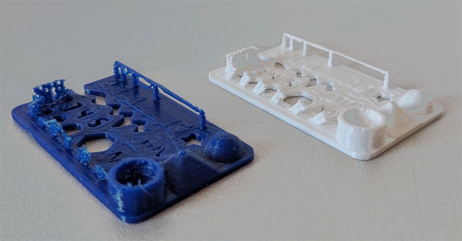

Unfortunately the Multicomp PETG filament did not managed to change my opinion about PETG. Here are some of the parts printed with the models:
The 3D printer and torture test models were successfully printed, but there is quite some stringing in the points where travels starts and ends:
image image
Note that this level stringing happens after tuning the retraction settings a bit.

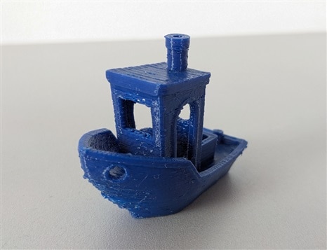

The 3D Benchy and Astronaut models printed successfully:
image image
but I needed to re-print the Astronaut model once. On the first print there were some artifacts at some places when the printer needed to bride over the infill in a semi-circular pattern:
From what I have seen there were quite some direction changing at those points, and the filament did not stick. I (somewhat) fixed this by increasing the infill percentage, and reducing the printing speed.
Compared to the White PETG from Filament PM, the two materials are similar. However, I think the Filament PM still prints a bit better (even if the material I used is a couple of years old).
Here is the what the 3D printer test model looks like printed with the same settings:

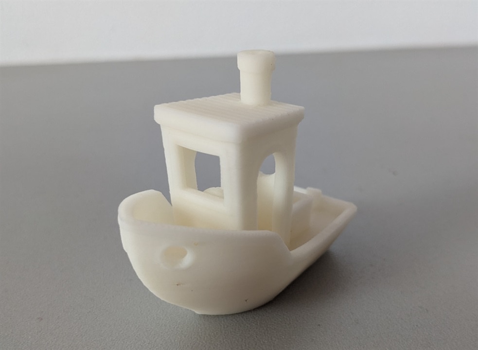

The 3D Benchy and the Astronaut printed almost perfectly:
image image

I'm generally impressed by the filament. I would even consider start using ABS again.
The price of the filament is around 27 EUR, which means it is the cheapest of the three filaments, and I would recommend it for this price.
