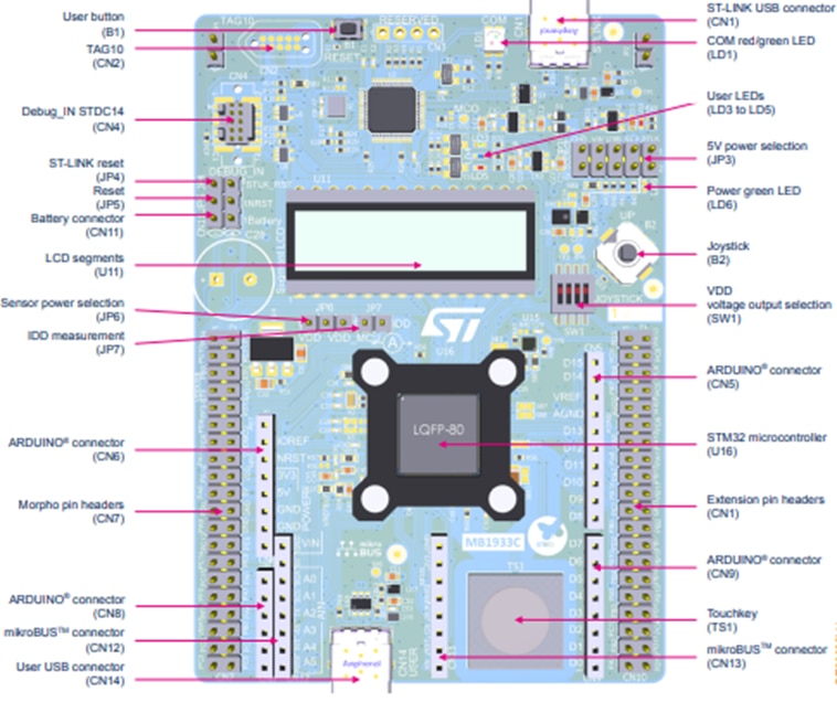

Part IB – What is the STM32U083C-DK?
Per STM’s website (see Useful Documents Links section), the STM32U083C_DK board, featuring an ARM Cortex-M0+ based STM32U083MCT6 MCU, provides an affordable and flexible way for users to try out new concepts and build prototypes by choosing from the various combinations of performance and power consumption features. Here are some highlights of the STM32U083C_DK board:
  • Ultra-low-power STM32U083MC microcontroller based on the Arm® Cortex®‑M0+ core, featuring 256 Kbytes of flash memory and 40 Kbytes of SRAM in an LQFP80 package.
  • Built-in STM32F-based STLINK programmer and debugger.
  • Board connectors:
        - ST-LINK USB Type-C connector
        - User USB Device with USB Type-C connector
        - mikroBUS connectors
        - MIPI debug in connector (Arm® Cortex® 10‑pin 1.27 mm‑pitch debug connector over STDC14 footprint)
        - Extension connectors for full access to all STM32 I/Os
        - VBAT dedicated connector provides the capability to power the board on a battery
  • Flexible power-supply options:  ST-LINK USB VBUS, USB connector, or external sources
  • 4×24-segment LCD
  • Three user LEDs
  • Reset push-button
  • User joystick
  • Touch pad
  • Temperature sensor

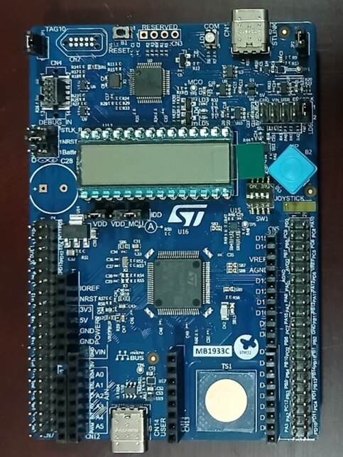

                       Discovery board component layout
 NOTE:  The smaller MCU at the top of the board is the STM32F-based STLINK controller

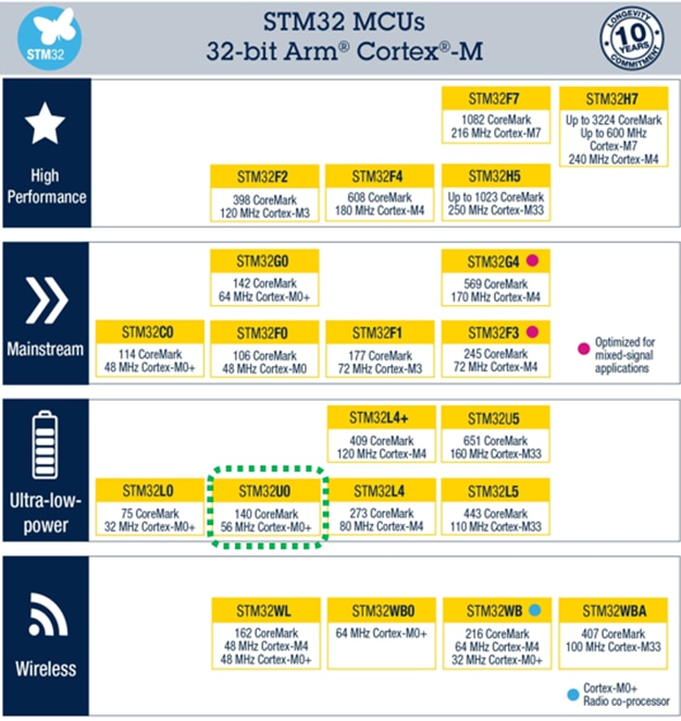

Part IC – What is the STM32 family and where does the STM32U083C-DK fit in?
The STM32 is a family of 32-bit ARM Cortex-Mx based microcontrollers (MCU).  The family of MCUs is further divided into 4 functional area: High performance, Mainstream, Wireless and Ultra-Low power as shown in the following chart.  The heart of the dev kit in this review (see highlight MCU) is part of the ultra-low power subfamily and includes a 56 MHz Corted-M0+ MCU intended for use in “entry-level, battery-powered applications” such remote sensing/monitoring devices.
Courtesy of STMicroelectronics
The STM32U083xC devices are an ultra-low-power microcontrollers family (STM32U0 Series) based on the high-performance Arm® Cortex®-M0+ 32-bit RISC core.  They operate at a frequency of up to 56 MHz.

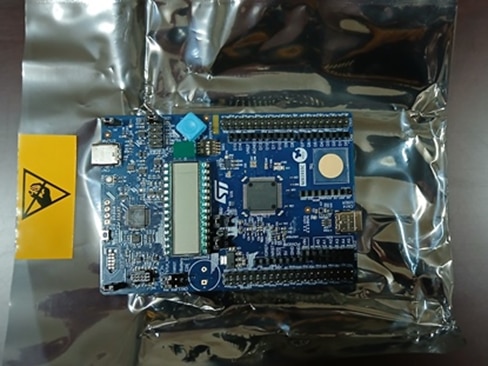

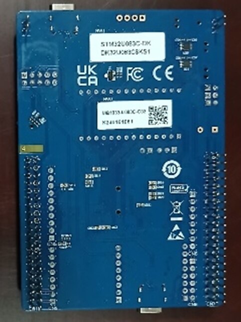

The actual board was equally packed well with loads of padding, and expected in a anti-static ponch.
 image image
image image
image image
Aside from the small 4” x 5.5” note showing a QR code and the corresponding website link, you’re on your own to gather the necessary documentation.  However, this not unusual as we have all seen with every dev/eval/demo kit produced for the last 10 years, all documentations are available only through download.  And as you can see from the Useful Documents Links section, there is no shortage of supporting documents.

At this time, I normally power up the kit to get a feel for whether the unit will show any sign of life.  The power LED (LD6) turned on and the display starts scrolling, the user LED start flashing.  Very cool, but this is where things get a little fuzzy.  I could use a little stronger language, but this is a family website.  The user manual (UM3292), although can be helpful in some areas, in the setup and functioning of the demo seems very dated.  The instructions appear to be copied from older manuals, with broken links to specific files.  The link to the STLINK-V2EC USB Driver is an example of a broken link.  The manual suggests installing the driver for proper operation of the board, but after searching the STM website (and Google) it was no where to be found.  I finally contacted STM community forum (community.st.com) to find out the driver was included in the IDE installation and no longer available otherwise.  The good news is that the forum responded very quickly to my inquiry.
Another piece of good news, although it again took a little time finding it, was the zip file (en.stm32cubeu0-v1-1-0.zip) that additional documentation and code for the demo and other example programs.  Very help, but why so hard to find!

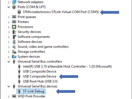

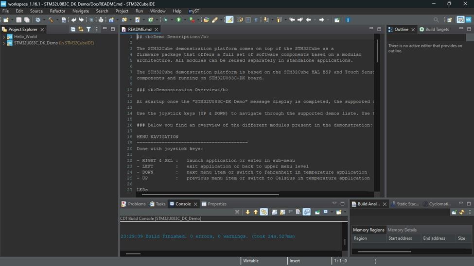

Part IV - Software Installation:
NOTE:  My laptop is a Windows 11 Pro, 11th Gen Intel(R) Core (TM) i5-1135G7 @ 2.40GHz   2.42 GHz, 16 GB
Things are getting better having sorted through more documentation, so I’m feeling better and can see a light at the end of the tunnel.  I started by installing STMCubeIDE, using the default settings, without an issue.  My PC found the board through the Device manager.
Using the demo code found in the previous mentioned .zip file, I was able to successfully build the code and install it.

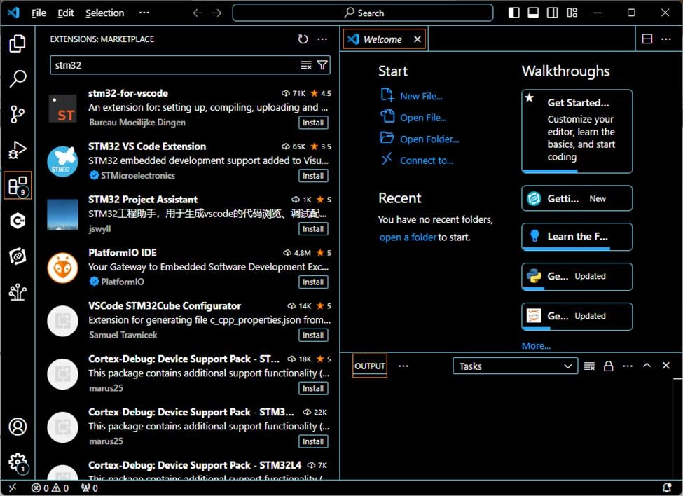

Now that I’m feeling a little more confident, let's see what I can pull up with MS Visual Code.
Now I’m really curious!
