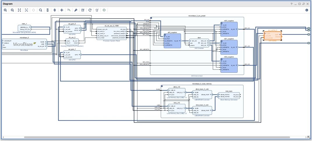

6.2     Microblaze Core
The Spartan-7 and Vivado come with IP from which you can build your own customisable microcontroller - how fantastic is that ! You can choose all the internal parts you want - if you need 16x SPI controllers and nothing else...then just drag them in [assuming there is enough resource in your FPGA]. You can configure the entire inside of your own microcontroller image and most of that is achieved by one autocomplete command.

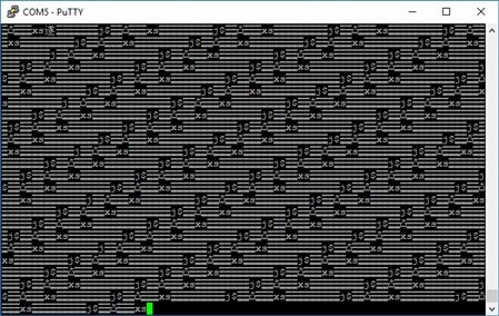

I found what I thought was a good tutorial to guide me through making my first SoftCore processor on an FPGA here and from that was able to build the design into the FPGA as below:
The tutorial flowed well and I was able to complete the Microblaze SoC design but I then ran into many issues getting the SoC's C code to compile - and a more detailed and correct tutorial would have been really fantastic....
The next day I ran through another online tutorial here. As before I was able to make the Soft SoC Microblaze core and then moved across to the Xilinx Software Development Kit (XSDK) to write some code. The simple C example I initially picked was the AXI GPIO driver, the code for which is shown further down - compilation of that C source code went well and it almost worked as expected. The C code would read the four push buttons and would light all the LEDs if any button is pressed - that part worked well. It was also meant to output the switch value to the UART which appeared garbled when viewed using PuTTY even though the correct serial settings were being used. Below is a schematic of the IP blocks used in the Microblaze core when I got it working - which I think looks awesome - along with the PuTTY screen.image
This is the simple C code example running on the Microblaze Core as provided in that tutorial:

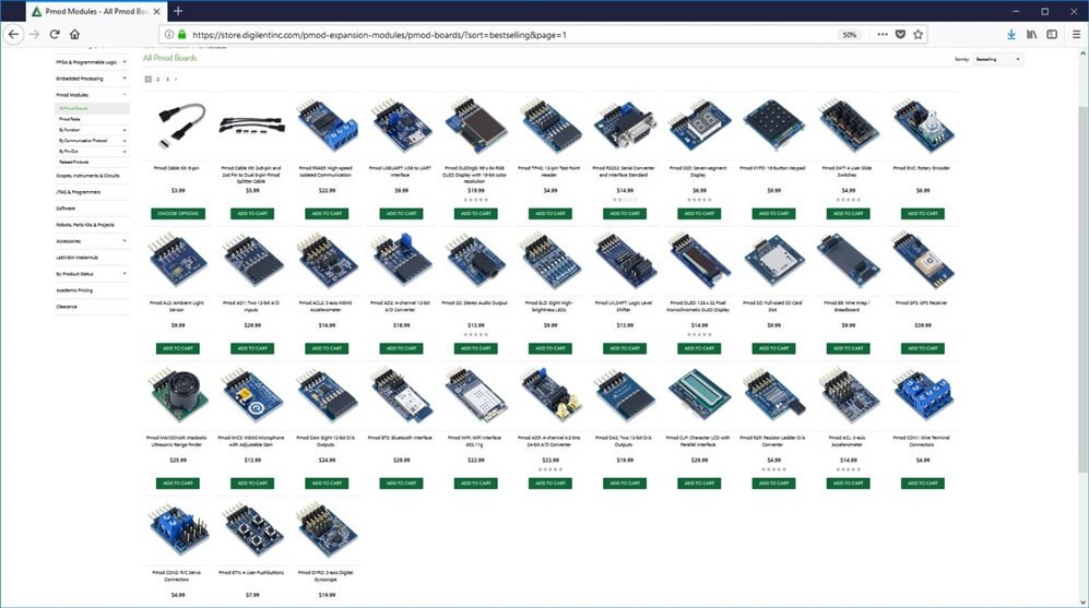

7.1     PMod
PMods are similar to the Arduino shields and there is a huge range available, most prices are reasonable and equally priced to comparable Arduino shields. I didn't get around to purchasing one for the Roadtest, although I will in the future to further my HDL learning using the board. The PMod VGA adapter looks like a great first contender: I note that the other current FPGA Roadtest board from Digilent has VGA functionality built in. There are seven current PMod standard interfaces including SPI, I2C, UART and GPIO. These are detailed in a Digilent document and so will enable users to build their own addon boards for the Arty S7 - although the range below looks quite extensive already. Many of the boards use a single 6-pin header to connect to the Arty board but some utilise a dual row header (12 pins).
I would recommend that anyone purchasing a Digilent Arty board for learning and tinkering/making should invest in a few PMod so they can try out some ideas and make better progress.
I've included a screen shot from the Digilent store that lists some of the PMod range (one of three pages). It also seems that the PMod standard is utilised by other manufacturers like Analog Devices - this is a great way of adding even greater flexibility and power to this Spartan-7 board.image
