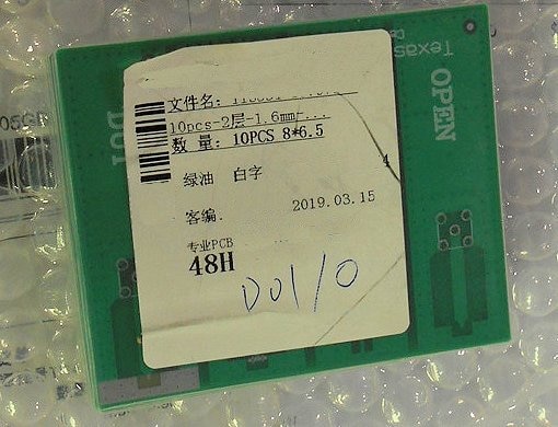

Low-cost Calibration Method
Although this will not be anywhere near as accurate as the methods mentioned above, for basic testing, a home-made Open/Short/Load can be used. One method is to obtain connectors, and trim off the end and then attach either a short (e.g. copper sheet) or a load (e.g. a couple of 100 ohm resistors connected electrically in parallel).
Alternatively, at one point Texas Instruments offered an Antenna Design Kit with code CC-Antenna-DK however it is no longer available for sale. The kit included a printed circuit board version of an open/short/load with SMA connectors. Since the Gerber files are still available, it could be possible to get the PCB manufactured and build that up.
I edited the Gerber file, to remove the antennas, and it is attached below, ready for sending off to a PCB manufacturer.

  • The CC-Antenna-DK derived OSL (Open/Short/Load) board: (I used Elecrow):
  • It seems they have gone up in price, also at the TI store. Maybe there was a temporary action when I ordered them - can't remember.
    If it is only the three calibration boards you need, I can break them off and mail them to you for the cost of the shipping from Belgium.
