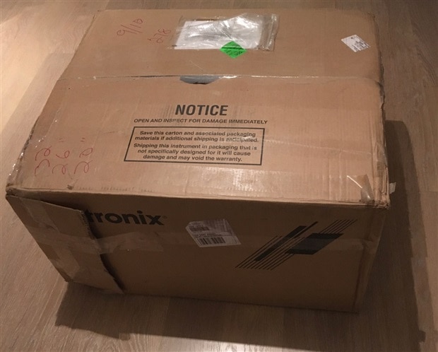

A rather large box was delivered by UPS, so I was a bit afraid to find something in there like:
But luckily that was not the case:
A large piece of packing material and a beauty of an oscilloscope.

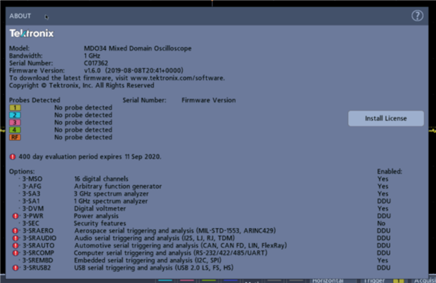

Talking about software options, next to the software options offered in the roadtest review, a 400 days demo license for all other options was also installed.
About box before:
and after registration:

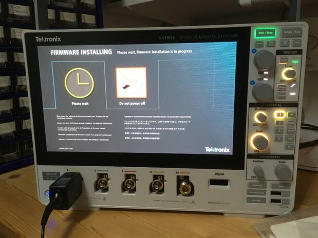

The supplied documentation suggests me as a first step to check the firmware and update if needed. The installed version was indeed outdated, so I immediately upgraded to firmware version 1.6.0. This process went smoothly:
| {gallery} Firmware upgrade |

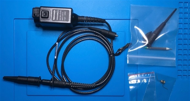

The scope comes with four standard passive probes (part number TPP0500B). The probes are rated at 500 MHz with fixed 10:1 attenuation. Maximum voltage rating is 300V (CAT II), 3.9/10Mohm. Included are:
The quality is comparable to the Tektronix TPP0201 probes I reviewed earlier(Tektronix TBS1202B-EDU Oscilloscope - Review ) and in my opinion much better than the PicoScope probes (PICOSCOPE 5444D MSO - USB Oscilloscope - Review ). The BNC connector is different from the TPP0201, as these probes are uniquely identified using a pin connection on the probe. This way the scope knows which probe is connected, and stores the compensation values for each probe/channel combination and automatically recalls the compensation values when you plug in the probe again. Probe compensation status is shown in the Probe Setup panel of the Channel configuration menu.
The probe compensation is done via an automatic procedure from the scope rather than by adjusting it with a screwdriver, as can be seen in the screenshot below:
BTW, I'm curious how this probe identification is implemented, is it just a stored serial number? Which protocol is used? As there is just one pin, I expect something like the 1-wire protocol. If you know more about this, or did a tear-down of a scope and/or probe, please let me know.

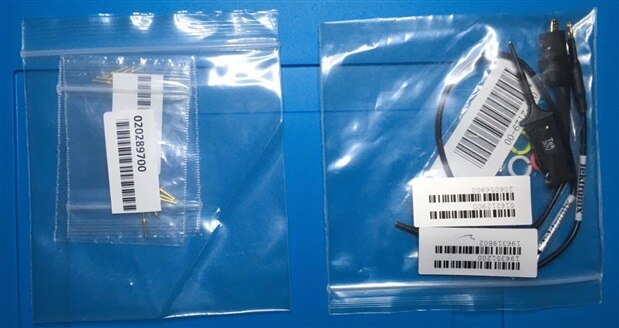

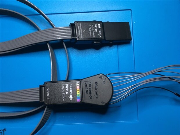

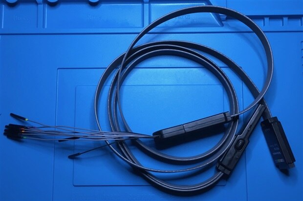

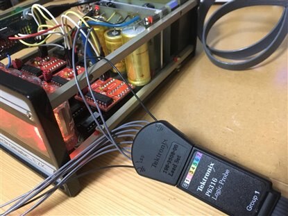

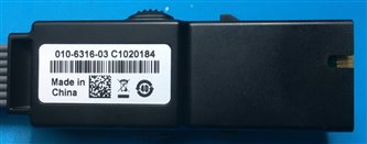

The probe socket is positioned deep inside the housing. The probe connector can firmly be connected, using a locking mechanism. The connector breaks out 16 data channels over two 80 cm cables, ending in 2x8 pin headers. The pin headers can be connected to interchangeable flying leeds with a ground connection on each end and eight signal lines in between.
Also a set of micro hook tips and pins are supplied for each of the headers, making it a very versatile probe set.

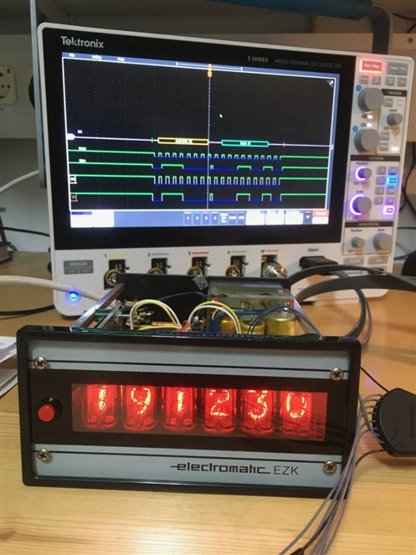

The MDO34 is a very versatile scope, has many functions and as such is equipped with digital inputs that I personally am very happy with. Whether you see this as an advantage or not is somewhat a personal choice: you may want to have a separate stand-alone digital analyzer, or you want it built into your oscilloscope. Colin O'Flynn opts for a stand-alone digital logic analyzer, because digital logic analyzers are available at a relatively low price from different manufacturers. In his experience, the cost of purchasing a separate PC-based logic analyzer is considerably lower than the "incremental costs" of selecting an oscilloscope with logic analyzer capabilities compared to one without. That may be a good consideration given the high cost of digital input options for the MDO34:
Option |
Description |
Price |
| 3-MSO | Tektronix 3-MSO *Internal Option* Adds 16 Digital Channels, Including P6316 Digital Probe and Accessories, to 3 Series MDO Unit | €1,620.00 |
| 3-SRAERO | Tektronix 3-SRAERO *Internal Option* Adds Aerospace Serial Triggering and Analysis (MIL-STD-1553 and ARINC 429) to 3 Series MDO Unit | €1,250.00 |
| 3-SRAUDIO | Tektronix 3-SRAUDIO *Internal Option* Adds Audio Serial Triggering and Analysis (I2S, LJ, RJ, and TDM) to 3 Series MDO Unit | €1,250.00 |
| 3-SRAUTO | Tektronix 3-SRAUTO *Internal Option* Adds Automotive Serial Triggering and Analysis (CAN, CAN FD, LIN, and FlexRay) to 3 Series MDO Unit | €1,250.00 |
| 3-SRCOMP | Tektronix 3-SRCOMP *Internal Option* Adds Computer Serial Triggering and Analysis (RS-232/422/485/UART) to 3 Series MDO Unit | €1,250.00 |
| 3-SREMBD | Tektronix 3-SREMBD *Internal Option* Adds Embedded Serial Triggering and Analysis (I2C and SPI) to 3 Series MDO Unit | €1,250.00 |
| 3-SRUSB2 | Tektronix 3-SRUSB2 *Internal Option* Adds USB Serial Triggering and Analysis (USB 2.0 LS, FS, and HS) to 3 Series MDO Unit | €1,250.00 |
| 3-BND | Option 3-BND - Application Bundle; Bundle for 3 Series MDO (Includes 3-SRAERO, 3 SRAUDIO, 3-SRAUTO, 3-SRCOMP, 3-SREMBD, 3-PWR, 3-SRUSB2) | €3,380.00 |
(*) prices are in euros and based on https://www.tek.com/tekstore/configure/MDO34.

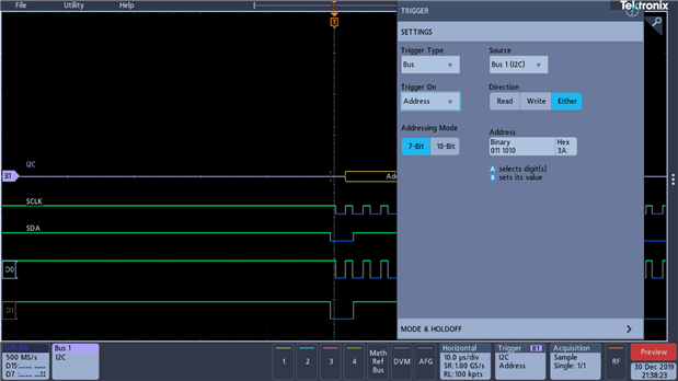

The 3-MSO option enables the digital input hardware and includes the digital probes, the other (software) options are for decoding serial protocols for specific applications. It is not expected that all of them are needed by a single user, but to me 3-SRCOMP and 3-SREMB are quite basic. All in all it is costly to add digital input and some protocol analysis to the scope. Compare to the PicoScope 5444D with a price difference of $250 between plain and MSO version it is way more expensive.
Furthermore the PicoScope can standard decode: 1-Wire, ARINC 429, CAN, CAN FD, DCC, DMX512, Ethernet 10BASE-T, Fast Ethernet 100BASE-TX FlexRay, I2C, I2S, LIN, Modbus ASCII, Modbus RTU, PS/2, SENT Fast, SENT Slow, SPI, UART (RS-232 and RS-422, RS-485) USB, without additional costs.

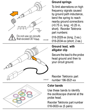

Would be great to check the -3dB points using a signal generator, as I did in my Tektronix TBS1202B-EDU Oscilloscope - Review, but unfortunately I don't have a calibrated signal generator going up in frequency that high, therefore I just had a look to a 145 and 430 MHz signal from a hand held radio.
I made a pickup loop by connecting the ground clip of the probe to the tip, and put that over the antenna:
Resulting in the following signals:
Proving that the scope (and probe) are capable of measuring signals up to ~ 500 MHz.

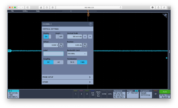

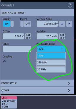

Although the scope is rated at 1GHz bandwidth, this is only the case for a 50 ohm input. When using the high impedance input the bandwidth is 500 MHz. This also explains the 500 MHz bandwidth of the attached probes.
For 50 ohm the coupling is fixed at DC, where for 1 Mohm also AC can be selected.
There also is the option to limit the bandwidth if a lower bandwidth is sufficient. Lower bandwidth limits noise and can provide a cleaner view of the signal.

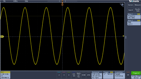

To demonstrate the different bandwidths for 50 and 1M ohm input termination, I connected a 3 GHz noise source to channel 3 using 50 ohm termination ( 1 GHz bandwidth) while at the same time, using a pick-up coil, the same signal on channel 1 using 1 Mohm termination (500 MHz bandwidth) was measured. On both channels a measure badge was placed, showing the statistics of the measured frequency.
As can be seen the mean (u) and max (M) frequencies of the signal are larger for channel 3, proving the larger bandwidth of this 50 ohm terminated channel.

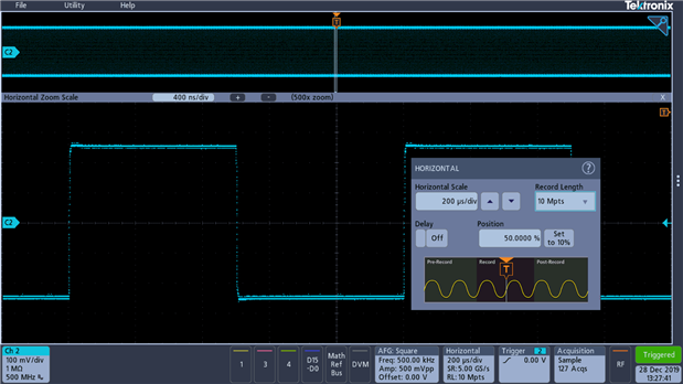

The maximum sample rate of the MDO34 is 5 GS/s when using 2 channels, or 2.5 GS/s when using 3 or 4 channels. 5 GHz comes down to one sample per 200 ps (picoseconds). To demonstrate this I connected a RF noise source, with a bandwidth of 3 GHz. Compared to the PicoScope 5444D the nice thing of this scope is the 50 ohm input. So the output of the noise generator could be directly connected to a scope input. For safety I put a 10dB attenuator in between.
The shortest horizontal scale is 400 ps/div, which at a sample rate of 5 GHz amounts to two samples per division.

From the horizontal menu you can play with different record lengths. As input I used a 500 kHz square wave and used the zoom function so that the full recorded signal is displayed in the upper part of the screen. Samples are displayed as points rather than vectors, in order to demonstrate the sample interval.
| {gallery} 50 kHz square wave at different record lengths |
What stands out is that when switching from 1 kpoints to 10 kpoints, the sample rate automatically increased tenfold from 50 - 500 Gs/s, the same when switching from 10 kpoints to 100 kpoints, where the max sample rate of 5 Gs/s is reached. During these steps the total time captured is the same, but more points are captured. When the record length is increased further, the total captured time is increased as can be seen in the upper graph. When doing the same steps in reversed order this is not the case, and the total recorded time span remains the same.
I'm not sure whether this is a bug or a feature?

For emote control operation The MDO34 is equipped with a LAN port and an USB port. Available software is Tektronix own solution, 'KickStart Instrument Control' only for Windows PC's and TekVISA and IVI drivers for use with general purpose software like LabView and MATLAB. I'm not completely sure whether this also works on macOS and it's not part of my roadtest plan to test this.
However, the LAN connection provides some very interesting functions. The first one I would like to mention is the possibility to mount an external file server for storing screenshots and data. I have a small file server in my home network, just a USB stick on my home router, which I connect to the scope. This file server is also connected to my laptop. In this way the scope data can be transferred to my laptop very easily. This is a major improvement compared to exchanging data by swapping the usb stick in and out of the scope and laptop.
Another nice option is remote connection to the internal web browser in the scope. When pointing your browser to the scopes IP address you will see the scopes home page:
Then by selecting Instrument Control, you will get the scopes screen in the browser, from which you can control the scope.
Unfortunately only the mouse can be used as input device. The keyboard doesn't work. I hope this functionality will be implemented in the near future.
Also the screen resolution is less than on the scope itself, including the saved screenshots:

Like in my PICOSCOPE 5444D MSO - USB Oscilloscope - Review, I tested serial protocol decoding on one of my latest project, where I2C is used to program a couple of PCF8574AN, 8 bit I2C I/O extenders, connected to BCD drivers for displaying numbers on nixie tubes ([Upcycle It] Nixie Display - Index).
The MDO34 digital probe easily connects to the pin headers on the board:
The Bus configuration menu is used to define a bus from which to acquire, decode, and display data, by tapping the Add Math Ref Bus button on the Settings bar and then tap Bus to add a Bus badge to the Settings bar and add a bus waveform to the screen.
A very nice feature is the possibility to trigger on the I2C data or address byte.
The example below shows triggering on the three different addresses (38,39 and 3A) used for the three I/O extenders in the nixie display.
| {gallery} I2C triggering on different addresses |
Select Address trigger |
Address 38 |
Address 39 |
Address 3A |
In the video below the trigger fires on '00' in the data field, which is when the clock reaches 00 seconds:
For me this address and data trigger option is a very handy feature, which is not available on the PicoScope 5444D.
It is currently common for high-end oscilloscopes to be manufactured with all necessary hardware for high-end use, but this hardware is shielded with software, so that software keys must be purchased for various options. It is much cheaper for a manufacturer to manufacture osciloscopes in this way, because they only need to set up one production line. The customer then determines what he ultimately needs and pays for it. I’ve already mentioned it a few times in passing, but you should always check to see what features are actually included in the offered price quote. With the MDO34 it is no different. The base price of the MDO34 is already quite high as mentioned on the roadtest description (MDO34-1000MDO34-1000). I was surprised to find out about the prices of the features.
Depending on whether you need a scope with two or four channels, you can configure your options at https://www.tek.com/tekstore/configure/MDO32 and https://www.tek.com/tekstore/configure/MDO34. I have made an overview based on the 4-channel version, which can be found in the table below.
For the 2-channel version, prices for the base unit are around 20% cheaper than for the 4-channel version.
