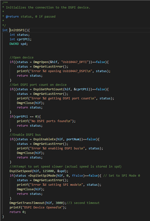

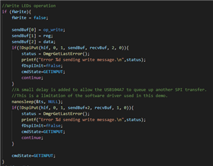

So, you have some form of processor in your PC/104 stack and you now have a shiny new Xilinx FPGA. There's not much point if you can't communicate between them, is there? Luckily one of the example Digilent provide is their USB104 DSPI Demo. I've always found that Digilent provide good documentation and support for their products and it seems the USB104 A7 is no exception. This page give you links to a Vivado project for you hardware design, a Vitis project for your MicroBlaze-based software and also a C project (Windows only) to demonstrate the PC side of the communication. I'll run through this from the top down.
The C demo app that Digilent provide appears to be Windows only. This wasn't a problem for me, but I thought I'd mention it in case any readers are in the Linux-only camp. The Adept libraries on which it relies are cross-platform so I suspect it wouldn't be a huge leap to port this to Linux if you're happy writing C and can call a few libraries. I didn't try though. The C code is well presented and documented. and the instructions for getting up and running are good. I was a bit surprised that I had to install Digilent's Adept software (and reboot) before it would work, but considering that the Adept libraries that are used for communication to the FPGA that's reasonable. The build of the C source code failed on my machine - simply because I didn't have gcc installed. As there was a prebuilt executable included I didn't go to the trouble of installing gcc just to build from source. I'm sure it would have worked.
Looking through the code it's clear and understandable. It does use prebuilt Digilent DLLs under the hood for communication. These libraries are closed source and seem fairly old - supporting devices back to the Coolrunner II CPLDs and I found copyright messages in the header files going back over a decade. I suspect this code speaks directly to the USB104 A7's onboard Digilent JTAG adapter. Looking through the well-documented sample code it appear to set up SPI communication at 125kHz. This, and the fact that the code is peppered with 1ms delays makes me think it's not designed for high speed data transfer.
To be honest, well documented stable code is probably what you need rather than high throughput. I suspect that the most common customer use case would be to hand off some critical processing to the FPGA and only be concerned with the data from this process. Here you can see some snippets of the code to initialise the DSPI layer and to write data to the "registers" defined on the FPGA side.
