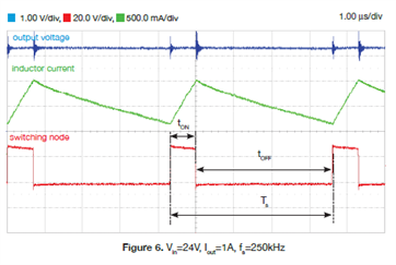

There's a methodology to the way you're guided through the labs. I'll show a few highlights of experiment 2: Impact of passive devices and switching frequency on current and voltage ripples.

You get an explanation of the purpose of the tests, case study and a theory refresher (click the images to enlarge).
This sets the scene. If you are in a power circuit design course (or followed one that covers Buck converters), this won't be new for you.
If your knowledge level doesn't cover these topics, I (really - it's excellent) advice this online course: Power Electronics Specialization.
The experiments in this kit are a good match of what that curriculum covers on Buck regulators.
The theory related to the current exercise is briefly recapped in the book though, and all equations needed to perform calculations are given.
